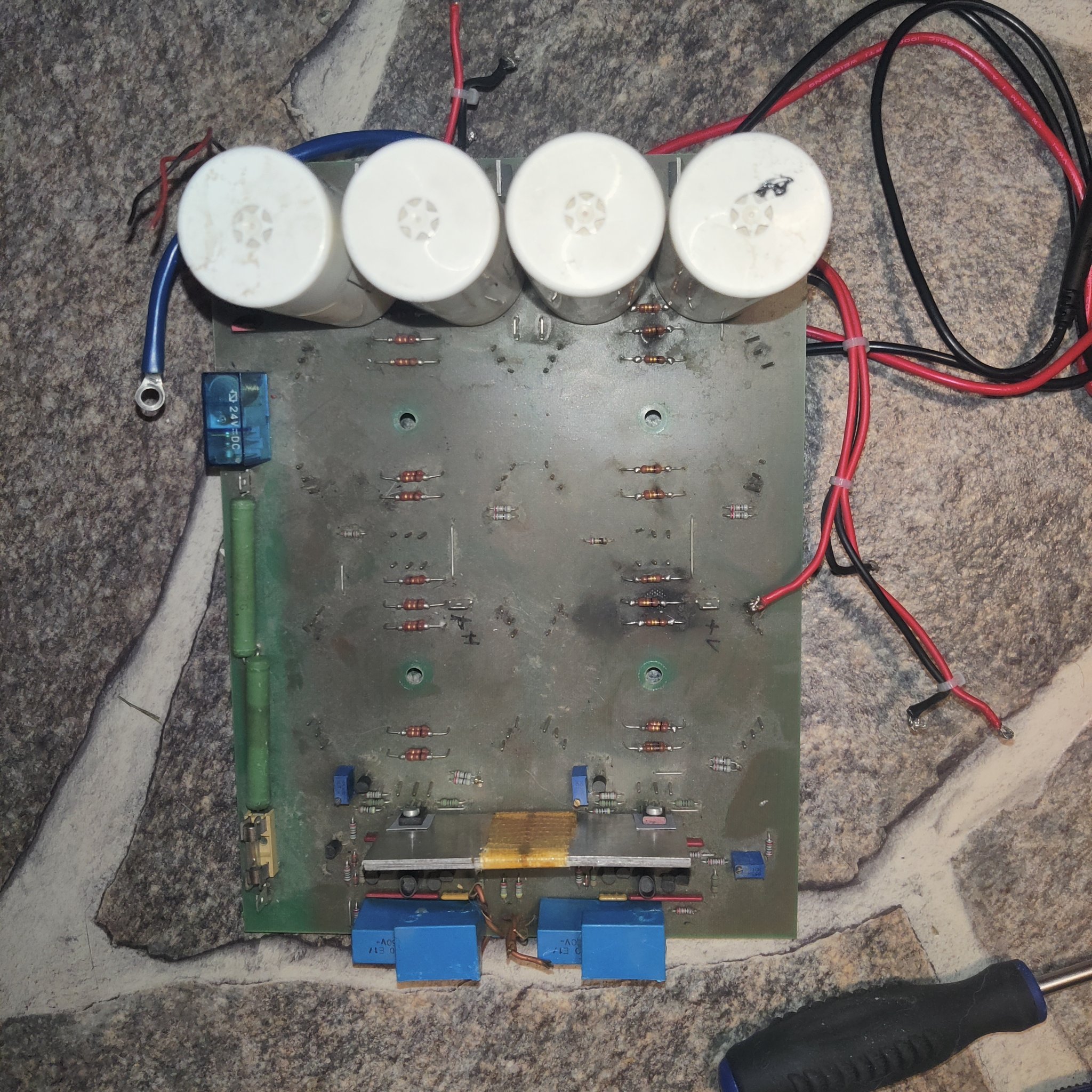

After i started to repair vintage amps and building some diy amp projects , both tube and solid state. i have started getting a big interest in different types of amplifier designs,
A week ago i got my hands on a norwegian made amplifier that was in a need of repair, a Doxa Signature MK1 . and i saw right away that this amp had a unusual design, after some searching i found out this type of design is called Rush Cascode and no tail pair.
I have searched to find more power amps with similar design but i have not found something similar
So, have any of you guys seen a similar design , diy or commercial built?
i add the schematic i found online to this post , its not 100% correct but most the essential parts is correct.
i will reverse engineer it and make a complete and correct design at a later time if there is interest.

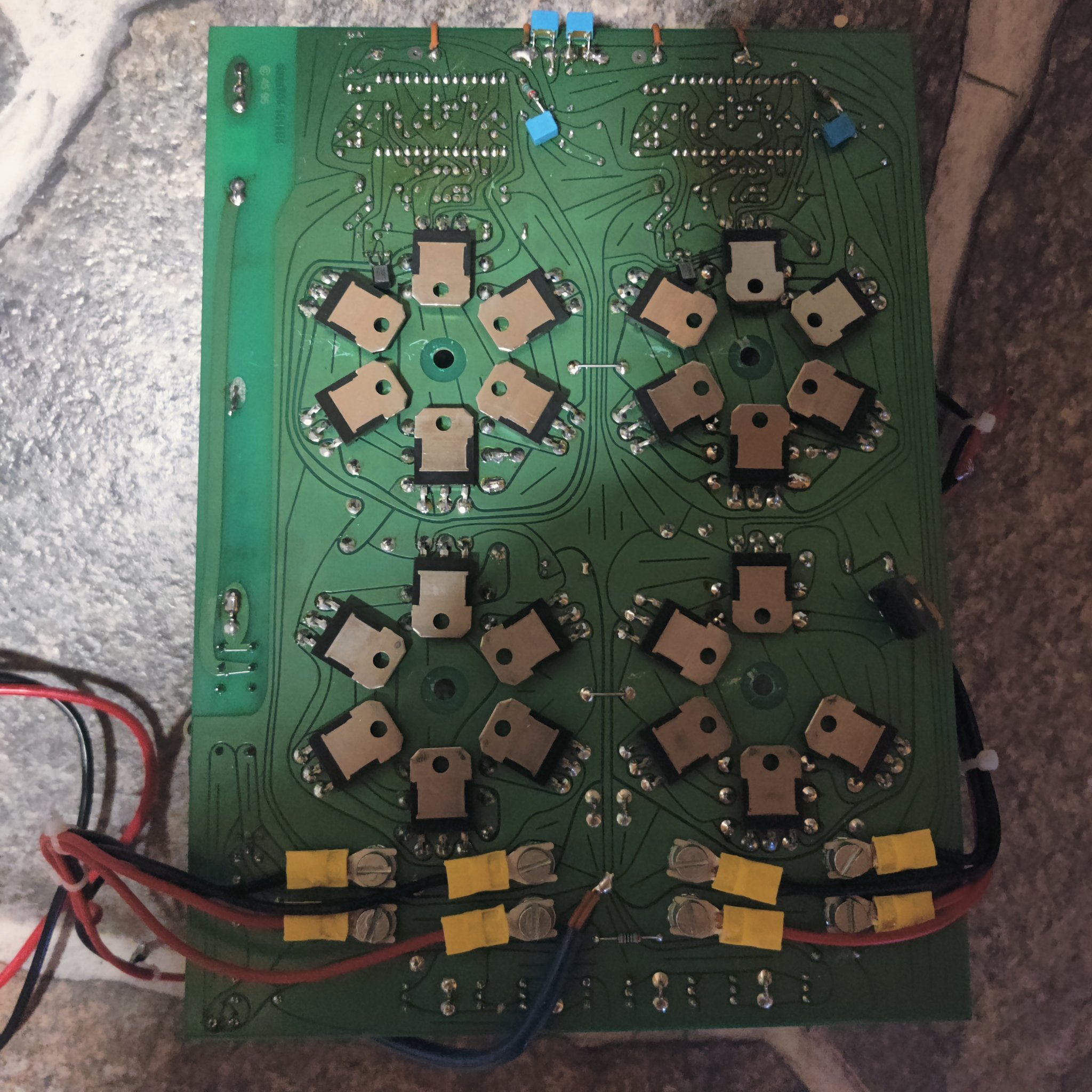

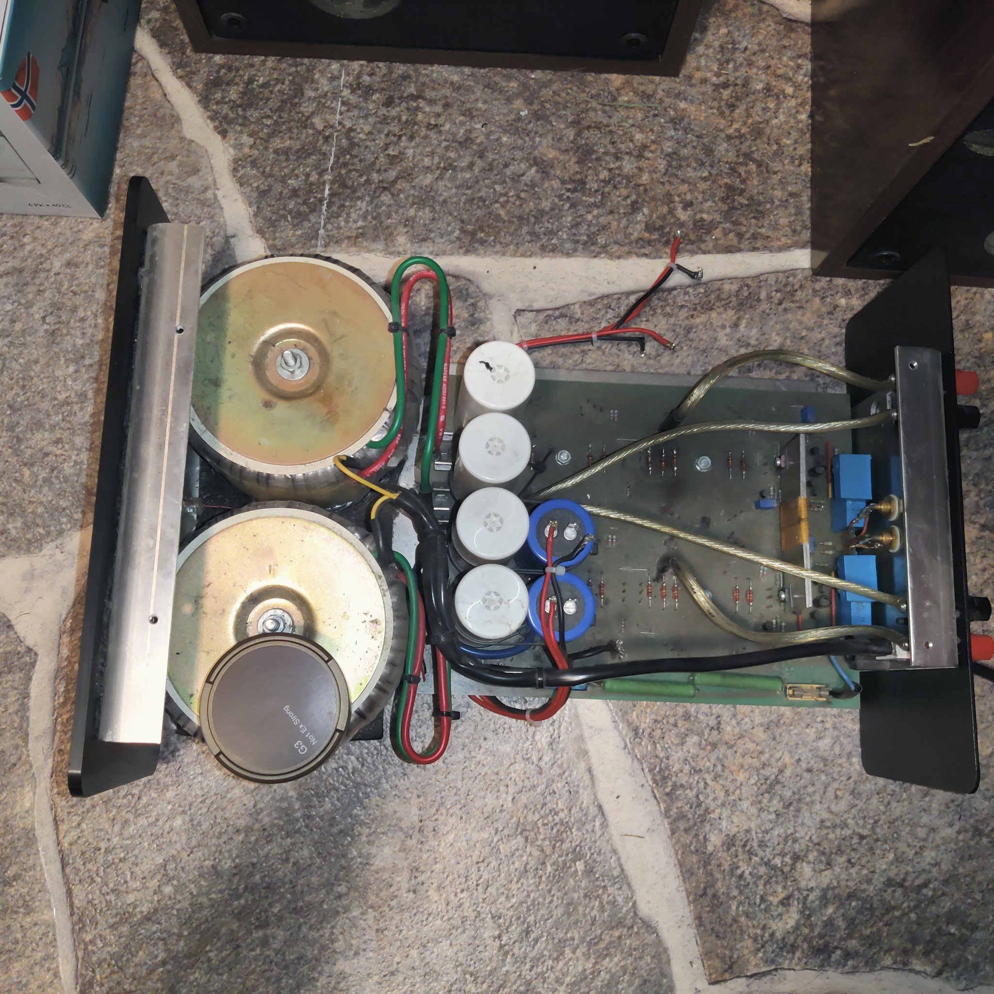

Like i wrote in the beginning, the scematic is not 100% correct, it has alot of things that are not wired correctly , but some of it is correct. This is the amp in real life.
