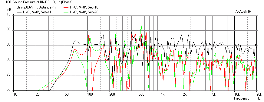

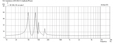

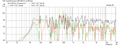

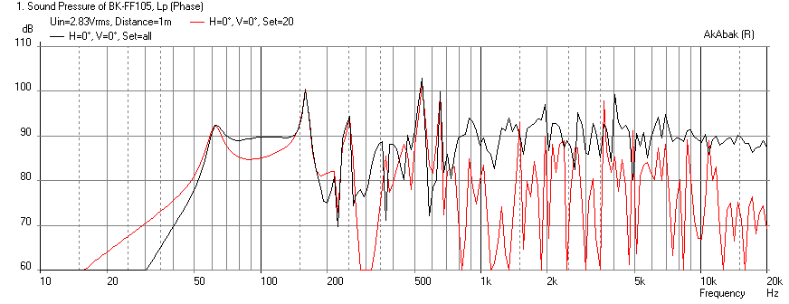

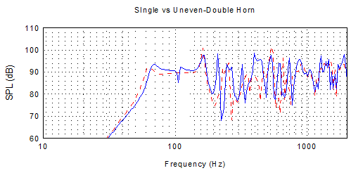

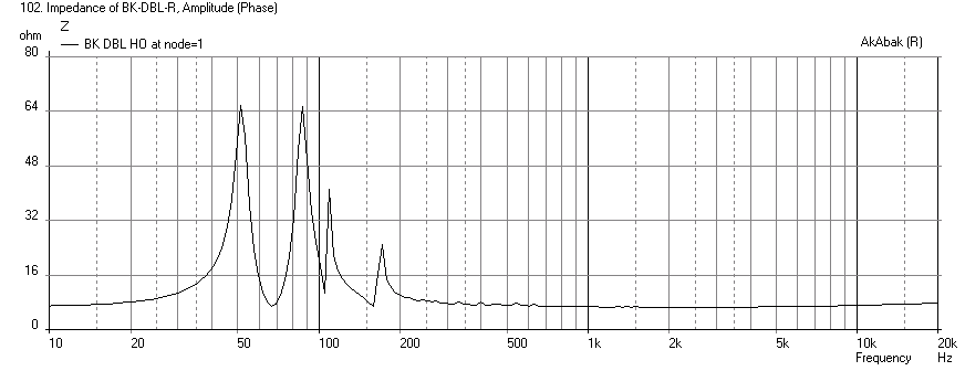

Modeling a Double-Uneven-Length BLH with AkAbak
Ever since I have been working on the Cornu horn with its double uneven length horn segments, I have been curious about how to design one from scratch. The idea is that the two horn lengths will have offset resonances such that the combined output has a smoother frequency response. I wanted to do it using a single driver rather than two separate drivers and two separate horns. This is where it gets tricky because when you combine horns with a single common chamber and throat, there are non-linear interactions. Luckily, AkAbak can handle all of this.
I needed a good design for a single BLH to start with and since I had just modeled the very nice BK12 horn as a rear firing BLH, I decided to start there. I am using the geometry of the horn from the BK12, but modified the driver chamber to a smaller volume to accommodate the FF105WK driver which has more xmax.
The model of the horn has 8 segments (see code section below). The first segment is the throat from the driver chamber and last segment is the mouth opening.

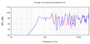

First I doubled up the horn paths splitting them off right after the initial 1 in throat section into two equal paths. After doing this, I ran the sim to see if it matches the original single horn to double check for any errors in setting up the geometry.
Then I went in and slowly started reducing some of the key length segments of the second horn and observed the frequency response. I found that in the two longest segments, by reducing the length of the second horn (segment 2 by 5 inches, and segment 6 by 3 inches), it started to produce some offset overlaps that should help smooth the response.
I also found that if I increased the mouth of the original horn by 1 inch and increased the length of segment 8 (mouth) by 1.5 inches, it helped to balance out the SPL levels between horns 1 and 2 and filled in a rather big dip that was there before.
Anyhow, plotted below are the results: first plot is the original single horn combined driver + horn (black) & horn only (red), second plot is the uneven length double horn with combined (black) & horn 1 (red) horn 2 (green), the cone displacement, the impedance, and a plot of both responses superimposed.
The tradeoff of smoothness is less bass extension.

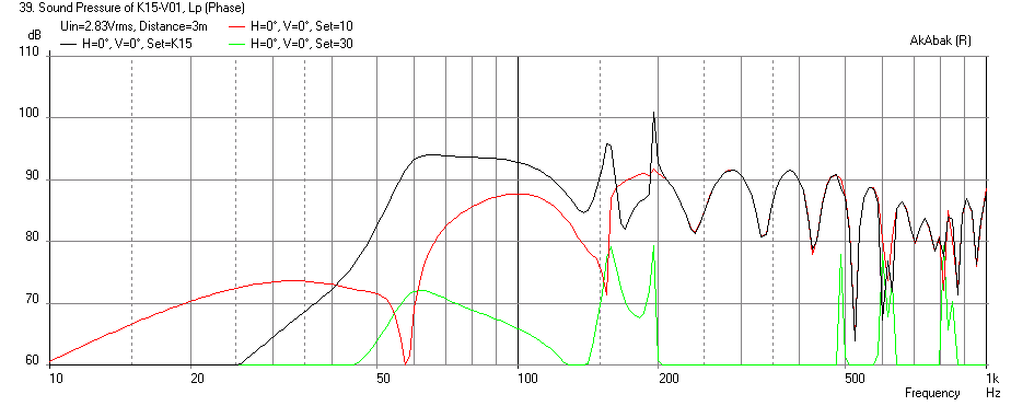

AkAbak sim of Karlson K15
This is the most complex model I have done with AkAbak and from what I am told, it seems to be fairly close to how a real Karlson behaves. One can now scale a Karlson box and see the effect on frequency response.
http://www.diyaudio.com/forums/full-range/213594-karlson-10.html#post3528706
Here is an original 1955 K15 fitted with a Betsy K driver.
