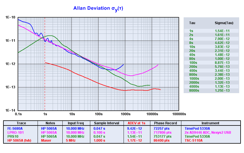

An Rb clock may have amazing long term stability, but for CD playback you are looking for shorter term jitter, and in this they are VERY poor.
Avery well done xtal osc will sound far better.
