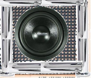

here we go very rough idea of what i mean - tubular chrome support structure and think rubber sheeting bolted to both the frame and the woofer mounting holes.
Might need to support the magnet as well.
What do you think?
i would use the support bolts to tighten the rubber.

Less likely to be sonically problematic than a solid sheet, more likely to be mechanically problematic. If the rubber's stiff enough to hold the driver without magnet support I'd expect a fairly high resonant frequency in the suspension with the driver that close to the frame.
You'd want the suspension frequency to be below the bandwidth of the driver.
To avoid local stress you need to glue the sheeting around the peripherary of
the driver. To keep it simple you could let it self tension, i.e. with the driver
held up and flat and the baffle flat simply glue and staple the sheet in place
with some tension. Then add a rubbber strap to the back of the magnet that
affixes to an adjustable point above the driver to vertically align it.
You will end up with a decoupled driver. Given the arrangement a clamping
ring might be needed to prevent the rubber slowly peeling off the surround,
This could be a chamfered square or ring and driver cutout, with the rubber
glued to the front or back of the square / ring around the cutout and the
driver bolted to the front or rear to hold the rubber in place.
