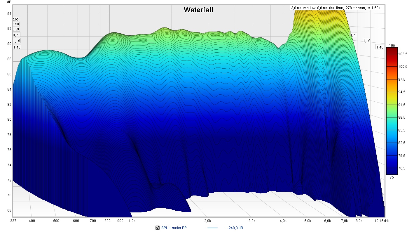

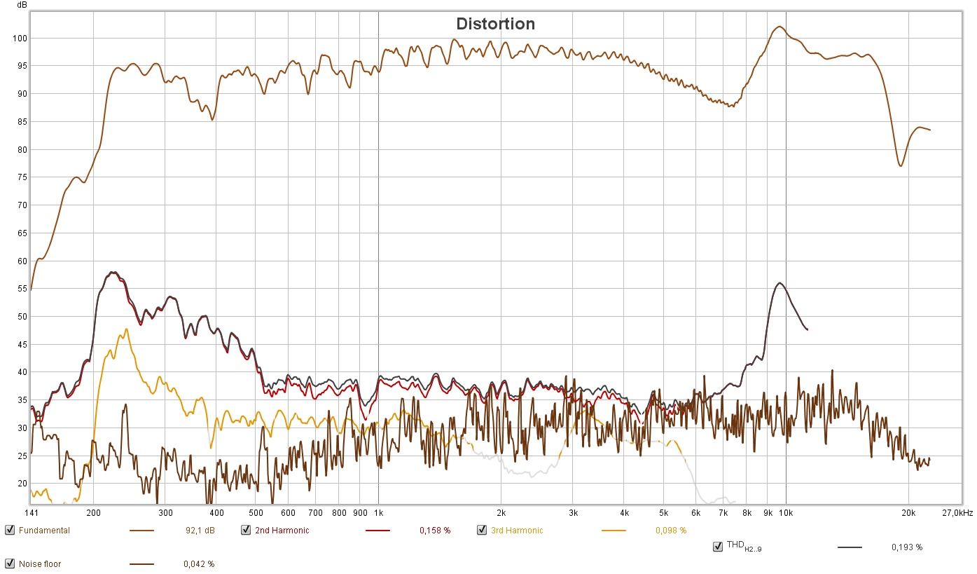

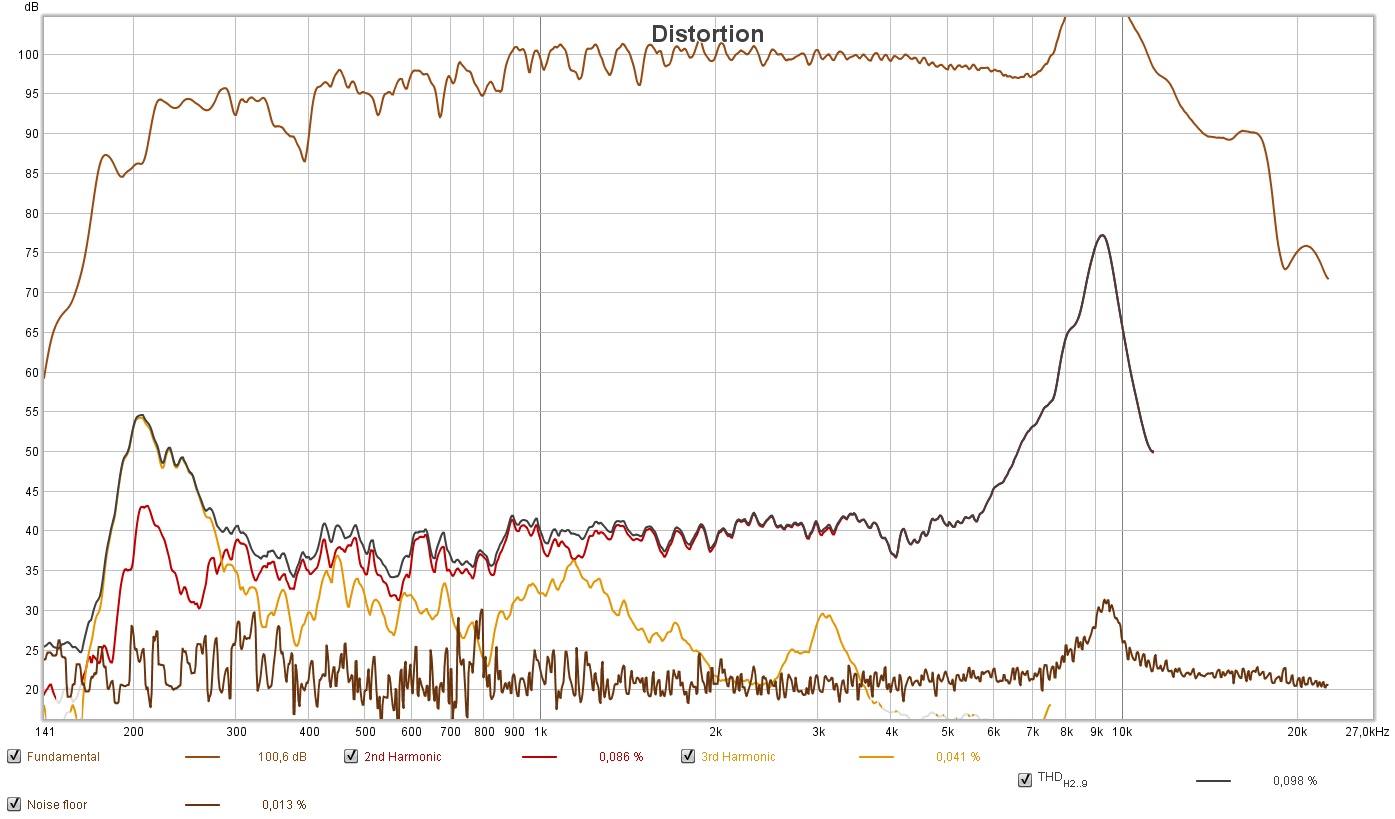

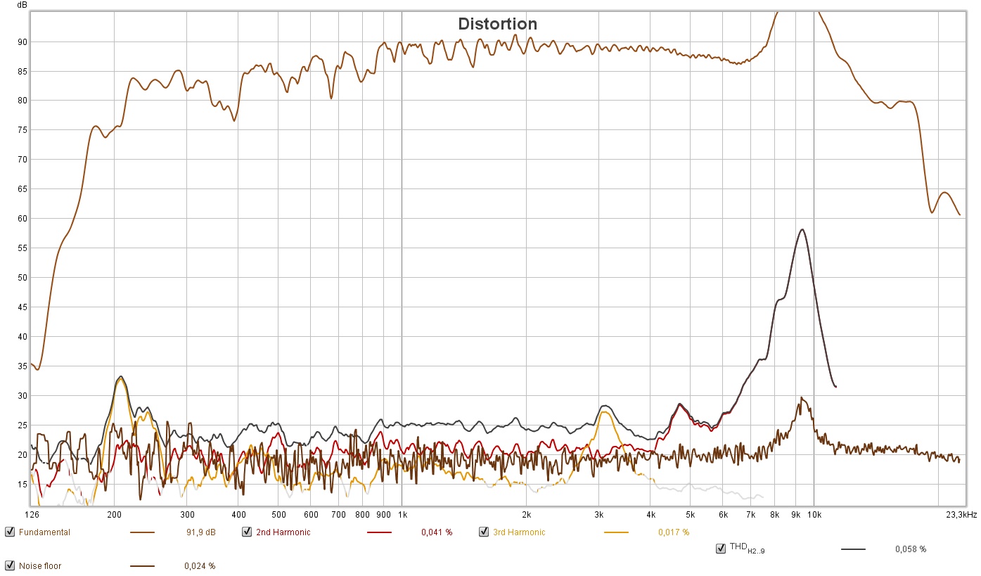

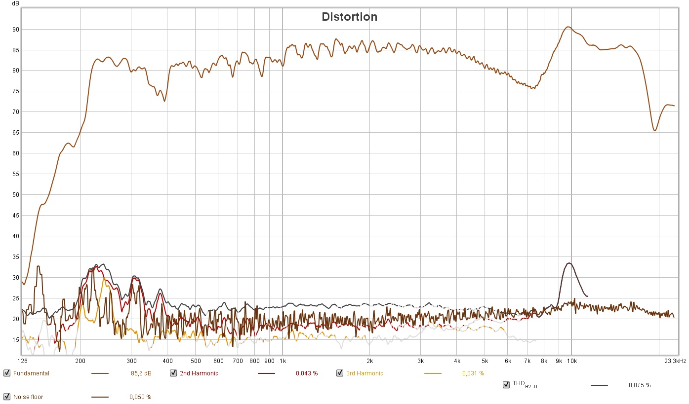

some of the measurements used in the last video
i think a slightly higher tension would be needed, in order to get a smother roll-off at maybe 300 Hz. A higher tension use to be good for higher frequencies too. Just a thought.
