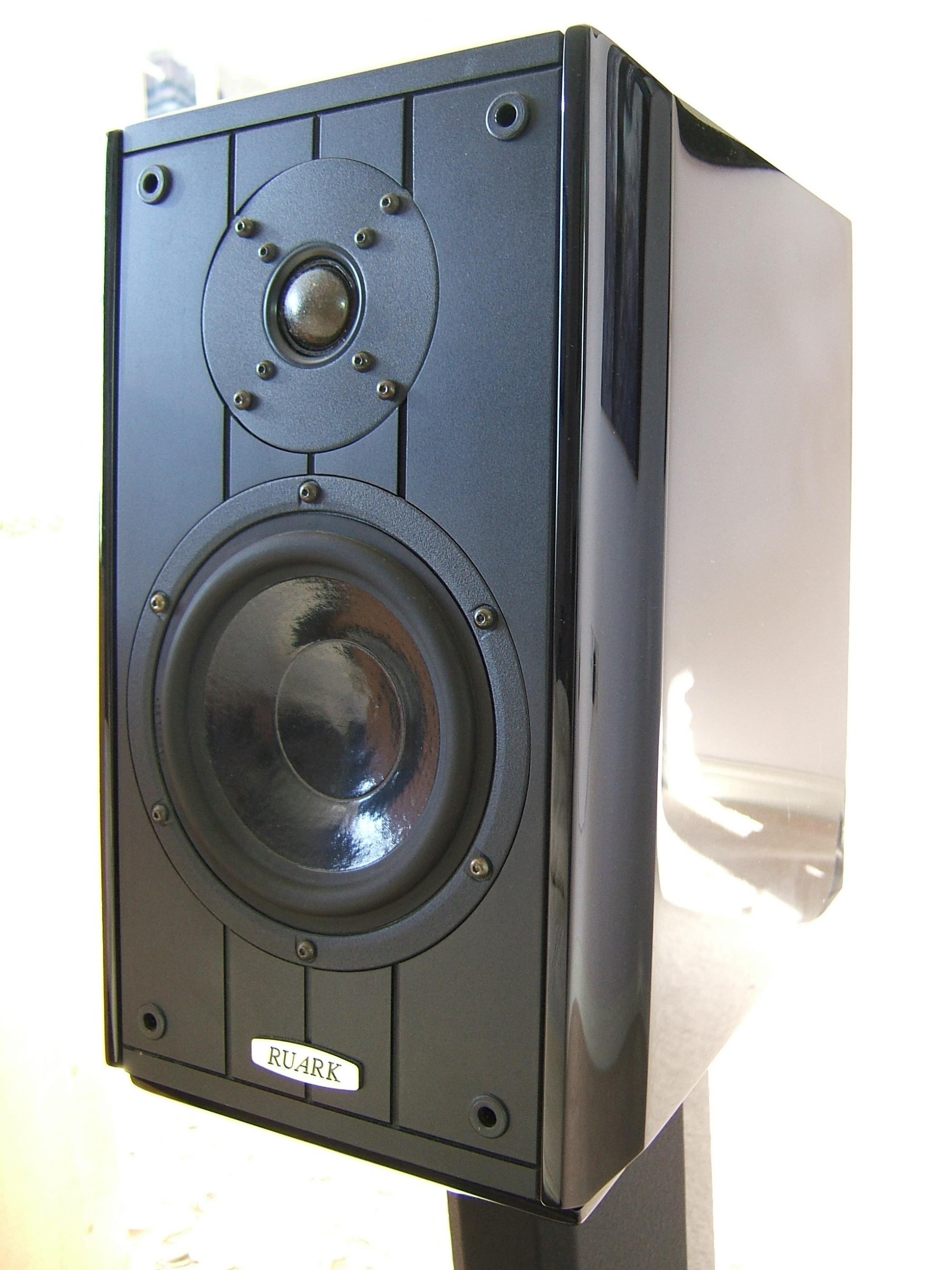

I have recently purchased a pair of Ruark Equinox speakers in piano black. They are fantastic looking speakers but unfortunately, were damaged during transit. I am trying to source a pair of Vifa drivers, model number M18WO-09-06. As one of the units refuses to work. I have contacted Ruark and they have no spares. I suggested to Ruark that I may be able to source the 8 ohm version of this driver (M18WO-09-08), which appears to be more common and they didn't think there would be any issues in using a pair of these in-place of the original units. I have been to all the usual outlets without success for either driver and have pretty much given up. Is there anybody who has or knows somebody who may be willing to part with a pair, or are there any other drivers which will perform the task as well..? 😕 Any advice would be greatly appreciated. Many thanks... D

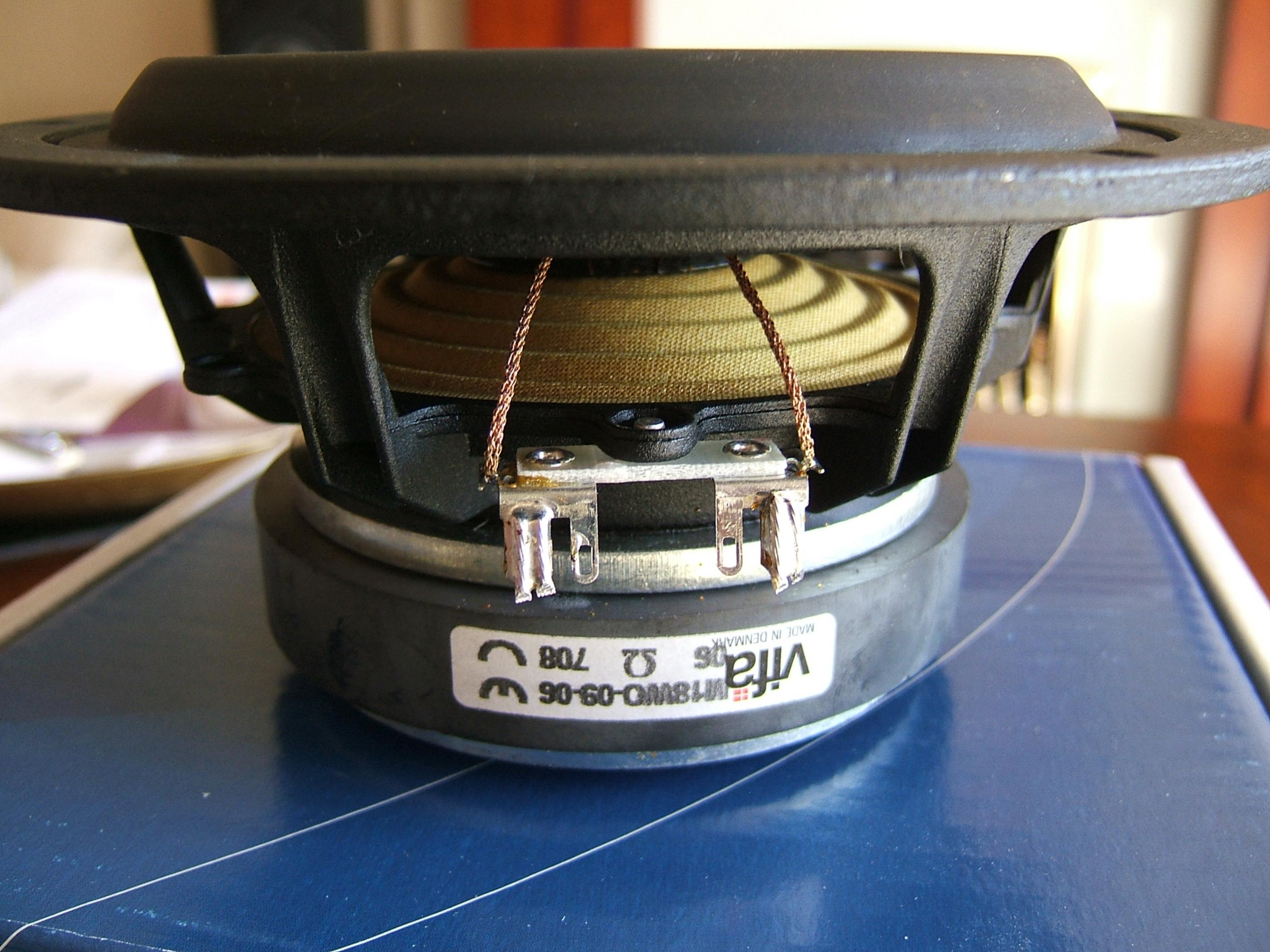

Damski, I take there is no viable damage to the Vifa woofer? and the reson for it not to give out any sound is because there is no connection through the voicecoil? It should meassure about 4-5 ohm with a ohmmeter.
It sounds strange if a voicecoil is damaged in transport....

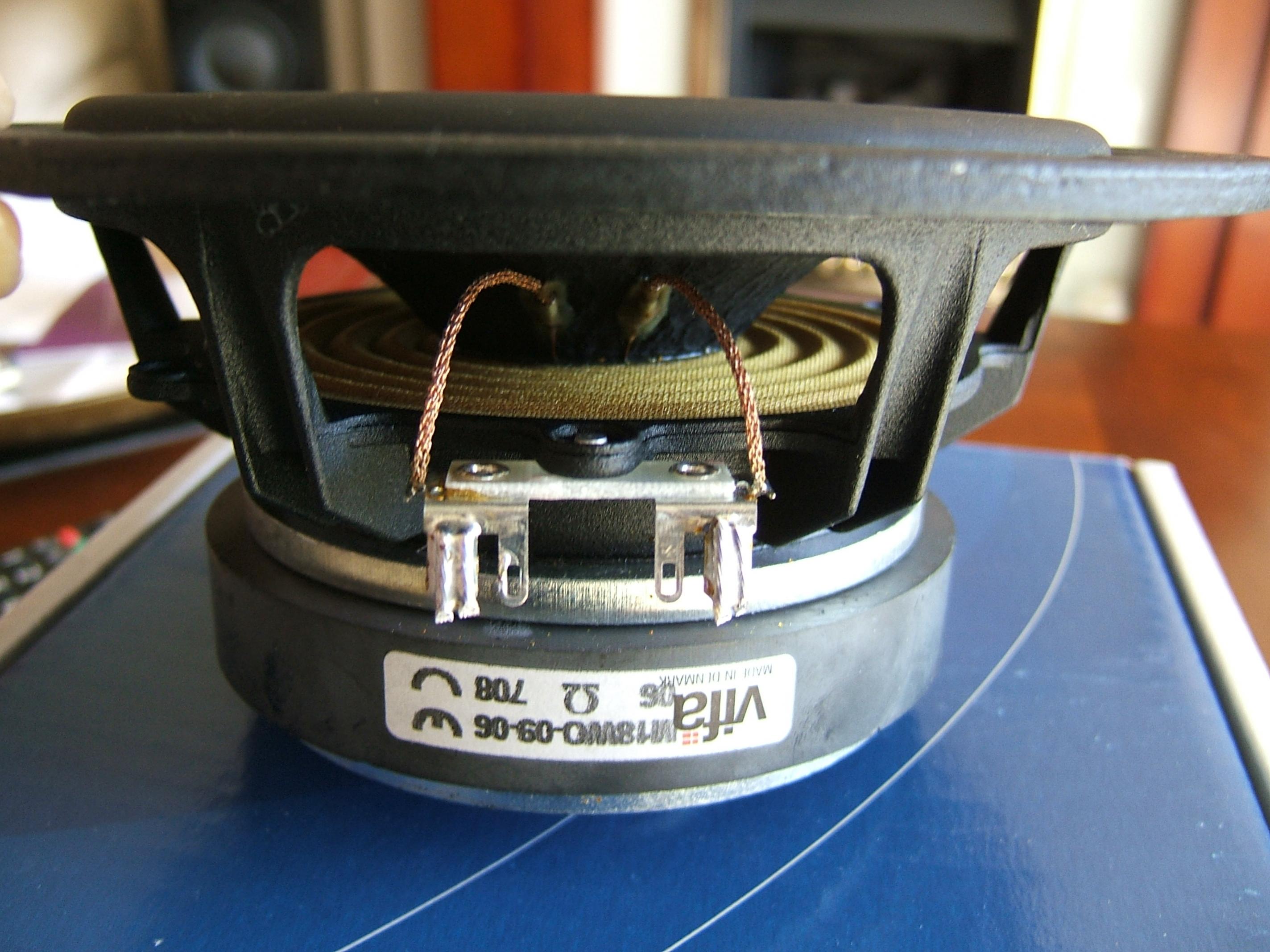

Hi Hylle. When I spoke with Ruark regarding the damage they asked the same question; “was there any visible damage to the Vifa driver?” The answer is no there isn’t and it appears completely intact. They also remarked that it is unusual for a driver to be damaged during transport especially when there were no signs of damage to the cabinet. I had this out with the Seller stating that the damage to the driver may be as a result of system abuse and not physical damage through transit – this of course was denied. I have no way of proving otherwise unless the driver is examined for abuse by somebody who knows what the tell-tale signs are and I suspect this may involve stripping down the driver. I will check the impedance of the unit over the coming weekend and let you know. Thanks… D
Hi Hylle. I have measured the Vifa driver using an ohm meter and it registered 0 ohms. In comparison I measured the new SEAS driver and this returned a reading of 6.1 ohms, suggesting a failed connection in the voicecoil. What’s the most likely cause for a voicecoil to fail..?😕
Hi Damski,
It does not sound so good. Just to be sure you belive the voicecoil is shorted, meaning 0 ohm. I just need to make sure you dont mean no connection in the coil.
I belive the most common failure like this is if the woofer is overdriven, had to much amplifire power, and the voicoul becomes shorted and looking(smelling burned)
I guess there is nothing unusually to see on the litze wires going from the terminals to the cone? they do not touch each other right?
If you move the cone up and down and look at the voicecoil, above the magnetic system, does the voicecoil look black(brown and burned?

With regards to the damaged Vifa driver, the wires attached to the cone are intact with no visible signs of damage. The voicecoil is enclosed in the motor system and cannot be viewed without dismantling the unit. Therefore, I cannot ascertain its condition. I have taken a photograph of this. The thing that I have noticed is when the cone is moved forward (normal direction of travel) it seems to jam as though something was restricting its travel. It even got stuck in this condition and again I have taken photos with the driver in a jammed position and normal position. Clearly there is something wrong with the unit. Any thoughts..? 🙁

No thinking necessary, the woofer is fried/cooked/done/dead/kaput.

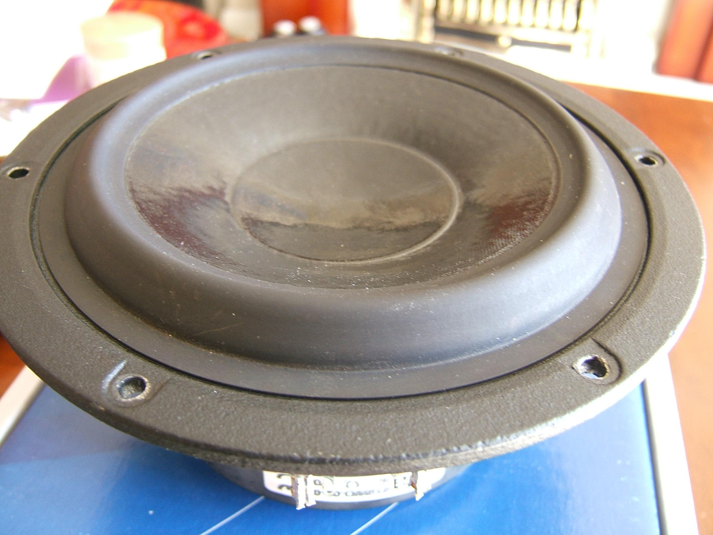

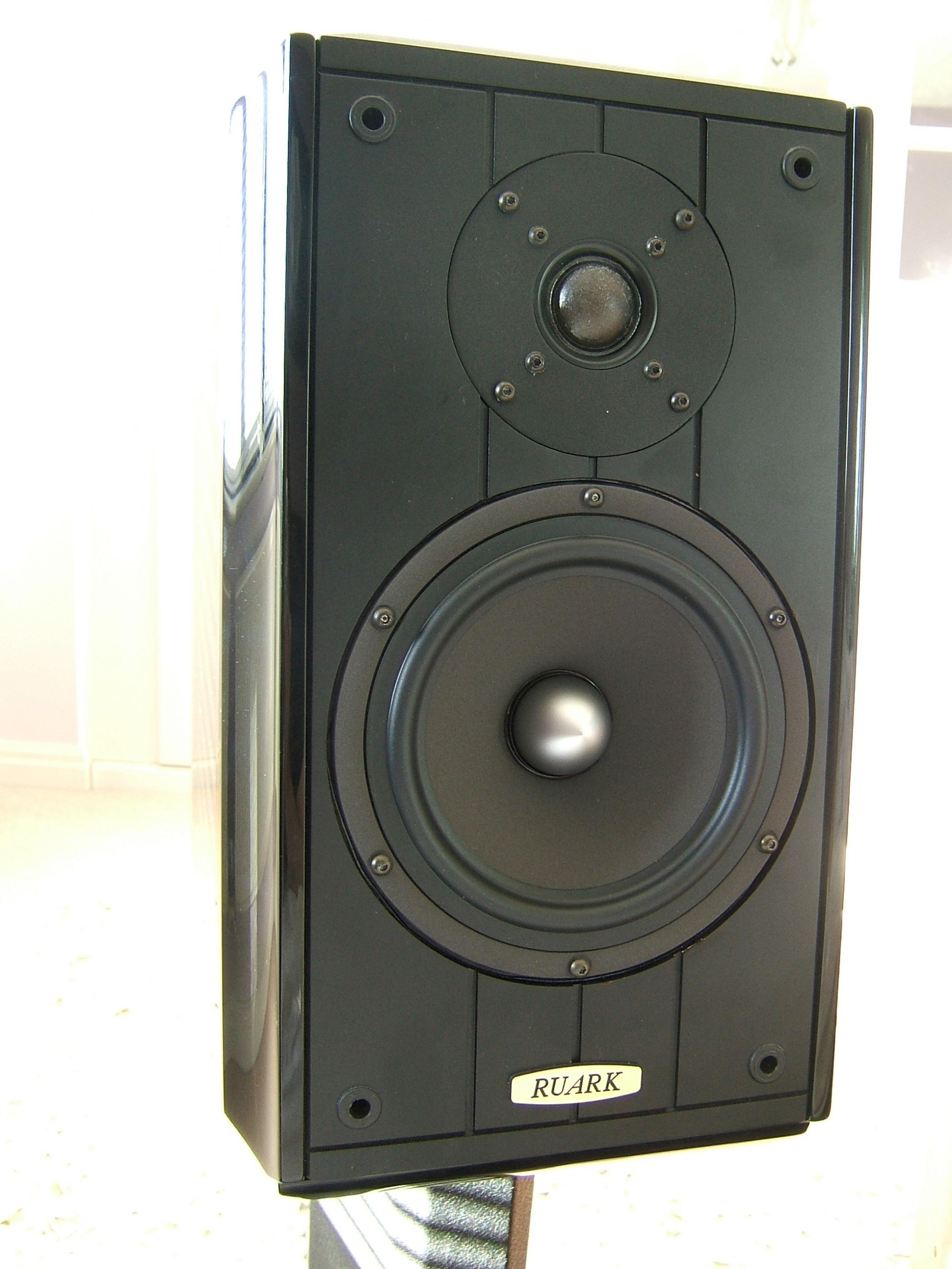

I have actually purchased a pair of SEAS WN18NX001 woofers from Audio Components in the UK. I have replaced the blown Vifa driver with one of the new SEAS units and carried out a side-by-side comparison test with the other enclosure using the standard Vifa unit. What a difference..! There is now much more clarity in the midrange and everything appears to have space. Bass is solid, well balanced and has depth. The overriding aspect to the test and something I noticed immediately was the rather flat-sounding Vifa unit in comparison with the SEAS unit, and even my missus commented on the difference in sound clarity between the speakers..! 😱 Maybe I’ve just been extremely lucky in the fact that the new driver has worked so well (to my ears), as I was limited to only a few SEAS units given that I did not want to alter the cabinet to fit the driver or vice-versa. I have included a couple of photos that show the standard cabinet with the Vifa unit and the SEAS equipped cabinet – not bad for a novice, but I did have help from numerous sources including you guys. Thanks… D

Yes, it sounds like this Vifa driver is burned! You can take it apart and see for yourself.
Good to hear that you like the Seas driver, even though without cross over changes!!!

My upgraded Ruark Equinoxes sound fantastic with the new SEAS drivers (W18NX001) installed. It’s over a year now since the upgrade and I listen to these the most. I also own a pair of Ruark Solus which use the Scanspeak Revelator albeit with a slightly smaller cabinet/driver, but the Equinoxes are far superior. I recently upgraded my amplification to a Myryad pre and power combo and this has further enhanced the detail and balance of the system. The difference is chalk and cheese. The Vifa units were terrible in the upper midrange frequencies, they sounded dull and lifeless as though there was a hole in the response in this range. I did not notice this until I bought the new units and installed one driver and compared them side by side. At first I thought it may be a stereo issue and how the music had been mixed. But after switching the speakers over it was clear that this was a driver issue. After installation of the second SEAS driver the overall sound was immediately more detailed. The bass was still present but the difference was in the midrange and the sound more balanced and natural.
The SEAS drivers were £150 each from Audio Components in the UK. As mentioned previously there were cheaper alternatives in the SEAS range which I thought would not have done the speakers justice and there were more expensive items as well. The more expensive items I looked at were all magnesium coned as opposed to paper coned and I thought I may be straying too far away from the design intent of the Equinox. Especially, as I was not intending to carry out any further changes (crossover network mods etc). As luck would have it the driver I chose was ideal and required no cabinet modifications or crossover changes, which didn’t go down too well with the DIY community as I was effectively working backwards way round. I was just lucky I guess as I based my decision mainly on comparing driver performance specifications.
I feel my speakers have been given a new leash of life and aesthetically the cabinet appearance has greatly benefited from using the SEAS drivers. Especially, with the satin chrome-plated phase plug against the gloss black. Although the copper-plated phase plug in the magnesium coned driver is to die for... Maybe one day, when funds permit, I’ll try the W18EX001 at £180 each, but I suspect further upgrades will be necessary to the crossover network.
