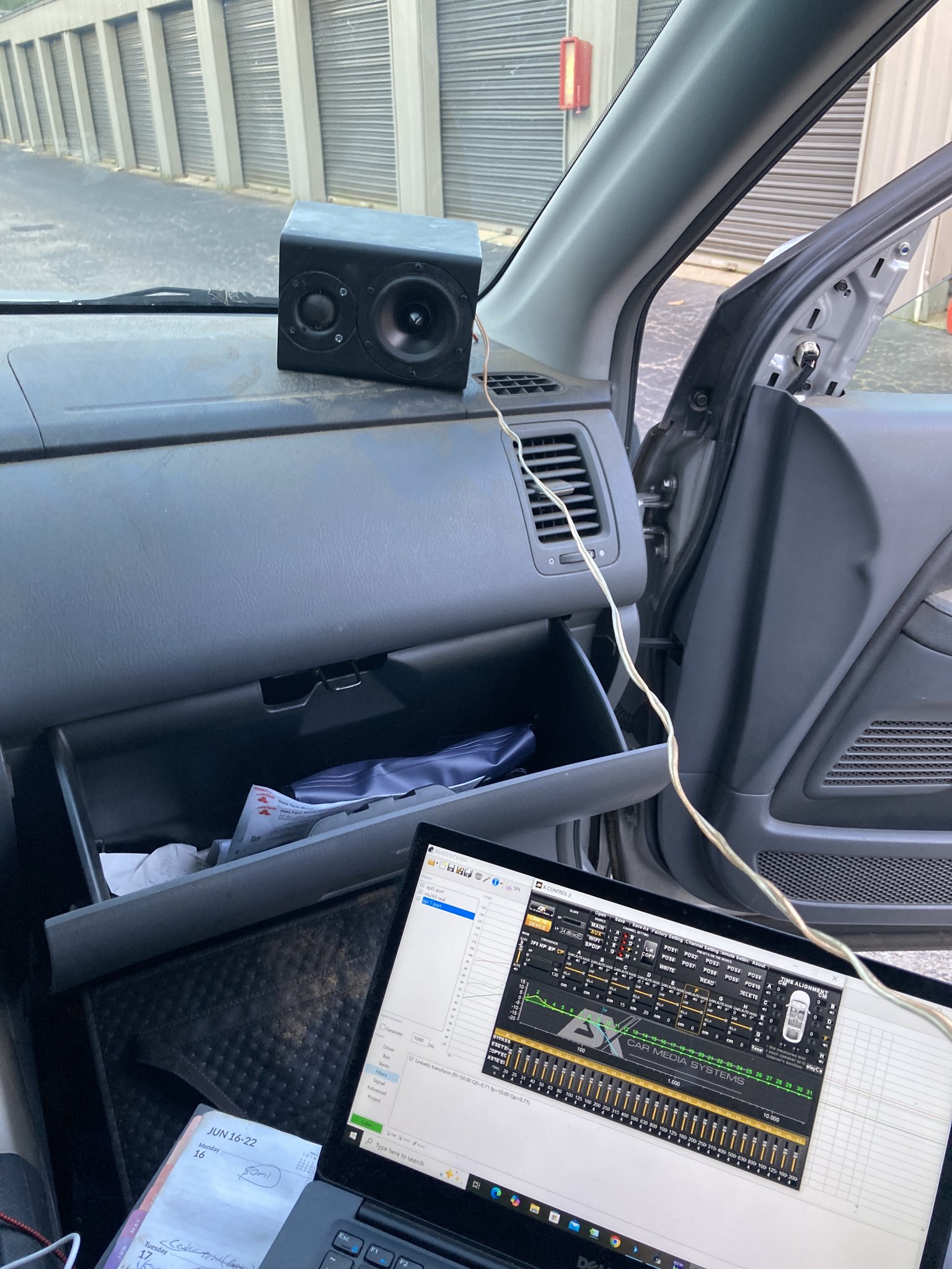

Hello all, I read around and didn’t really find my answer. I’m heavily considering using just a pair of rs100’s from ~125hz n up. This is for a simple car stereo system that I’m trying to make my bucket list of having upfront bass with only a ~4” driver in the sail panels. I’m prepared to do door midbass or passenger footwell woofer if I have to but I will tolerate it not being perfect up front effect.

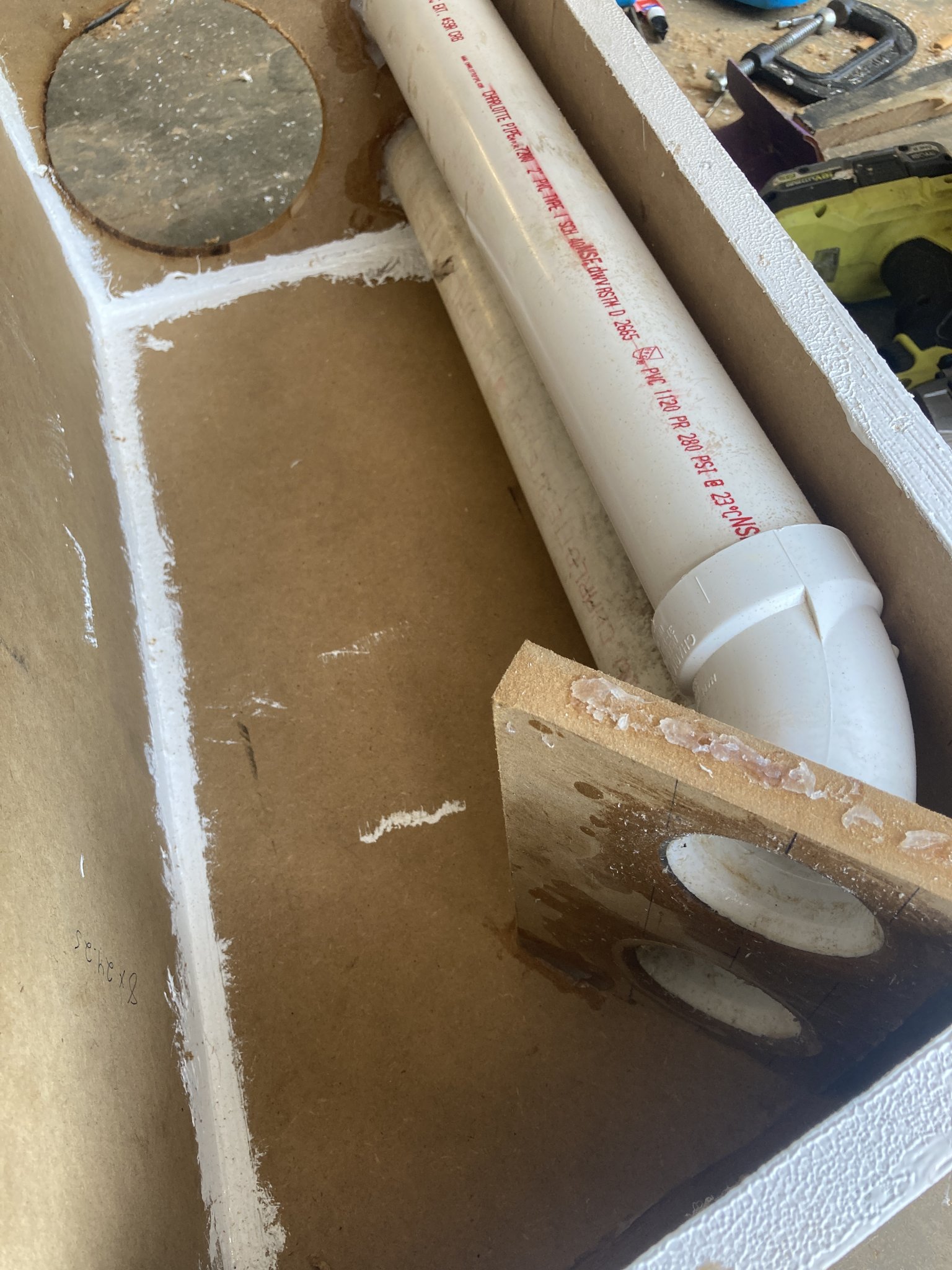

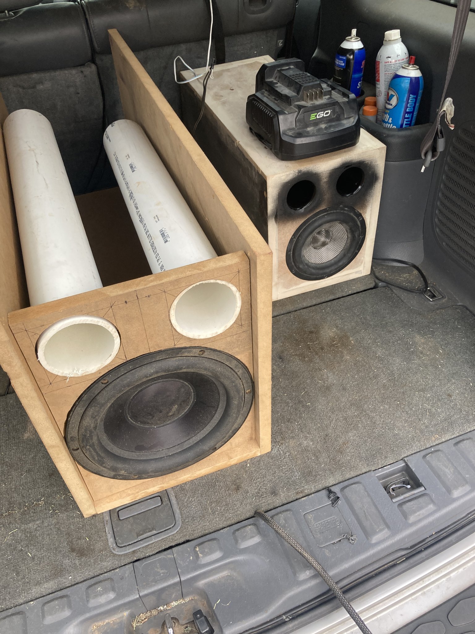

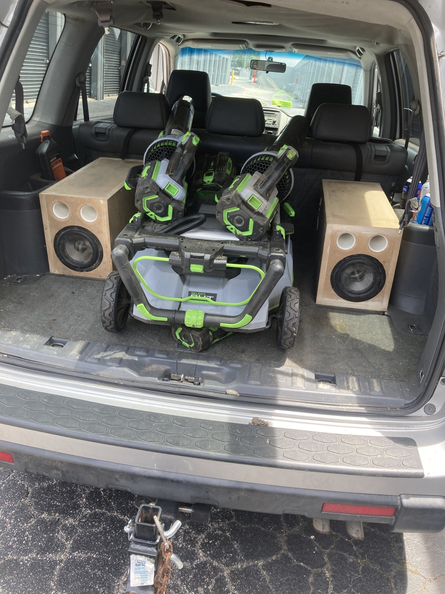

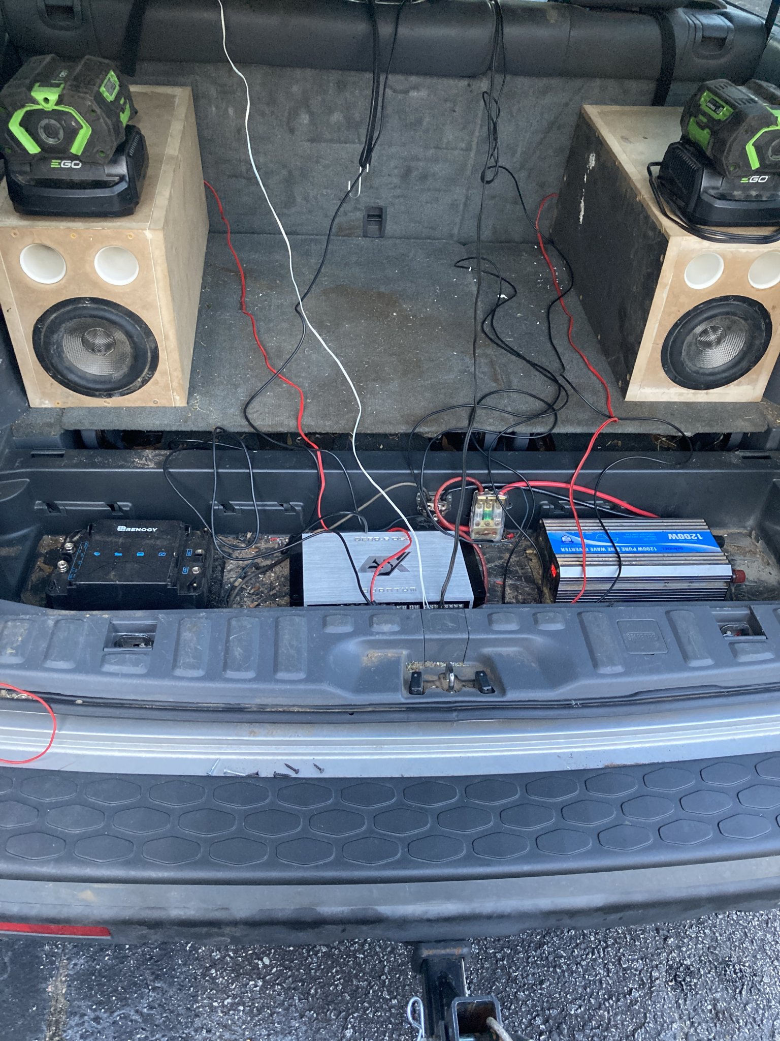

I’ve already moulded fiberglass to the shape of the sail area and there’s a small opening on the top of the door card that should make it almost if not infinite baffle. Winsid shows the response of a large cabinet having f3 around 125 ish, if I recall correctly. I’m running two ported epique 7’s that are surprisingly powerful tuned just below 27hz. The port velocity and 1st resonance are all in check with the resonance at something like 260hz.
I have extra rs100’s and will be using them either way. I also have the dayton nd28 1-1/8” tweeters that are advertised to perform as low as 2.2khz if needed. This will be fully active and I have the channels for the tweeters but again, bucket list.
From my reading, people seem to enjoy the rs100’s full range and the Facebook dayton group was in high regard to this, except one gentleman. He was very adamant about their ringing and breaking up quite early and heavily suggested running a tweeter below 2.5khz. The dayton graphs look decent enough for my needs but I can’t get his opinion out of my mind.
I wasn’t able to find very much independent measurements of decay or breakup so I come to yall for expert opinion. Being in a car, I feel like a fullrange would be beneficial in its beaming to attenuate reflections. Either I fabricate for only the rs100 or I fabricate for a tweeter as well. I’ve outgrown the need for perfection in the chaotic car cabin environment and ok with some barley audible ringing but for the time and effort of fabrication I want to try my best to avoid disappointment. Both sides will be aimed very on axis to the listening position.
