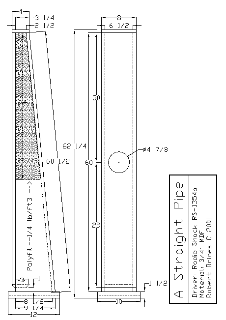

I've had three of these in a garage cabinet for too long, and I want to use them. I built the original Weems pipes with them a long time ago, and a pair of Hawaii 5.0s that are still being used as rear surrounds. I'd like to do a pair of mains and a center for the rest.
What's a good design for mains? I found an explanation of GMs MLTL that looks good. Better than the TQWPs out there? What about a center?

Good Q, don't recall anyone doing a comparison to mine Vs Bob Brine's popular TQWT and can't recall if I even did a sim comparison after I got MJK's software. If his cab's net Vb is larger, it theoretically would have an 'edge'.

Any idea where to find the build specs for Bob Brines ML-TQWT?
Lots of references, but no numbers. His site is missing pics now.

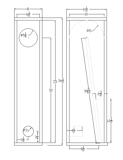

Attached is the straight version, and (i think) the folded version. Here is a picture: Radio Shack 40-1354 ML-TQWT Speaker - DIY Audio Projects Photo Gallery
