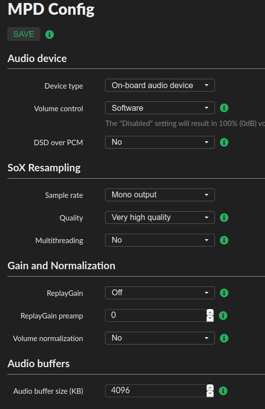

However, you should be able to configure a mono output from upstream...ie the RPI. Distros such as MoOde have a mono option ootb . (see attached config)
Then you could use any DAC-Hat.

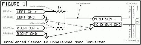

Yes i am familiar with the software option for this, but what do you think would be worse for sound quality? to use software to merge stereo to mono, or hardware (with resistors as in picture attached )?

If you need only one channel out of a stereo DAC, you can merge the two analog outputs to average their individual distortions. You will not hear any difference, but it may be measurable.
Plus feeding both channels with the same mono signal - i.e. making the sum/2 in software. It is a trivial operation.
as Phofman says it is trivial to do in software and given your listening environment... you are extremely unlikely to perceive any quality degredation...
