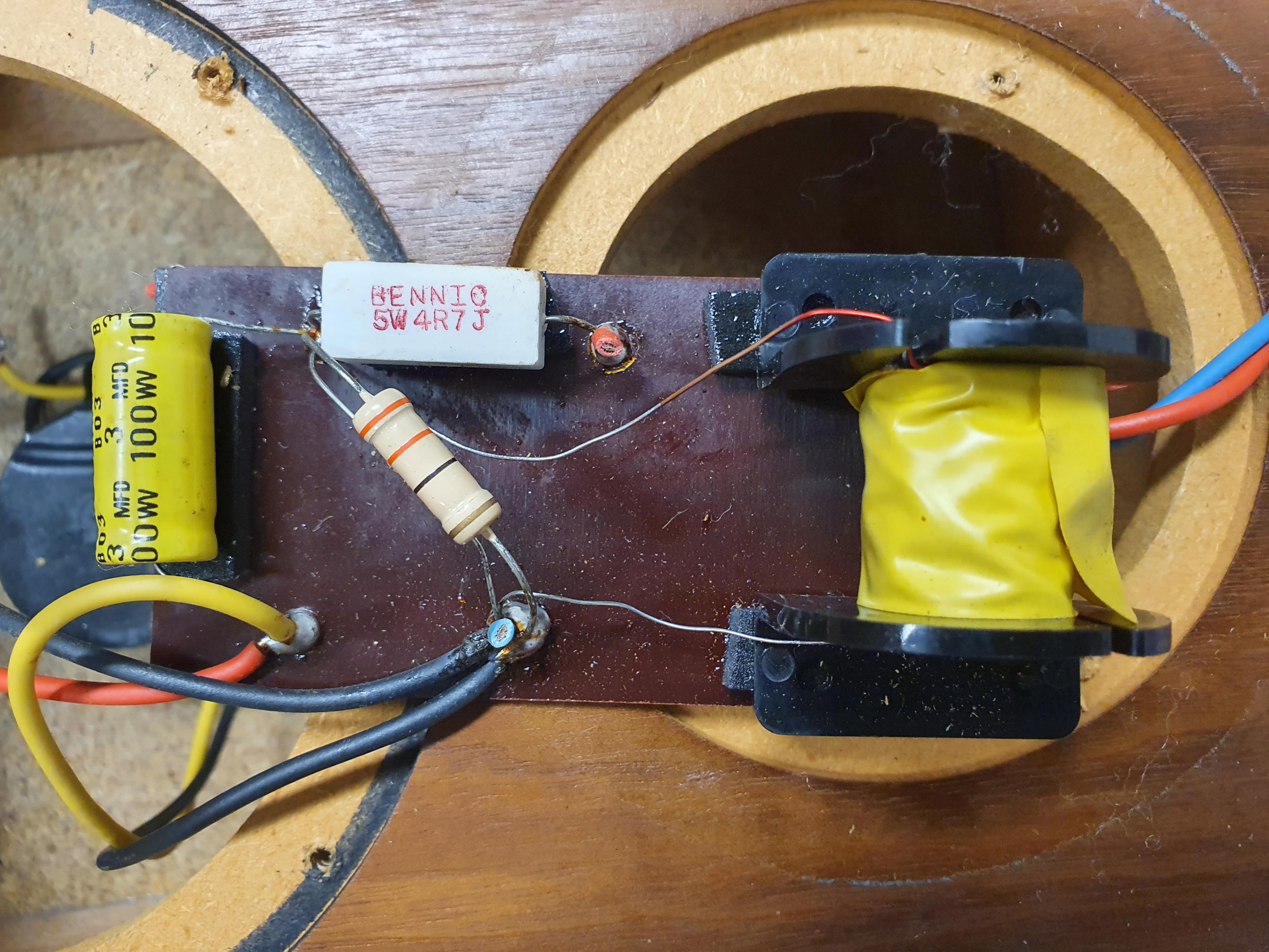

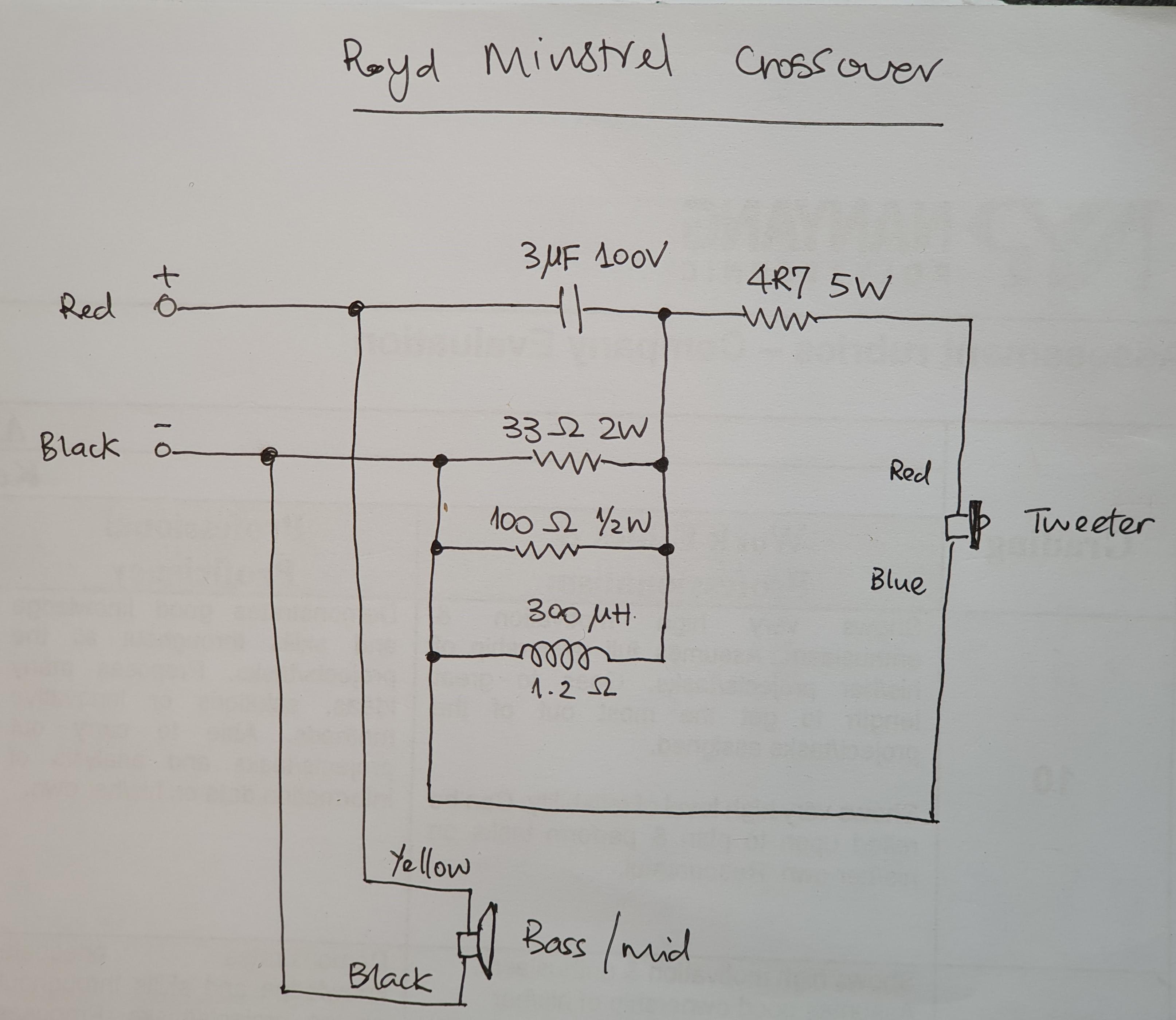

Can anybody advise me of the crossover components, values and implementation in the Royd Minstrel? Photo's would be great but any info on the layout is welcome. I believe there are is no low pass and the high pass is a modified first order but I'd like to know what the modification is if possible. 😕

I removed the drivers of one speaker recently and took the chance to inspect the crossover & trace its schematic. The photo of the original crossover and its schematic are attached.
