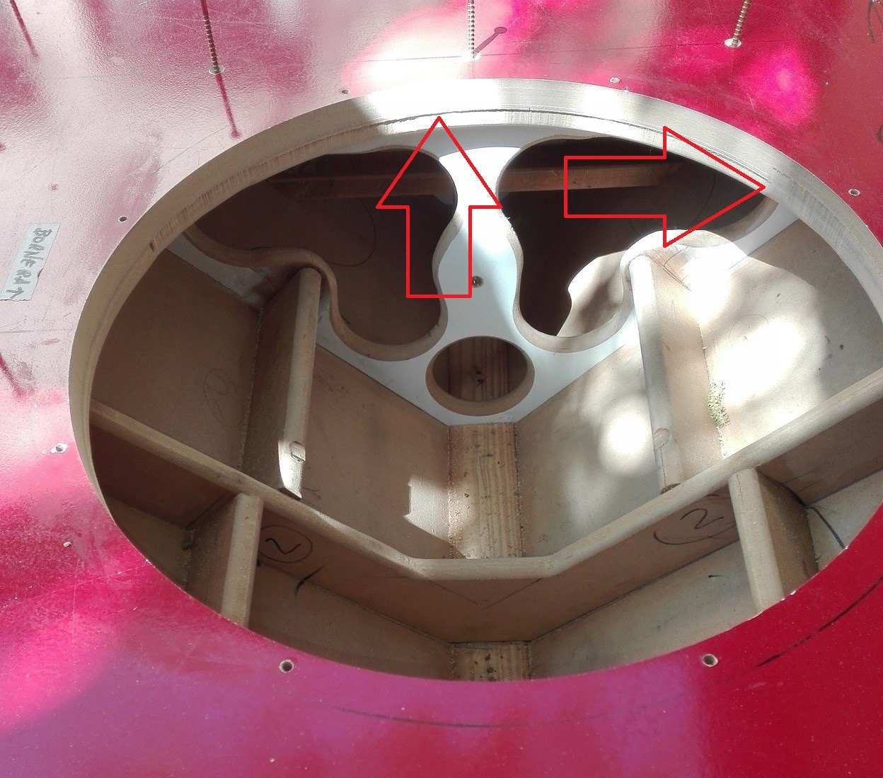

As much as it is done in steps, if the bit is short and/or the route of the router is not enough, it must be done working on both sides. And the template/compass takes away more travel, I had to lower it to the minimum possible.
To work from both sides with the compass, it is very important that the central hole is perfectly at 90 degrees. Otherwise, both cuts will not meet exactly, I speak from experience, see the attached photo. In that case, I was lucky that the error was on the chamfering side. Use a hole punch with a square guide for that, it is 40 mm, if you do it trusting your hand, it is very possible that the hole will be inclined.

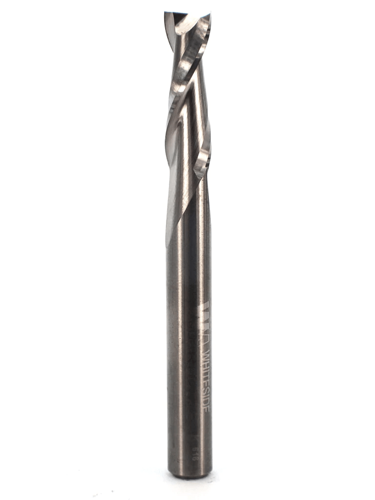

This advice is probably too late to help the OP, but I agree with prairieboy. I would suggest a 1.5 HP router as a minimum. I recently bought a Bosch 2 HP 1613 and it works great for routing driver recesses and holes. My old circle-cutting router was a 1 HP trim router, and I pushed it to the edge of failure on several occasions when routing driver holes.
When making the thru-cut, I use a 1/4" diameter spiral up-cut bit. I have this bit in both 1/2" shank and 1/4" shank so I can use whichever collet is installed in the router. Both work equally well. The spiral up-cut feature allows me to make 3/8" deep cuts (9mm). Compared to a straight-cut bit, there is significantly less effort and much better chip removal. I prefer Whiteside or Freud bits.

I should mention something about the up-cut spiral bits: The surface of the cut is not as clean as a straight-cutter bit. The spiral bits leave a bit of "fuzz", which is very easy to remove with a sanding block or a file. This is no problem for me, because I apply veneer AFTER I cut the driver recesses and holes. I then use a laminate trim bit to cleanly trim the veneer to the shape of the recess.
Some people prefer to apply wood veneer BEFORE they cut the recesses and hole. In this case, the spiral bit may leave a poor edge cut on the veneer. If anyone wants to use a spiral bit on sheet material with the final veneer already installed, I highly recommend making a test cut. You may find the spiral bit is fine, or not. The straight cut bit might be the only option for a very high quality cut.
j.
