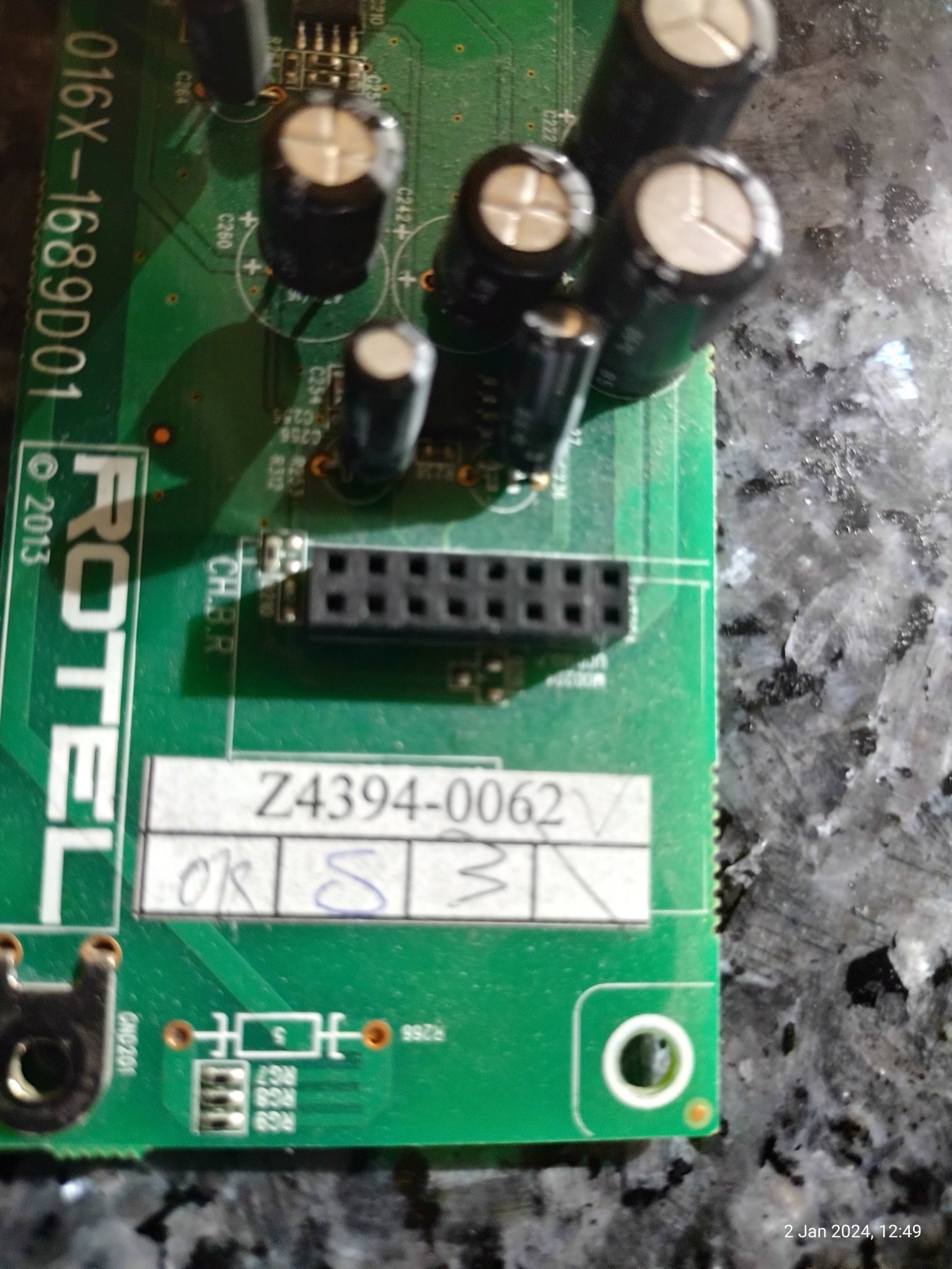

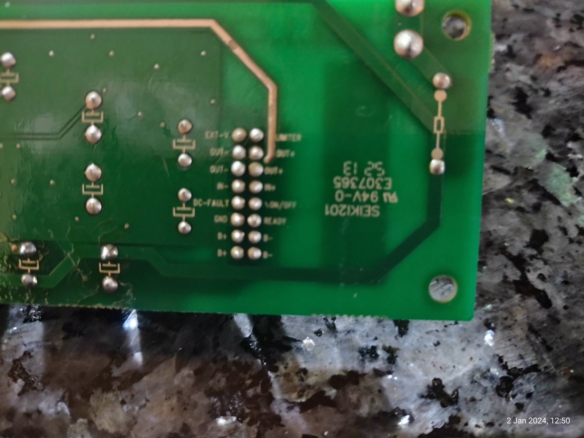

Here's some pictures of the PCB sockets that the ULP250s are plugged into. They are screwed onto the heatsinks, and the boards attach to the heatsinks too.
The pictures are really useful, thanks. Looking at them quickly, I think it may be easier to intercept/redirect the amps signal inputs on the amp motherboard (if one side isnt immediately grounded!) - I'd prefer not to mess with the hypex modules if I can avoid it. I guess I'll just have to locate their pcb tracks and experiment a bit. And then there's the fan issue as well. Anyway - you've been very helpful and I'll let you know how I get on. It could take a while though - like you I have other priorities for the next few weeks or so.
