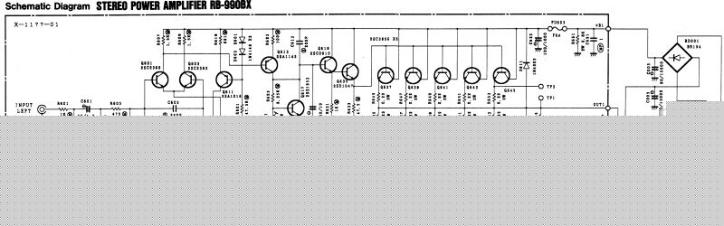

Hello, I would like to buid this amp for my subwoofer.
I have The PCB and I think I can trust this amp.
anybody knows the Supply Voltage of this Amp ?
The PowerCAP's ratet 80 V but... ??
And why did I found such few from this amp in the forum.
For me it looks great.
The Driver Transitor's ( 2SA 1492 and 2SC3856 ) are verry expensive exist some ceaper I can use.
What do You mean ?
Andi

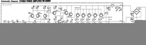

Full schematic
Hi Andi ,
Could you please post the full schematic. I can see only a strip of it.
I am sure you can use other power devices.
An 80 volt cap means that the supply must be at least 20% lower than this . Could be in the 60 + volt range.How many watts is it per channel ?
How about the full ckt diagram?
