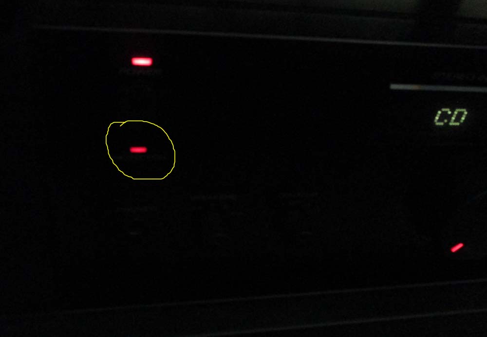

A Rotel RA1070 integrated amp, sound good, looking good. But has an issue.
If it is not in use for a few hours or a few days or longer, then powered on, the protection light is on and lasts for several mins, maybe 5 or 10 mins, even longer sometimes, eventually gets off little by little. The light should be off automatically in few seconds.
If amp is used frequently (less than a few hours in power-off) , it's ok when powered on, the protection light will get off in 1 or 2 seconds normally.
Here is about Power switch on or off, not turn it on from standby mode, if it is in standby mode, it's ok when turn on, no issue.
No matter if it is on or off, the amp works good, seems no issue.
What is the matter? there is any way to deal with it?

Thanks, will do this accordingly tonight. Its for my home audio, got it occasionally with matching cd player. The first owner didn't use it for years. A few days ago I opened it, watched inside, there were two caps leaky, I replaced them, but no luck. Anyway its sound is nice to me, really want to work it out.
BTW, state again, the amp works fine, though the protection light function is not right. Can hear the relay clicking properly. I am afraid that this issue will damage my speakers someday.

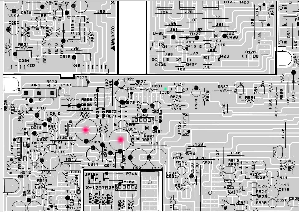

Can you tell me what these two C908 and 909 are used for? I see they are a little leaky. Maybe all caps should be replaced.

C908-909 are part of the local regulation I don't expect those to have any issues
Capacitors around IC 801 are related to the protection one of them is the timing capacitor and determines how much time will pass before your amplifier clicks if this one is faulty behavior like described matches the case ....

FWIW, I'd agree with those caps being suspect. Replace them all - i.e C621, 622, 623 and 624 for good measure. The issue is the actual capacitance in each which affects timing (seconds) and locks out the speaker connection, assuming both amplifiers are actually OK with no significant DC on the output traces to the relay.

I am checking of the caps, I will try some replacements, maybe all.
