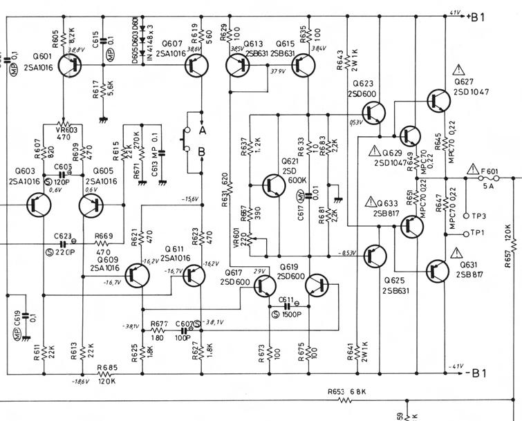

I got this amp and when i took the cover off the temperature was very high and 2 resistors almost gone :
I adjusted the bias current and dc offset according to the manual and temperature dropped significantly on the transistors.
The area next to the faulty resistor is still very hot (70C) same thing on the resistor itself.
This is not happening on the other pair of resistors (max 32C, right side in photo) but the values are very strange, 1kΩ for the broken one and around 5.7MΩ for the other three.
The manual says that they are 2W 1K...

Taking a guess, because there aren't that many 1k resistors, you must be referring to R642, 644 - the R channel driver transistor emitter resistors. These do waste a lot of power in this type of output stage so we expect them to get hot but if you read 5.7M, it will just be the circuit resistance, as the resistor will be history.
The hard question is, why? The reason is most likely the associated driver has failed and possibly 1 power transistor too. You can replace the resistor but the shorts will just cause it to run hot and fail again. When unpowered, test the transistors for shorts (both power transistors and the driver) then check the other 3 of opposite polarity as well. You can verify readings from the good channel if in doubt as to what to expect but don't apply power until you locate any such problem short(s) and replace the necessary parts.

this is the position of the resistors on the schematic The actual use of them I am not familiar with so i cannot comment on why these are getting hot ( topology i have never noticed before ) R641,2,3,4

The second yellow circle under the resistors indicate the area that gets really hot.
Yes Ian, i'm refering to resistors 644 & 642.
With the amp off R644 reads 0.88MΩ and R642 1KΩ.
R641 and R643 6.7MΩ but no hot area on the other channel
Can you guide me exactly which transistors to check?

Check Q 623, 625, 629, 633, 627, and 631.

Transistors are ok, but
there are many discoloured soldering points probably caused by high temp as Fast Eddie says.
Also some traces look with different colour.
Whats the solution here?

Use good metal film/metal oxide 2W resistors and make sure theyre far enough away from the PCB to not cause trouble.
Personally, i'd be tempted to modify the circuit - using a single 220-330 ohm resistor to connect the emitters of the driver transistors (Q623/Q625) together, and re-bias.

Hi Sakis, I can only with certainty remember seeing this driver arrangement on a similar Rotel amplifier with this overheating driver resistor problem. I recall the resistor type was too close to the PCB, so I fitted new ones with ceramic beads, raised from the board.....Do you have any idea on the actual use of this topology ?....
Douglas Self describes it in his Manual, categorised as EF type III which he says has no popularly imagined class A driver advantage ..... "but is equally as good as type II at reverse-biasing the output bases, and may give even cleaner HF turn-off as the carriers are being swept from the bases by a higher resistance terminated in a higher voltage, approximating constant-current drive ".....
He doesn't say who used it either but I think he really means to say 'pointless'. I suspect this is not a Rotel Japan design and originates from Rotel Europe, back in the day. Look at the topology, layout of the board, heatsink and other stylistic features. Constantly hot components are quite common in UK audio designs of the period so I'll leave your imagination to make the connection. 🙂

Replace the resistors and check the voltages as shown on the schematic.
