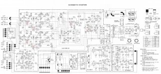

I recently encouraged my girlfriend into the purchase of an amplifier (annotated schematic attached) so that I can listen to music at her flat, I then took it upon myself to perform a "simple" recap. :worried:
Everything was going fine, replaced a few of the caps that I had stock for, ran out, put in an RS order and decided to plug in and test. Plugged in with case off and checked the bias, looking good. Theeeeen I put the case back on and prepared for audio testing. Fired the amp up to be greeted by whiffs of smoke coming from resistors (ringed purple). Turns out I'd forgotten to knock the tails off some of the caps (ringed red) and these were grounding onto the case! 😱
I knocked off the tails tested the smoked resistors out of circuit and they are showing up correct, so went for a switch on test. Now the relays wont engage, I have done no further testing as I really don't know where to start. Can anyone point me in the right direction?! I thought about going through all of the semi's one by one but wondered if a wise one on here could give me a tip off on where to start?!

Yep, really caused a few problems there. you could start by spotting the voltages marked on the schematic in fine letters and test to see if they are correct with 5%, say. This will help find the location or extent of damage. The larger caps (eg C001,C002) tend to be associated with the power supply so they need to be checked as a priority. (no power - no relay function, right?) Measure directly across the main smoothing caps. and observe polarity.
Q901 is the regulator for the preamps and protection relays so it must be working to have normal function of any sort. Check Emitter and collector voltages there as a starting point.

Thanks for all the helpful input Ian (actually thought your appraisal of my work was very moderated!). I put a lightbulb in series with the amp to make sure it wasn't drawing loads of current and plucked up the courage to turn it on again. I have taken a small set of readings and you were right to test Q901! The readings came out:
E 29.4v
C 59.8v
B 30v.
So that's knackered I guess, do I need to change that before I can test anything else or should I hunt around a bit more? Voltage readings on the res caps came out at 34.5v and 34.2v.

First, sorry I hadn't noticed your posts 'til now and though I must get some shut-eye, this part is OK. Note the regulated output is correct at 30V and emitter-base differential is 0.6V. That's about right for all normally functional BJT transistors. The supply voltage near 60V is different to the schematic 38.9V though. Is that measurement correct?
Anyway, that's how to refine your listed voltage tests of the transistors - note any that don't have a B-E voltage around 0.67V and then look at those areas more closely. Then compare those parts in R and L channels. Any real problems will show as significant differences, >10%

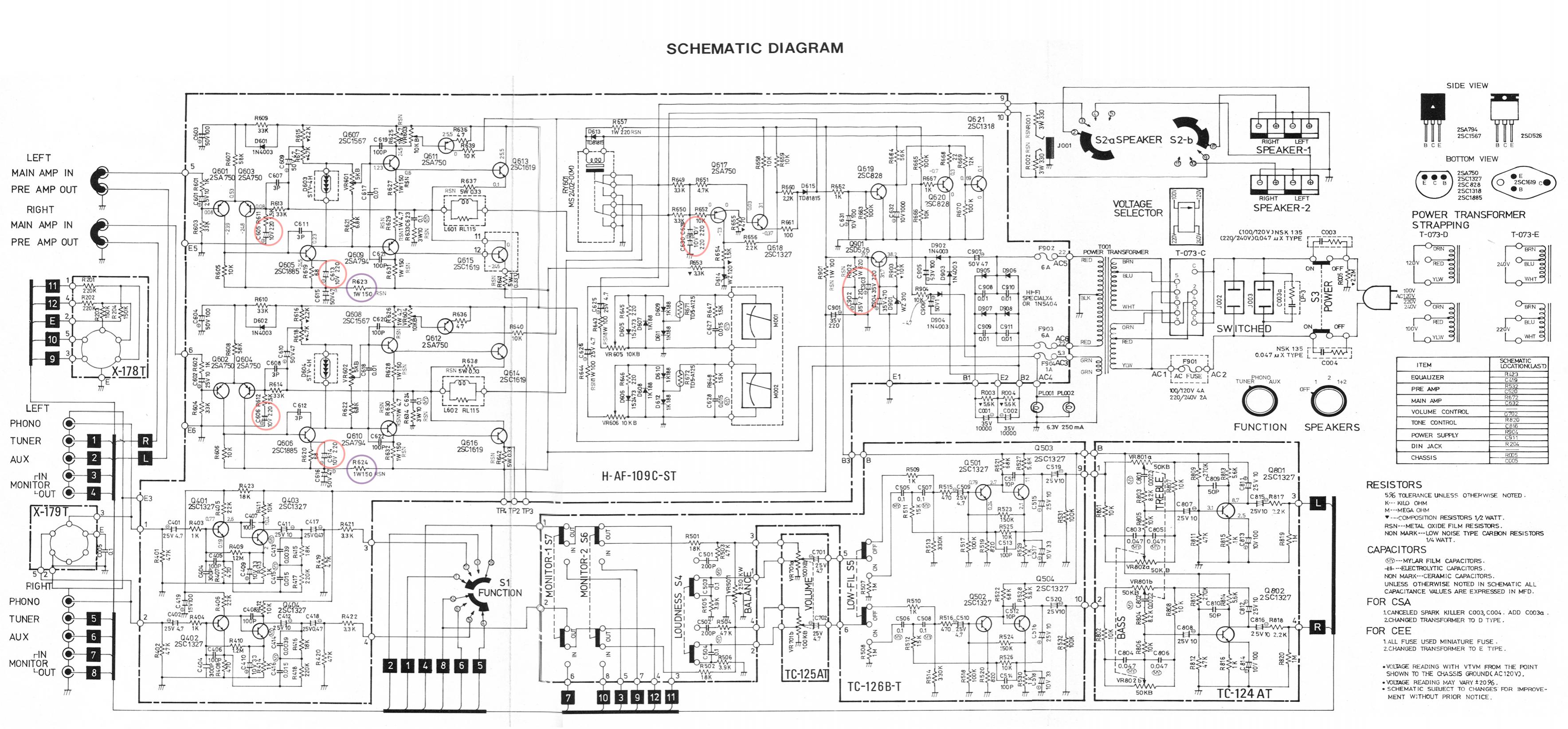

Ian, thanks again for your support in this matter. I have double checked the readings for Q901 and today they came out at E 29.1 C 50.6 B 29.7. So a bit of a change since my last set of readings (although still over 25% higher than what it should be). I find it unlikely that I misread the meter in the first instance (though not out of the question), is it possible that there are some wandering values going on in a faulty power supply? The decimal places I am giving are as many as my meter will allow according to the different ranges of use.
I just tested the voltage at the foot of R904, C906 and that came out at +0.87v (as opposed to -4.7v). Does this suggest a problem with D904 or C906 affecting the protection relay?

Q619 (E 0.001, C 0.03, B 0.001) has no voltages on the schematic but Ian does this (and Q621) not suggest a problem as there is not .6v between EB? can you explain this further as they match the values on the schematic?
The 9.14v reading at the Q621 is very far off the 0.1 given and the voltage on the other side of the relay solenoid is 24v. does this suggest a problem with the relay itself?
The -0.04v reading pre relay for the power amp output is normal isn't it? Does this point me in the direction of the problem being in the protection circuit itself?

If all the voltages are substantially higher than expected, is the mains voltage selector set for 240V?
N.B. The Collector of Q901 appears to be supplied from a classic voltage doubler (C907, D903, D902 & C905). If D901 is a 30V Zener (your measurements suggest that it is...), the Collector voltage is probably 'normal' given that the Base & Emitter voltages also appear to be 'normal'.

You've already shown that the transformer windings are OK - AC3=5V4! :checked:
Check the voltage @ AC4? It should be the same as AC3 unless F904 is open circuit.
