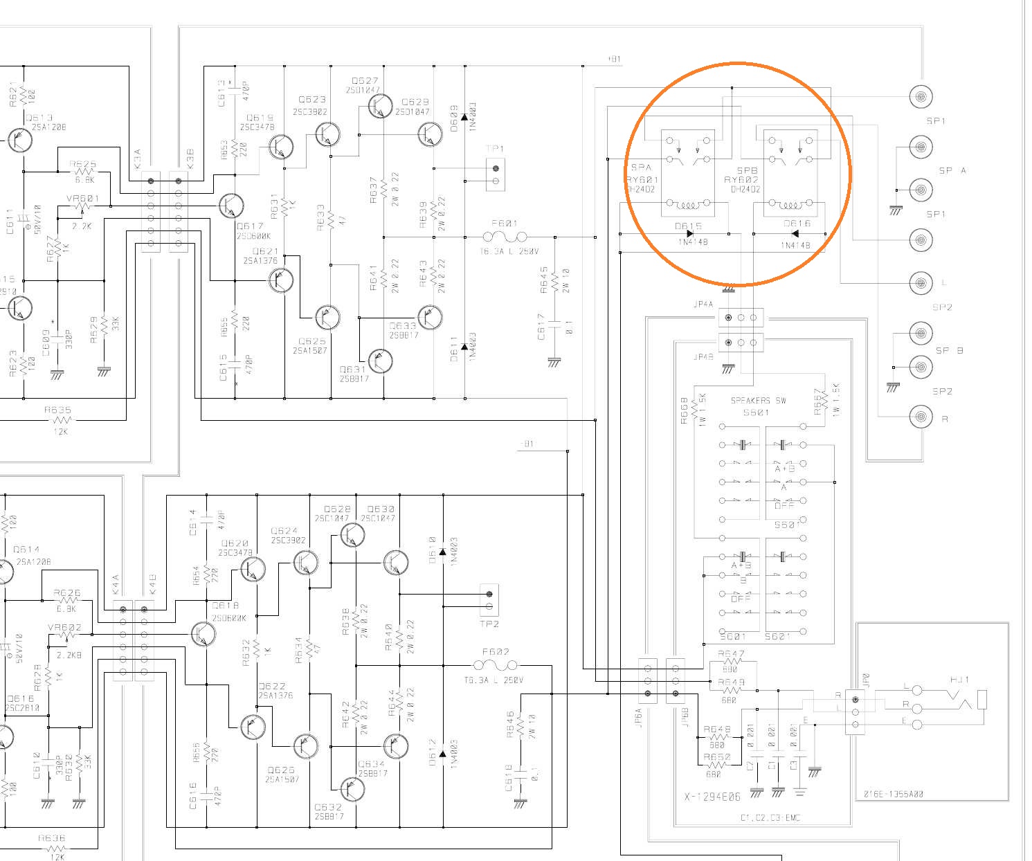

My Speakers (B&W 8 Ohm per speaker) just stopped reproducing sound. I plugged in the headphones and the sound came just fine through the headphones. That's why I decided to plug in my second pair of speakers instead of the first one, I thought that the speakers went broken. So I plugged only one of those (bang & olufsen 4-8 Ohm) and I could hear some music coming out of it, but it was extremely silent. I would also like to mention that all of the fuses are intact.
Any thoughts?
Looking at the schematic of the amp, it looks like your output switching relays (or the solder joints around them) are causing the problem. Do you hear the relays click after turn-on? If yes, and the signal goes through to your headphones as you said, that must be it. Check the relays, and either clean or replace them (if not familiar with electronics repair, let a competent person or repair shop doing it).

Yes, when I turn on the amp, there are two distinct "clicks". One is for the "power" lamp and the other for the "source"(cd, tuner, aux, etc.) lamp.
If I decide not to do it alone, at least I know what's the problem, so it's gonna be a lot cheaper. Thanks a lot! 🙂
Further investigating the schematics brings up two more possible causes for the problem:
1: the speaker selector switch, if it has a contact problem it might not engage the speaker relays.
2: the protection circuit might be also faulty itself, in which case the relays do not get their operating voltage.
In both cases the headphone output is still "alive", so you need to check these areas too.
It clicks two times as always, so the amp basically behaves as always, except that there's no sound coming from the speakers. Just headphones and as I've already mentioned, an extremely silent sound from this one speaker with the smaller impedance
First I'll try to figure it out myself, probably try cleaning it first. One more question: since there are two relays, I suppose that one is for A channel and the other one for B? Neither is giving sound on my amp. Do you still think that I would MAYBE manage get it to work if I clean it (with paper, and spray cleaner, etc.)? I've just started studying electrical engineering, and I must say I have zero practical experience, but I suppose that there's no time like now to start getting some practical knowledge 🙂

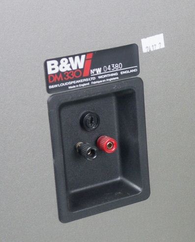

So, I feel obligated to tell you how stupid I was 🙂 since both speakers sort of stopped working at the same time while the music was playing really loud, I thought right away that the amp was faulty. And since I wired this second speaker, and it didn't work all that well, I was sure it was the amp. But yesterday I decided to give it one more go with this speaker which wasn't playing loud another go. And surprise surprise, it works like a charm! Although, I'm baffled to how the both speakers (B&W DM330i) stopped working almost at the same time. The difference was a couple of seconds, but they didn't just "drop dead", it was rather like they were losing loudness really fast. In the last moments you could still hear the music really silent. But I triple checked now, and both of the speakers are dead.

I actually pulled one speaker mid bass and connected it with wires to a battery and it moved. And I sort of started examining the back of the speaker and found a fuse 🙂 actually both fuses were "cut". I changed both of them and it turns out that one of the DM300i was working and on the other one only the high, the smallest one. So I suppose these two died due to the extreme volume of sound.
Actually the guy at the store smiled so genuinely when I asked him what could be the problem, he said well extreme exertion, and I said, so the music was too loud, and he said yes, and I said, well the neighbors must be glad 😀
