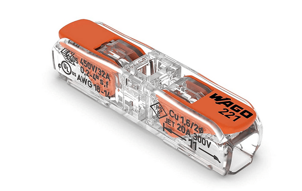

I have the same problem, usually I soldered wires on the switch, then install it via Wago nuts.

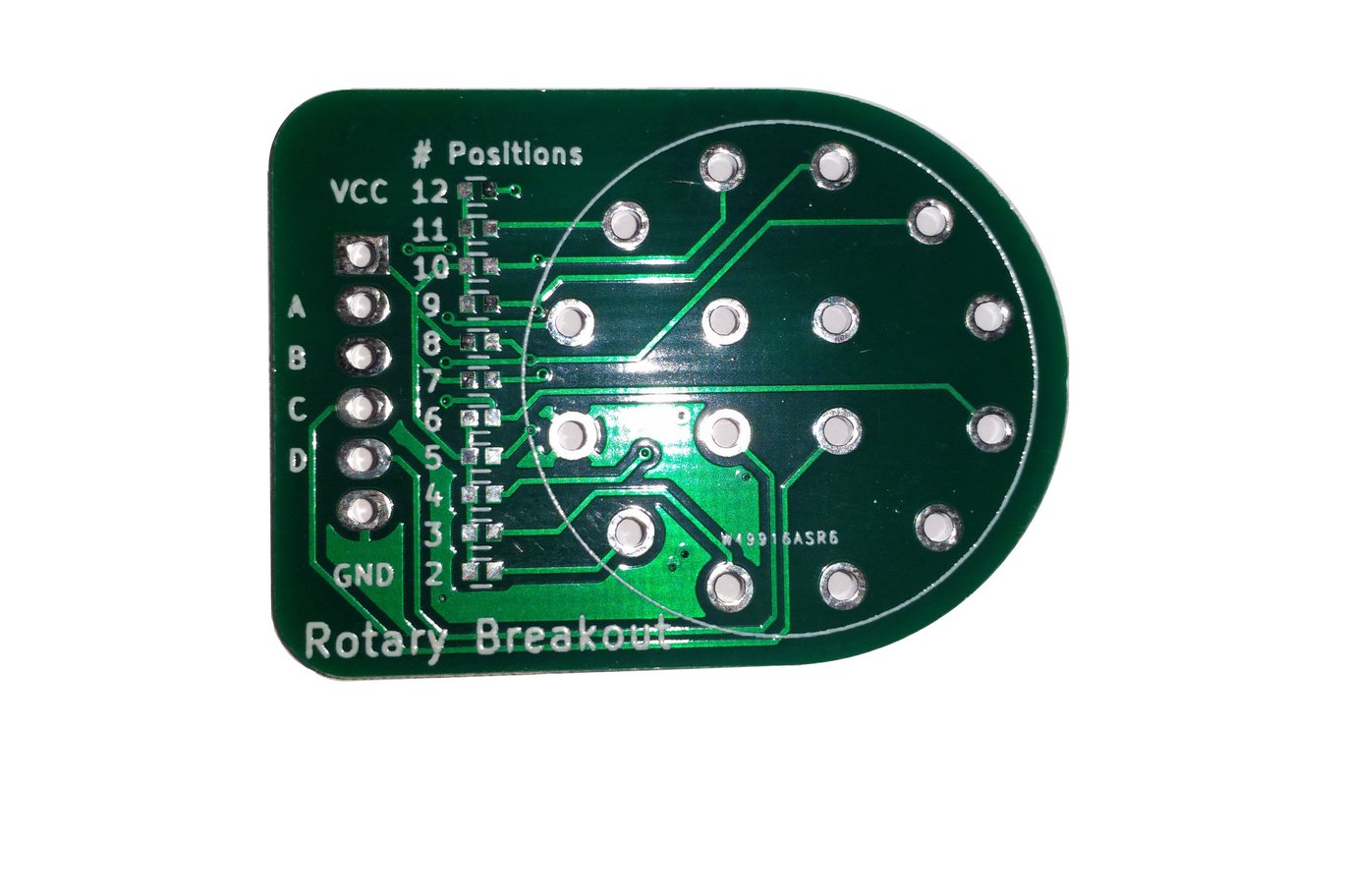

This is the switch, I have…. The problem with it, is the size. It’s just too small for me to solder. My skills aren’t good enough…
https://www.mouser.com/ProductDetail/Grayhill/50KS36-01-2-03S?qs=ls7QRyWmRk77q6KCuLZrOA==
It is a slight possibility that there is an adapter board for this switch, making your job easier. You are right this would be a real challenge to wire up. Let me look around.
I like the concept. The problems with the switch I bought are:
The outputs are small and inside the inputs, not enough room
The inputs have a small hole and I can’t get the wire into the hole , so it would require me to solder next to the terminal. Not a good connection, I think.
