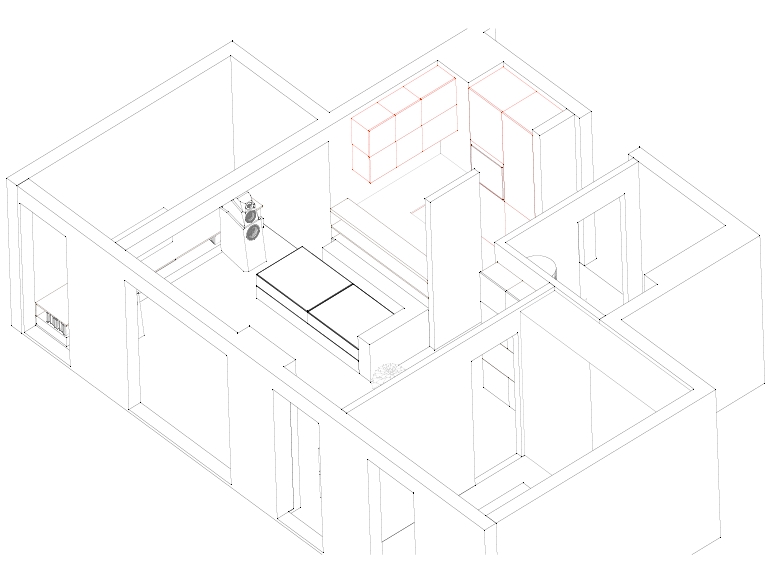

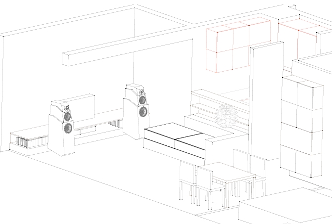

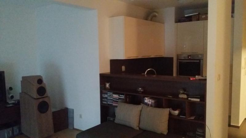

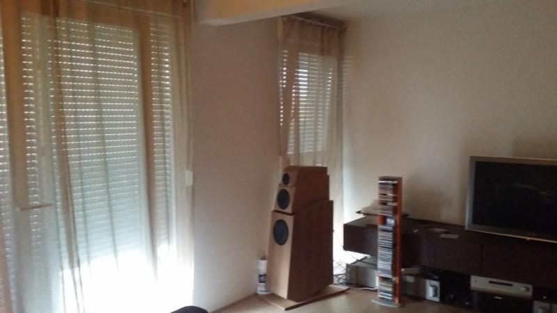

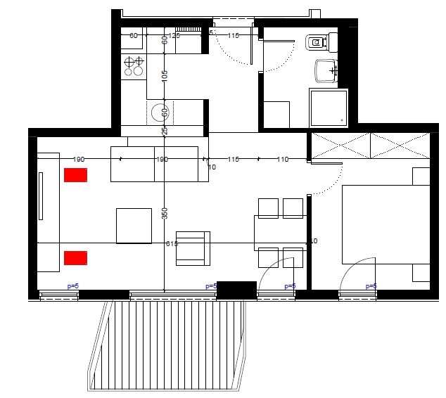

my apartment is small, as you can see from the drawings...total of 43m2
basically it's living space (3,5mx6,2m) open to the kitchen and entry lobby...
with couple windows
and plain concrete walls
right now I have no carpet on the floor or any picture on the wall, it's basicly as in 3D model...
so I need some advice what to do, what to place and where, some bass traps, some diffusers, some paintings
what to read
where to start
here are some plans of my apartment, with loudspeakers in ''red''
and 3d model for better understaning of ''open space''
any advise is appreciated

You're really going to have to measure your room to save a lot of trial and error experiments as there's a very different load on the left and right speakers and I think this will not just affect the bass (as Scott mentioned) but the mids too

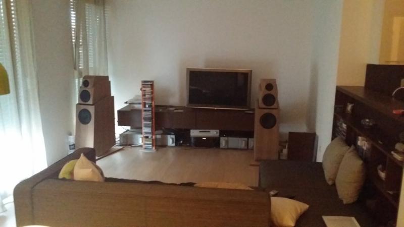

Interestingly, the right speaker doesn't have a sidewall (apart from the alcove corner) so very little 'first reflections' (no side wall) and your left speaker has a window that also presents lower bass impedance (ie, no bass corner gain but has a close sidewall that might need some absorbtion - perhaps try a blanket/doona with a couple broom handles spaced a bit away from wall surface to see if the effect is desired ...
A curious thing to try - put a blanket/doona/etc over the tv screen when playing some familiar music and see if this effects the sound much - generally, it does, so a purpose built lightweight cover can be easily organized or incorporate a diffuser in that place

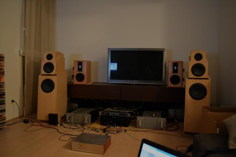

Without thinking: I'd want 4 inches (100mm) of fuzz ALL over the three walls of the alcove. You need more total absorption than this, in an all-concrete room this size, and that's a good place for a down-payment. And it has space for thick fuzz which will absorb down to midbass. So will the sofa. But carpet only absorbs the highs. THICK theatrical window drapes can be more broadband but are too expensive for home.
This is James' "blanket over TV" idea taken further, so start with the thickest comforter you can find and hear any difference, to get the idea.
It may tend to be bassy because the concrete will support bass (unlike dry-wall) and thick-enough fluff will be objectionable for a living space. (Mix-studios can give up 20% of room volume for absorption; apartment dwellers can't spare the space.) Electronic EQ may be needed. Maybe only -1 on the Bass knob, though snazzy digital has become too cheap to avoid.
After that: IMHO there's no right answer. The room is not-large and lop-sided. I've worked in worse; hated it.

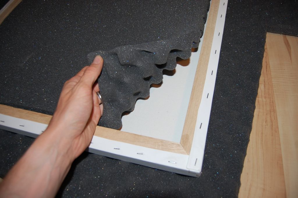

- I can place some ''painting'' on the left wall - was thinking about print work (that looks like painting) on a wood frame and some foam or thermal wool ''under'' the painting...
something like on the second picture
I can place one on the left and one on the right wall (one opposite to another) ?
- The other step is to cover TV - well I can place some cloth over it...make some frame and just place it over TV when I'm listening music...that would not be hard to live with 😀
- Will there be any benefit to place some of those wood blocks with different higts, like on third picture, and if, where should I place it ? ( I think I can do it in diy version 😀 )

As you mentioned working on your bass amp, you're used to doing diy, so making acoustical filters and diffusers will be well within your grasp - but, it'll probably be new territory unless you're involved with pro-audio, so it'll take a bit of time to sort out a lot of well meaning terms (mine too) when talking about room acoustics
As'PR' mentioned, the uneven room will make things a bit awkward, especially when you get to measuring freq response and the decay times - the best advice I can offer about this is to take your time and only change one thing at a time

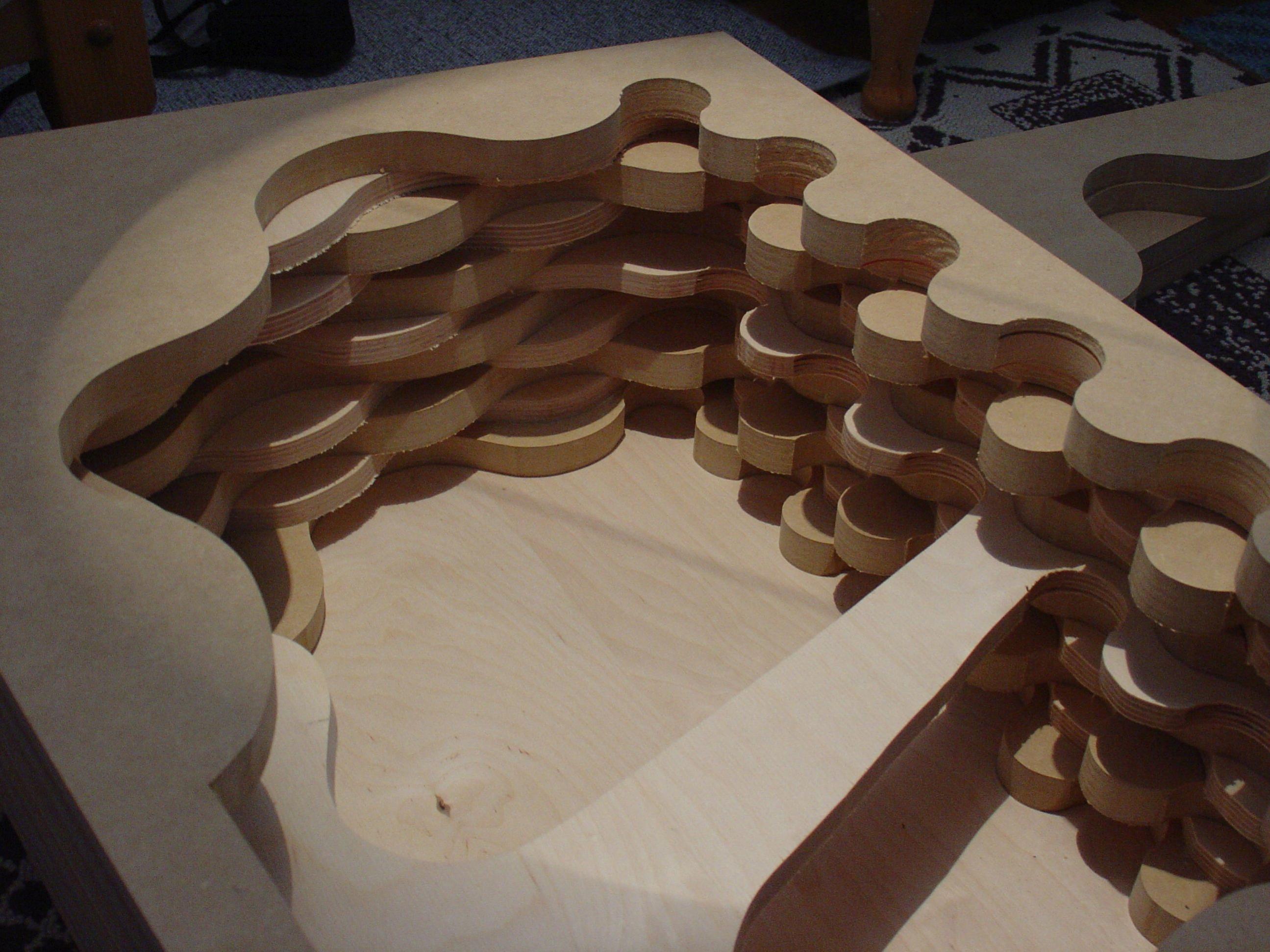

One thing I can be a bit more definite about is to make your own absorber panels - the fancy profiled ones are not as effective and not cheap - the 4" thick thermal wool that you mentioned, covered by a decorative acoustically transparent print, can work quite effectively down to maybe 120Hz - you may find that the freq reflected from the close sidewall maybe high enough to use just 2" thick material

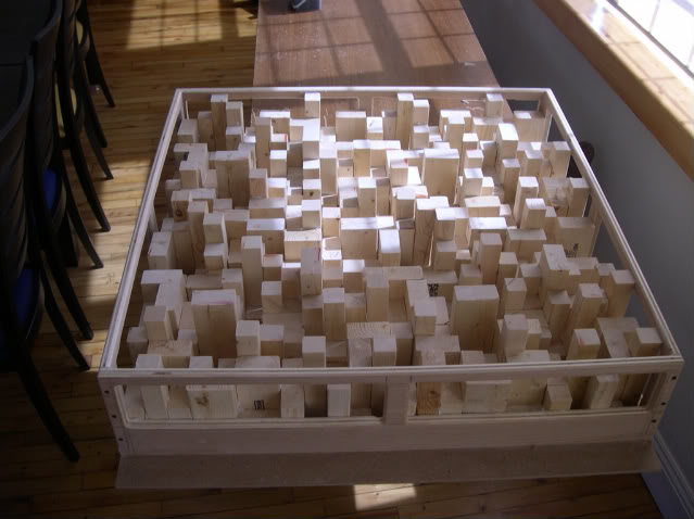

The wooden block diffusers (known as Skylines, or 2D Schroeder diffuser) are very useful things indeed but generally, after the bass is sorted
I hope I haven't just added to your confusion ...

so for the start, I will make two ''paintings'' with 2'' fill (like 5cm - thermal wool or something like that) and see the results...

So you're used to organizing things - that's good
Improving a room's sound isn't something that happens overnight, ever, even if you throw a lot of money at it like some people do
You've got the main room that's 6 metre by 3.5 with an alcove kitchen plus hall on one side, and an additional doorway to access the bedroom volume - you do have rigid walls but some windows to avoid excessive bass gain - the wall next to the right hand speaker will need some attention, possibly a specific bass trap in the corner depending on what you discover when you measure the room, particularly with just that RHS speaker working - it's uneven, a bit awkward, but do-able without relying on extreme dsp solutions
And it's a particular challenge to get a grasp of this rather contradictory subject called room acoustics - this is the hard part and it takes some time - patience required!

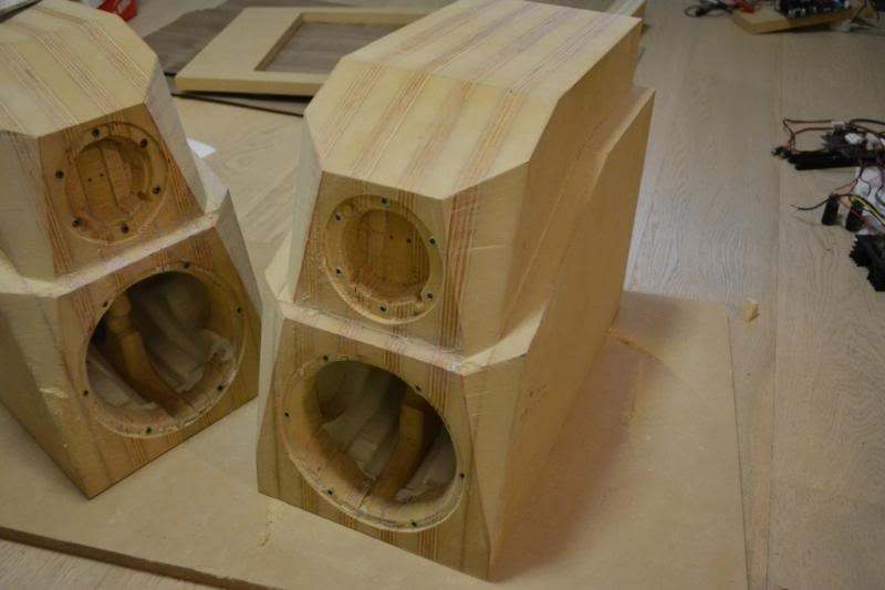

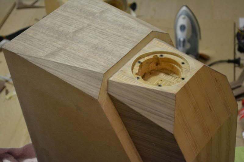

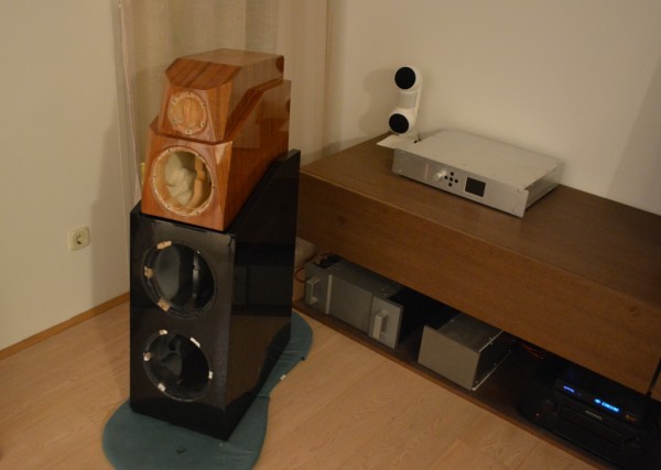

The loudspeaker start as Tony Gee and Edgars EVE II SpeakerBuilding.com - The GeerS eVe II, Page 1
But I change twitter to 2904/7000 and add another 21W8555, and adjust twitter/mid bas (18W8545) position as I like it a little lower than the original is made...
basically it's completely new speaker, 3way active 😀 ...and active makes things a little easier to work with then the passive solution, especially if you are beginner like me (those were the first speakers I made...and it took me like decade+ to finish them...as I have so little time...and space...and...)

I had luck with cardboard tubes.
The thicker ones people use to make round concrete bases.
Sonotube is a name over here.
I found 12" across tubes, a foot apart works great for an open sound where the walls seem to disappear. Be sure to have them at ear height. Ideally all side walls and behind you.
The World's Best Photos of barreldiffuser and sound - Flickr Hive Mind
I like the way talking at a round diffuser sounds.
The scattered ones (Schroeder ?) with slats or little cubes sound add and jumbled, compared to how sound will evenly scatter away from a round thing.
If I remember, a 12" across round tube scatters somewhat starting at 550hz, and works extremely well at 2.2khz (based on the size of it).

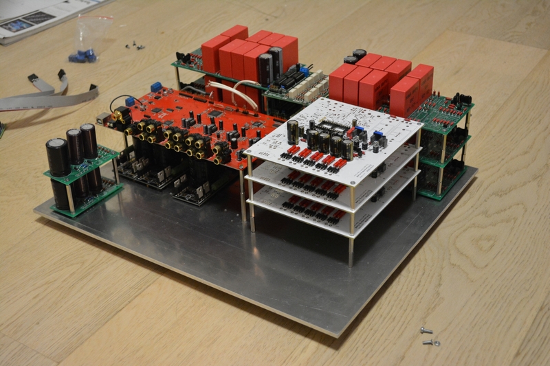

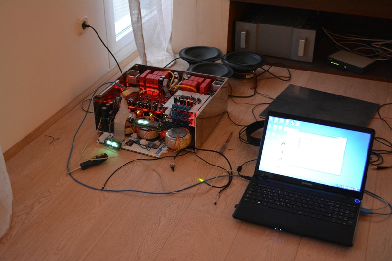

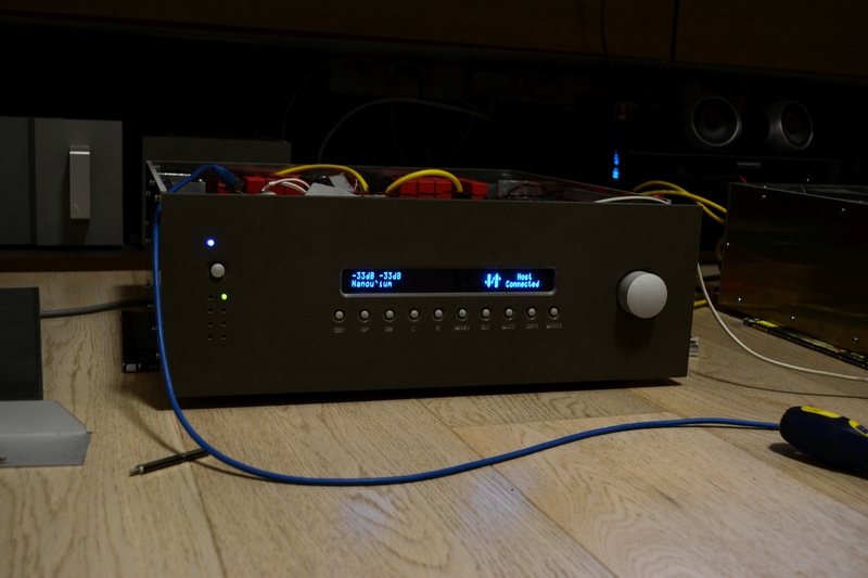

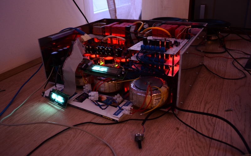

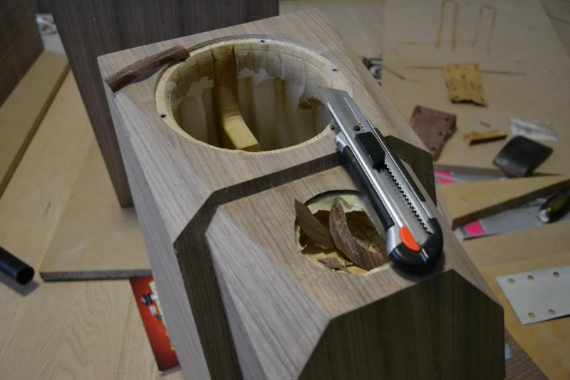

here are some pictures
of loudspeakers in progress, najda dsp...
