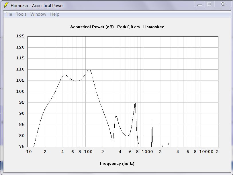

Hey guys I want to know why there's specific resonance spots in my room with some frequencies... yesturday I was outside with my 2 THAM12, I set the EQ to fla the responce... I worked with the spl and everything was ok, not perfect but near.... now I'm in my room... I'm listening Californication_RHCP and it's really bad!!! Here's a drawing of my room... It's not the right dimenssions but it's just to show you where I got this nasty resonance! almost every place in my room got a little bass boost! but in front of the subs (the rejet line in front on the subs) there's no bass! it's hard to explain... english isn't my primary language! at 1 feet these bass but at 1M there's not! it's only the first meter in front of the sub but I think it's the enclosure that blocks... Maybe if I post a video you could understand better so I will do this tomorrow morning!
anyway... what can I do to remove this... More EQ? I can't make bass trap because there's my bed and my desk there... I would like to have a flat responce in my door too... but even when I EQ...some frequencies are stronger! I found this online...amroc - the room mode calculator when I enter my room dimensions (16X12X8) its about the same frequencies that resonnate that the site told me!

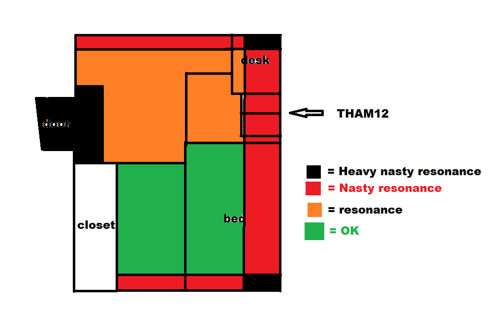

and sorry for my bad english if you need a video or a more detailed sketchup plans of my room I'll do it! I don't this the problem is the tham12's... It's the same when I use my 15's...

Inside a room, particularly a small one, the Room resonances DOMINATE response.
all you can do is move the enclosures (either coupled, or disperesed) around the room till you optimize the response at your desired listening positions. the frequency location and magnitude of the resonance effect will change as you change the location of your listening position... so you really need to pick 1 or 2 spots where you will get things set up to sound "good"
Put the speakers where you want to listen, then move around and listen in the proposed speaker locations.
Move the speakers into the location that sounded the best.
To expound on sine, a small room is defined by acoustic engineers as < 1,500ft3. Pretty much anything you do in such a room is just one big juggling act and in the end you will just have to live with some of it. Does not surprise me at all that the best sound is nearest bed and closet which are basically bass traps and also that the worst areas are in the corners where the rooms modes are most dominant. Something that may interest you is the Geddes Lee method. Which from my limited research, is using 2-3 subs in strategic locations in the room which effectively assist in "equalizing" the modes. Never tried it myself, but there are some fanatics. EQ can help but will need to be a decent unit so you don't carve too much out of the signal. One nice corner trap near desk might help a bit too.
ok so all I can do is move the subs until I got something better? ok I'll do this right now and after this i'mgonna do some testing 😛 I'll keep you informed!

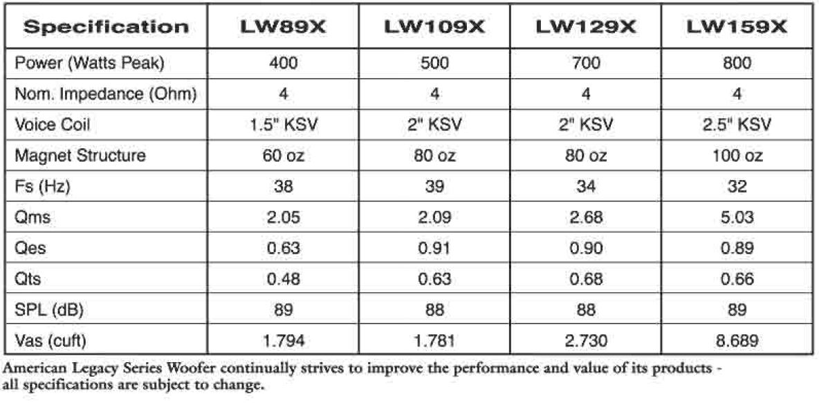

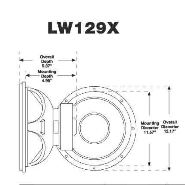

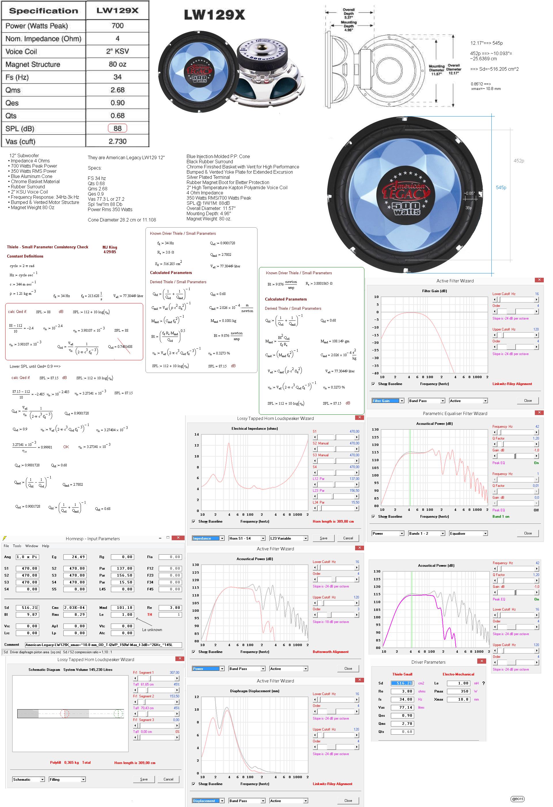

It's ok, seriously I'm a bit mad about the result but the woofer are SCRAP!!! Legacy LW129X see the picture for the specs!

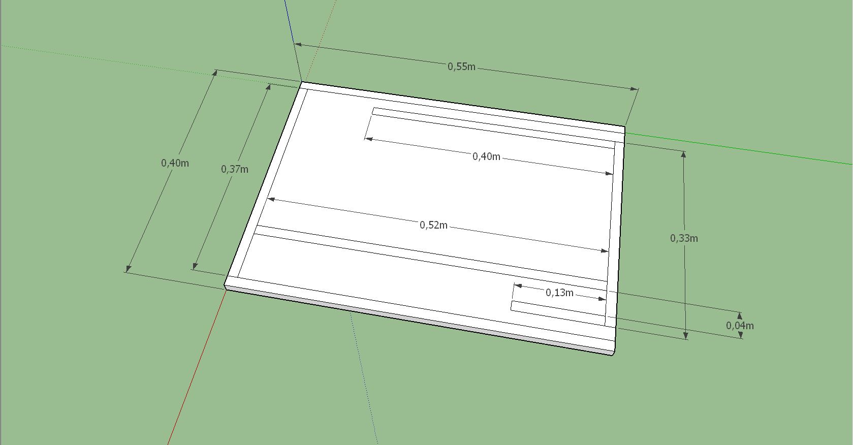

The front chamber is 17L tune to 80hz and the rear chamber is 70L tune to 29hz! It's my first Bandpass! so it was a try! It was not super on simultion but I change the 100L vented box because the woofer is so cheap that we can hear it moves! like a flapping noise! and I've try to seal it all the way and it wasn't better.
My goal was to get a got 40hz, the rest wasn't so important! see the simulation for details and there's also the plans! the box is 55cm tall and 52cm inside! what you see is just the botton, on it these is all the 52cm high panel plus the top panel! it makes about 17L and 70L on back if I don't miss something! I know that 80hz on the sim was only 100dB but in real life, it's about 60dB and 50hz is about 99dB max! and for the 30hz, I almost can't hear it... at 130hz it's 110dB but for a such big box (for a 12") I don't want a good 130hz, I want I good 40hz!!!
I don't think that the box is the problem, in the Legacy brochure, they told to cut a 11.57" (29,39cm) hole for the speaker so I did it and the speaker was almost falling down! It was too big! so maybe all specs are wrong? THANKS for your help, maybe the problem is small.

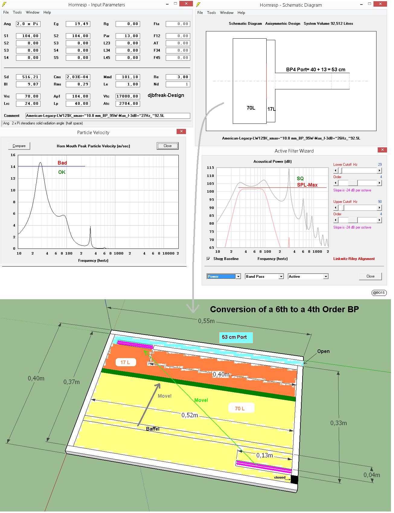

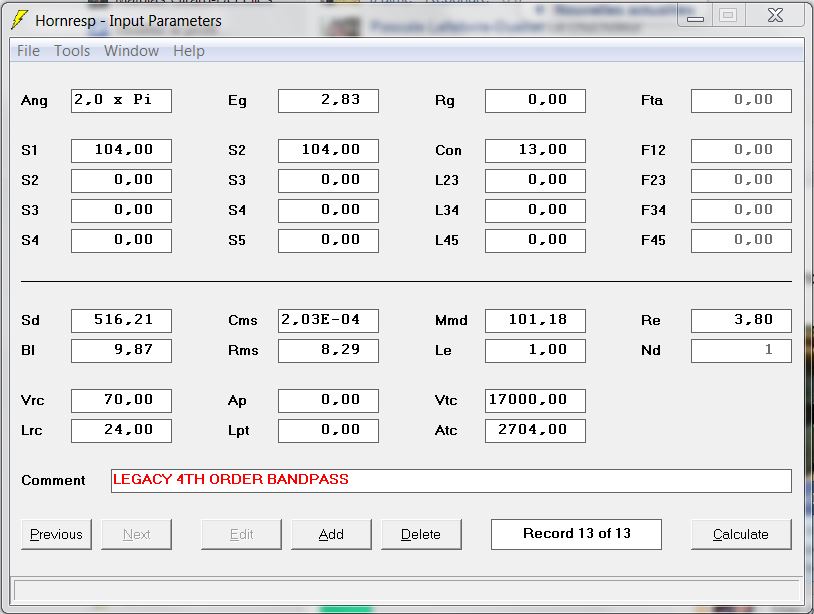

Hey I've sim the same box without the rear port (to make a 4th order) and it's about the same! there's no "peak" at 40 like with the 6th order! but Hornresp is more precise than WinISD so tomorrow I'll see what it gives me without this rear ports! hope I can get the 65-90hz frequencies flat with the rest of the bandpass!! I'll keep you inform 🙂

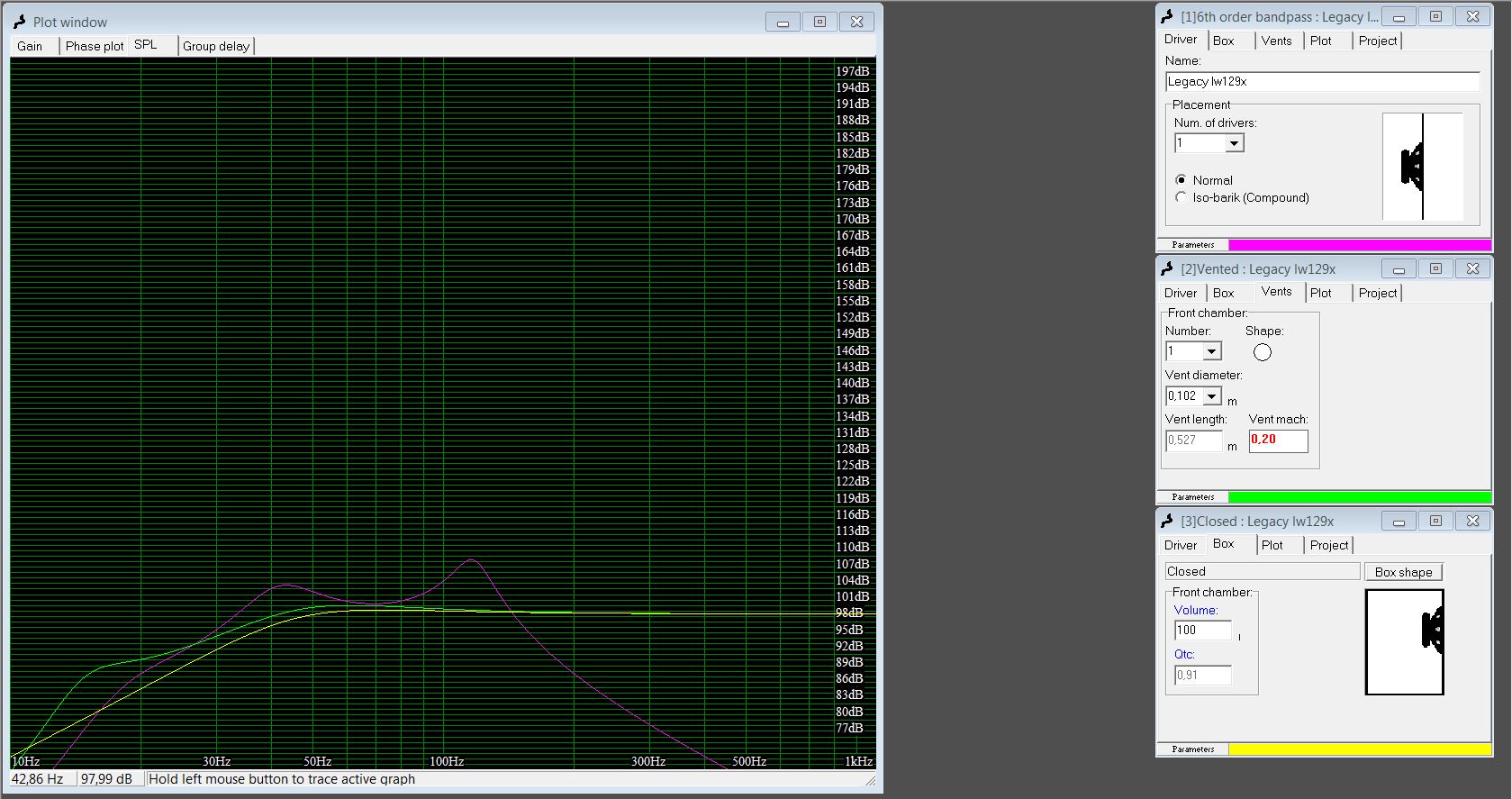

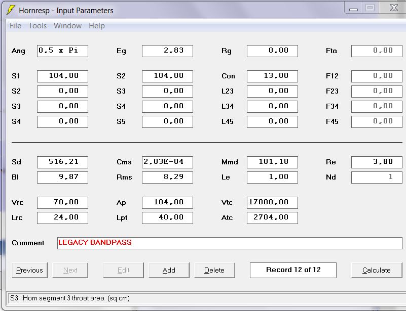

so here's what I got in hornresp, I'm new with the bandpass enclosure in hornresp so maybe I maybe I made a mistake! it's in quarder space because I forgot to change it! I think tomorrow I will go outside and make real mesurements! I will seal the acces panel first to be sure I can get every little dB out of this box! the woofer it self doesn't have a high SPL ( like almost every car subwoofer,sometimes 400$ carwoofer doesn't have a strong SPL) so I can't exept to much form a 78$ driver! when the acces panel is open, the bass is stronger in the 60-90hz range but it's not a bandpass anymore...so maybe the problem is in the front chamber?

Are you sure your 4th order BP is reflected by your Simulation?
Your latest Posts Picture of FR graphs don't match your Input Screen Data.
Be serious..Post a valid Picture of your changes of the here depicted:

ohhh and BTW my last poat were the input for hornresp for a 6th order Bandpass! sorry I didn't precise!

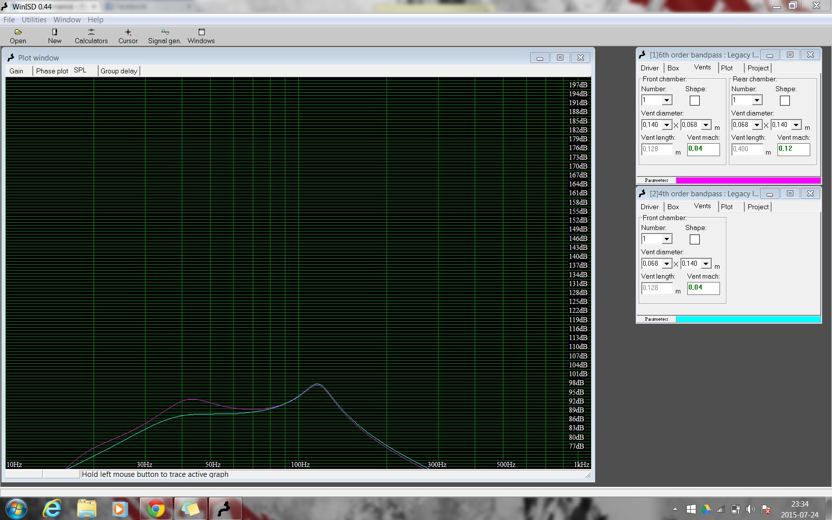

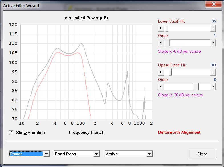

so here it is! THE SAME BOX BUT I'VE BLOCK THE REAR CHAMBER PORT! 🙂
I've sim it with winISD and hornresp
