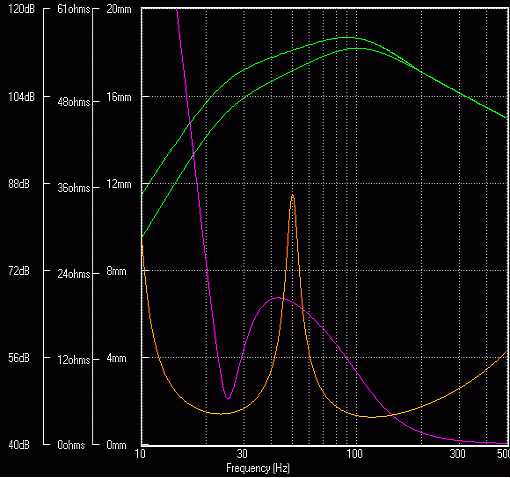

Just for the heck of it, here is a simulation of a Peerless XLS 12" , (3.5 ohm Re), in a 1 cu ft box tuned to 25 Hz. 28.3 volts driven, (app 200 watts for a 4 ohm speaker). This simulation program is Subwoofer Simulator with Serow's room gain file added.
Upper green line is response with room gain.
Lower green line is response without room gainl
Orange line is impedance.
Purple line is cone excursion.

According to that graph, a crude transfer function is 2db/octave, and my anaechonic design averages 3.3 db/octave below 100Hz which means that, although not perfect, it helps a bit in flattening out the overall FR.

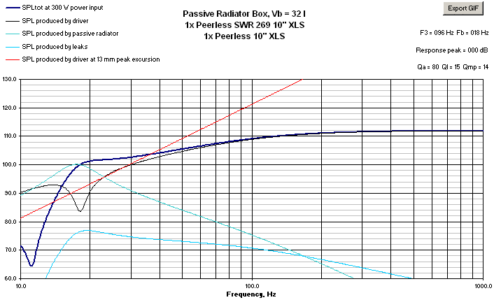

KW, funnily enough, I'm designing for a 10" XLS and 1 passive.
Bill, I'm well aware, but better to have some approximation included in the design then none at all, as room gain will always be apparent.

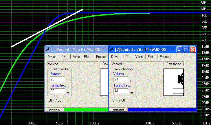

Whilst i don't disagree with your findings overdamped bass
reflexes can emulate the slopes of low Q sealed alignments
in regions of the bass, I don't think its a simple reflex versus
sealed issue.
The white line has a slope of 6dB octave and F3 is near 50Hz.
🙂 sreten.

To be honest, I have no idea what 101db at 20Hz sounds/feels like. I'm currently using two Celestoin AD12's and I know they cut off very high (plus only 3mm xmax), so I think it will be quite some change.
In regards to it being enough, my question is can I get more out of this combo?
Vikash:
Well, I heard 101 dB at 30 Hz, which is supposed to be more hearable than at 20 Hz, (your hearing declines rapidly in bass region), and I must admit I wasn't all that impressed.
Anyway, here is that thread on using two passives instead of one with an XLS 10. You might want to Email some of the contributors, as well as the thread starters, to see if adding another is worth it.
