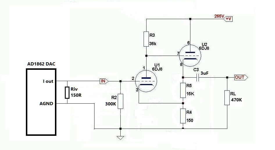

Hi All,
I've read somewhere that placing a small value capacitor in parallel with the plate resistor or a capacitor in between the plate leg and the cathode leg can roll off the highs, can it be used as an ultrasonic filter so very high frequencies will be blocked?
if so how can I calculate the capacitor value to block frequencies above 100khz?

In this link it's shows that the capacitor is in paralell with the resistor, should I still use your formula or a different calculation should be made?
it's a DAC tube output stage

Correct me If I am wrong, but what you need is a Low Pass Filter.
A single pole filter will only attenuate by 6 dB/Octave.
-3 dB @ 20kHz, about - 9 dB @ 40k.
-1 dB @ 22.05k, - 3dB @ 44.1k
Etc.
You might want to use a multi pole filter, like so many CD players use.
A single capacitor is not a multi-pole filter, except in certain more complex circuits.

If you refer to *this* image (half a dozen in that link),
one end of the capacitor is tied to tube plate, the other is *always* grounded 😱, either straight to ground or to the +V node, which for all purposes IS audio ground, since it´s decoupled to it.
Only extra detail to consider is that the "R" used in the formula is the generator source impedance, which in this case would be the load resistor (220k in the example) in parallel with tube internal impedance,conventionally around 68k , so combined source impedance to use in calculation will be around 40k.
The design site linked above considers "pure" resistance of course, driven by a perfect generator.

(Sample)RC Low-pass Filter Design Tool - Result -
Consider 10nF across the 150R (-6dB at ~105kHz), SMD type between grid pin and grounded centre spigot on socket would have zero lead length, which is desirable at HF.
HK
Formula for a value of grid stopper is not so easy, in practice there are many variables, you can reduce tendancy for oscillations with component layout.
Search forums for tips on this and you will find lots of helpful information.
Before resorting to grid stopper, try ferrite bead over socket pin and SMD capacitor from top of socket pin to grounded centre spigot, zero lead length.
