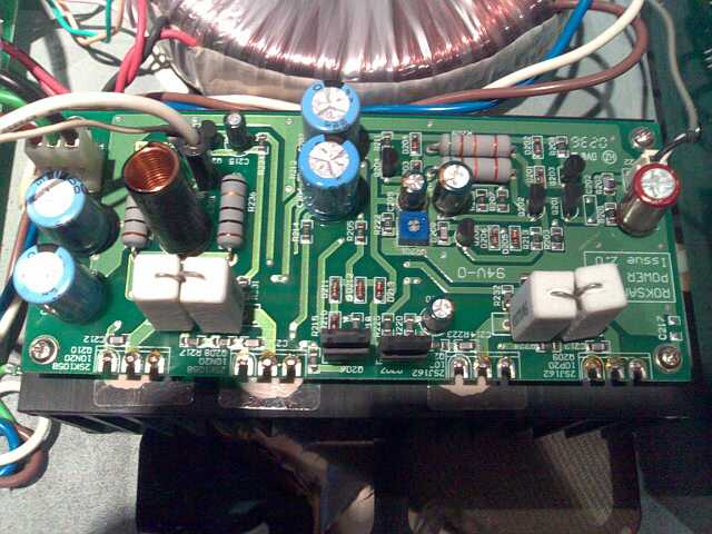

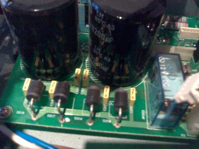

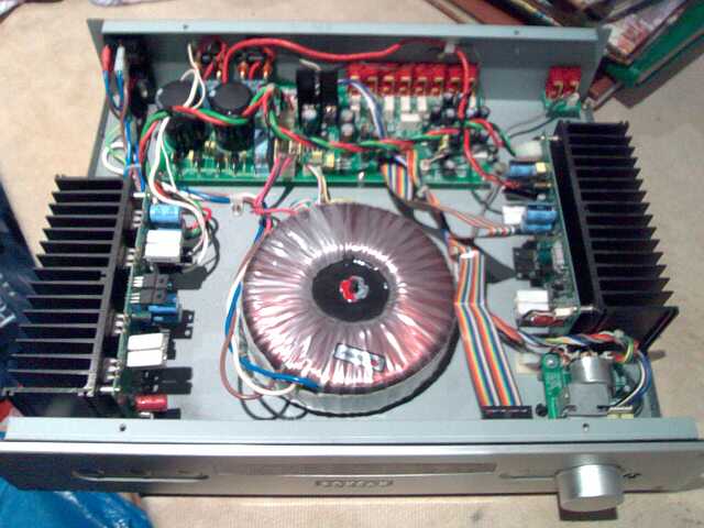

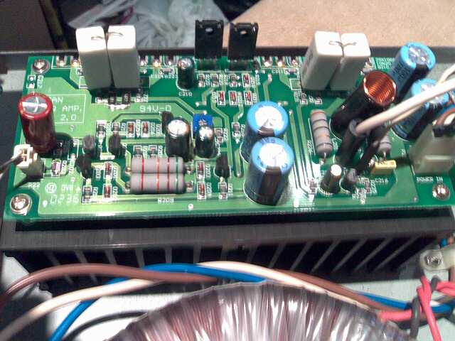

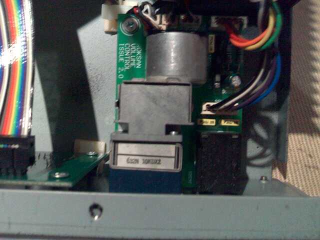

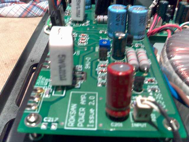

Apologies for the quality of pics. All taken and posted via mobile phone.
The amp looks and feels solid and well built with a solid chassis and a huge torroid.
The power amps are on seperate boards for each channel but the pre sits right next to the psu section.
All the sockets/terminals seem solid and good quality and the pot is an Alps(blue? The code on the side is ro295).
The bridge diodes are quite hefty and have HER 607 printed on them. Any use upgrading?
The voltage regs are the usual L7805,7812,7815 and 7915.i'll probably change these to LM317 etc at some stage.
My main issue with the amp is the caps.
Although there are 2 elna cerafines(one on each power amp module) the rest of the caps are 'teapo' manufactured.
A quick google has led me to believe that these aren't much cop, so these will be my first replacement.
I've seen some good diodes to try out after the caps, then i'll try the voltage regulators and see how far that takes me.
I didn't take a look at the output transistors as i don't have any heatsink compound to hand for the moment.
Any thoughts? The psu caps are 8200uf 80v and i was wondering if it was worth raising this to 10000uf?
Also, these are 12 caps in the pre section that don't have polarity markings. They are rated 100uf 16v and have 'pre 5n-a3 np' on the case.they are the same rating as the cerafines but are bigger.
Would these be bipolars?there still seems to be polarity markings on the board.
Thanks for reading.

Compared to Arcam etc and other British Audio companies its unusual not to have 1 big PCB and very little internal wiring. Well maybe buying 1 soon but after a demo.
