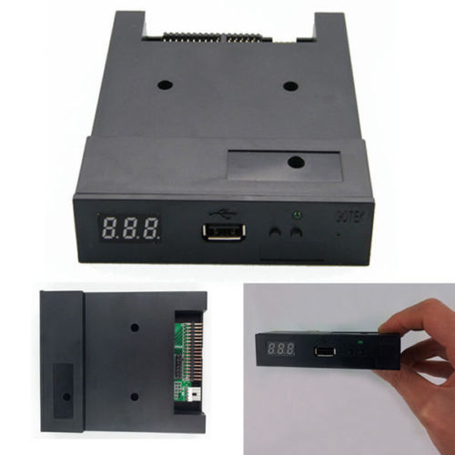

If the problems are a motherboard issue, I'll have to just leave it powered on 24/7 on a UPS, to maintain the setup. But I'll need to find an alternative means of writing files. Perhaps I can install some sort of USB port that I can stick a USB thumb drive for access?
Can thing like this be usefull: USB floppy drive emulator (there are a lot of them on ebay)?:
