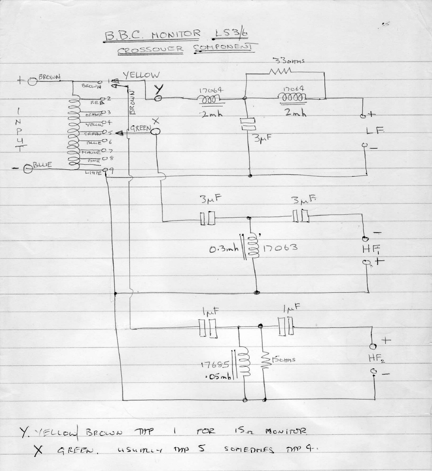

Can anyone verify the schematic for the Rogers LS3/6 crossover xover? This is a screen capture from Haycross Audio reverse engineered schematic.

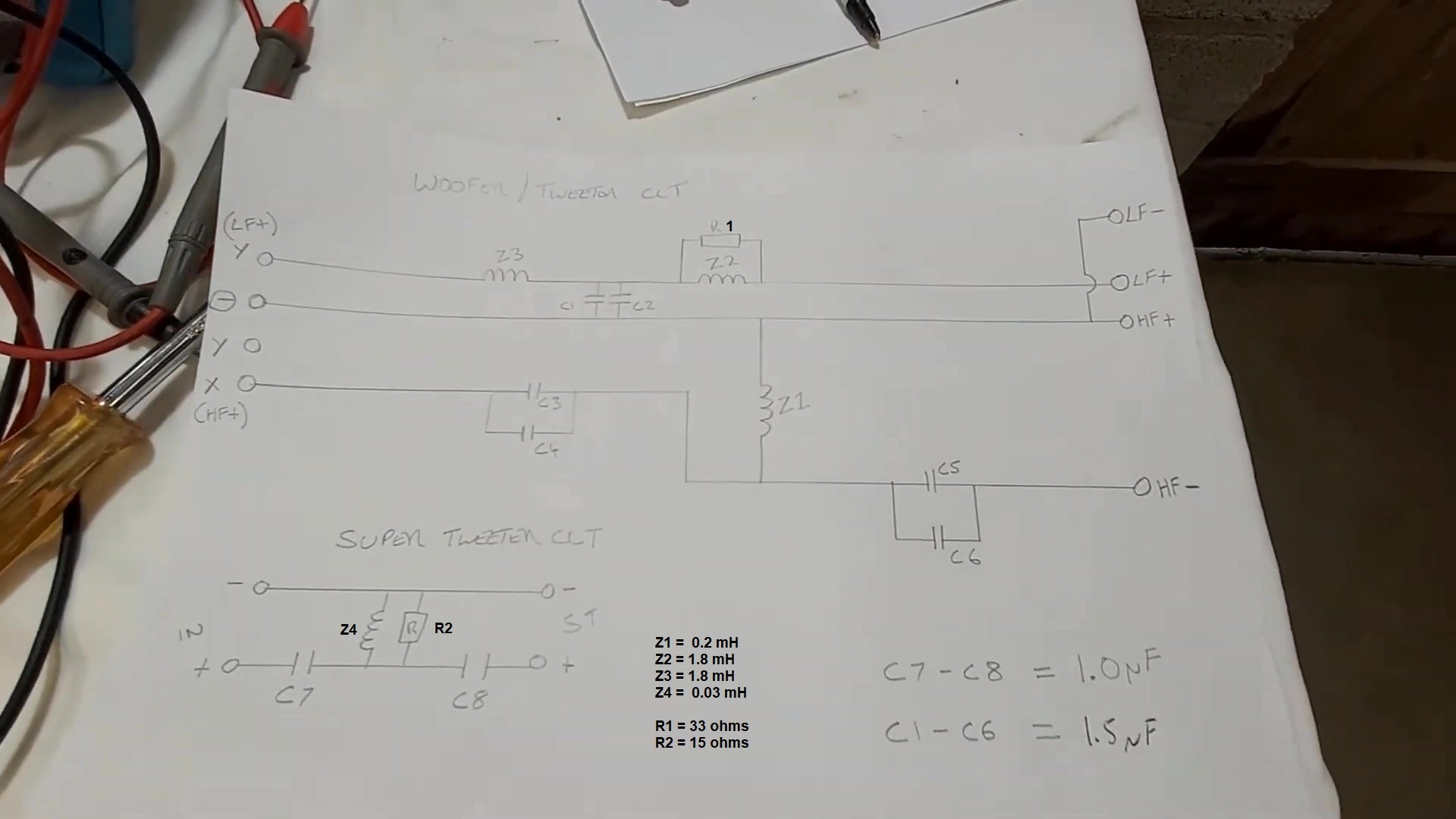

This one is from Mark Hennessey and also appears to be reverse engineered. The inductors have catalog numbers, so the values may be based on the catalog entry and not a measured value, as in the Haycross version.

Not sure if this schematic can help you? It appears that this may be a clone design from a guy named Alberto Bellino. The link I am providing is in Italian, but using google allows me to switch to English conversion. https://www.tforumhifi.com/t2358-aiuto-per-cross-over
