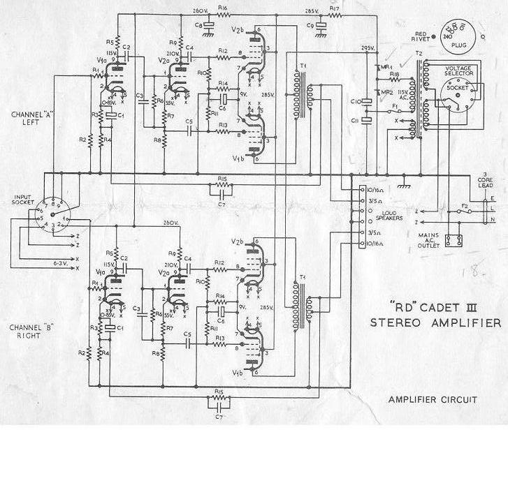

G'day from Down Under,

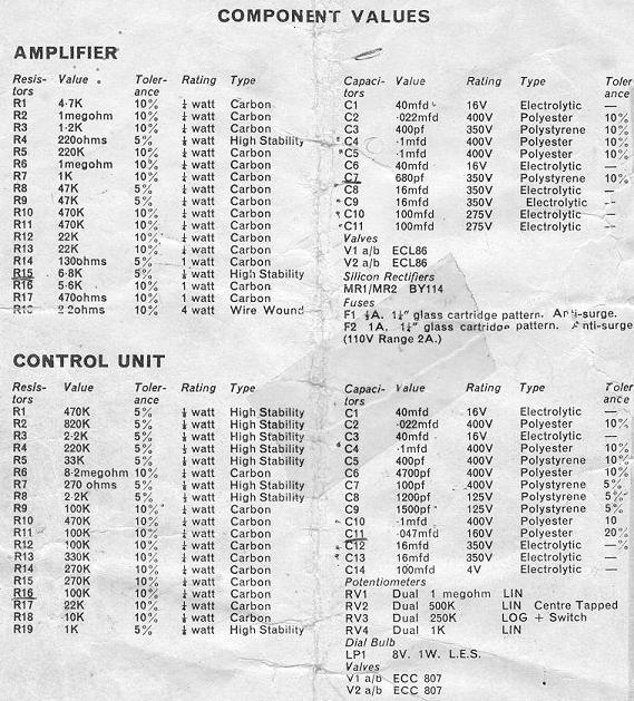

The parts list and schematic are on the last couple of pages of the User Manual. I don't think a Service manual exists.
Do a search on "vintage hifi manuals" or similar. I bought my original copy of the manual from the UK for 5 pounds.
As I was doing a full restoration I thought it was money well spent (especially as I had to pay 20 pounds for ECC807s to finish the job).
If you have no luck then email me and I'll arrange to get the manual photo copied and will post to you. Note the schematic is one of those with no component values just component numbers - you WILL need the parts list as well as the schematic.

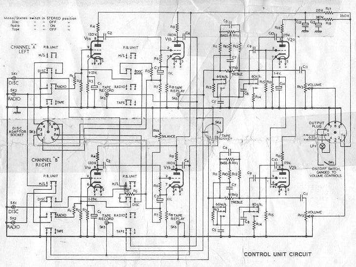

Hi needlesview,
Strange as this may seem, I have a set sitting on my desk right now. Since I seem to be getting regular requests for these schematics, I thought I'd best do several copies the last time I was asked. Drop me a line via the link below.
The parts list is on the back page of the manual. I can also send schematics for the PU adaptor to be adapted for magnetic pickups.

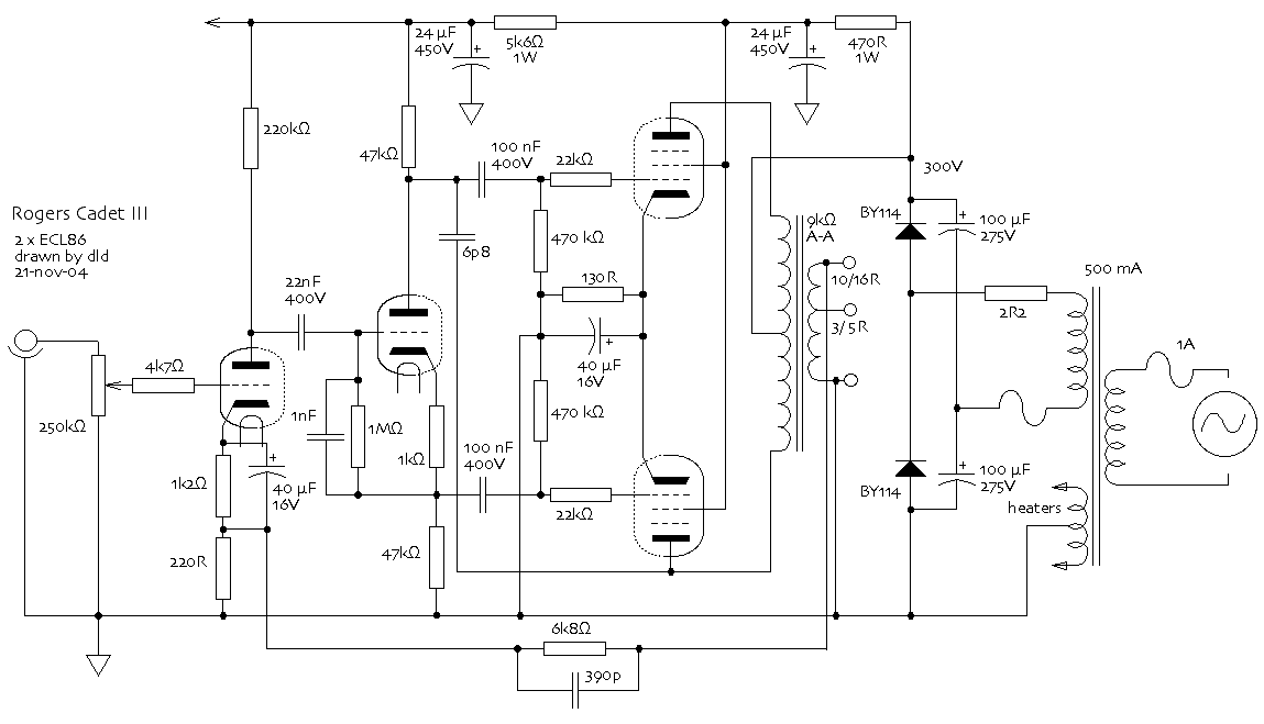

I posted a diagram of the power amplifier on this forum. This is rather embarrassing; although I can find it by doing a search for Rogers Cadet and putting EC8010 in the user name of the search field, I don't seem to be able to cut and paste a valid URL. The diagram is on the second page of the "Suitability of ECL84 tubes for audio" thread.

EC8010 said:Apart from the 999V across the 450V electolytic, it looks fine!
fixed... anytime you see 99...9 on any of my docs it is an unfilled placeholder.

I'm building a Clone of the power amp section at the moment as a little "bedroom" amp.
I've used Ultralinear connection to the output transformer.
Can anyone offer opinion on the advisability or otherwise of using separate 270R cathode resistors rather than a common 130R for the output pentodes?

Using separate 270R resistors (plus associated bypass capacitors) is a very good idea because it tends stabilise anode DC current for each valve, equalising them and thus reducing out-of-balance current in the output transformer. Go for it.
Sorry about the dodgy quality of the scans. I've had to downsize them in order to get below 100Kb. If anyone wants the original jpeg files (or bitmaps if you're adsl) just email.
Paul
