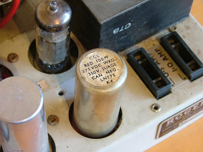

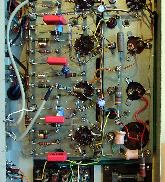

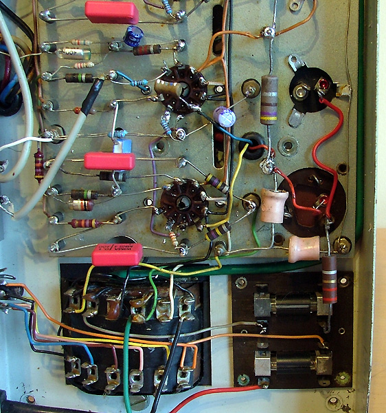

my amp and what it is

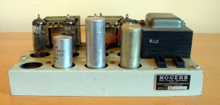

Hello Again
Right I have taken some fots of it, so maybe these will clear up what this amp is.
I hope these links work
Gary
no they didnt so i have uploaded them
Hello Again
Gary

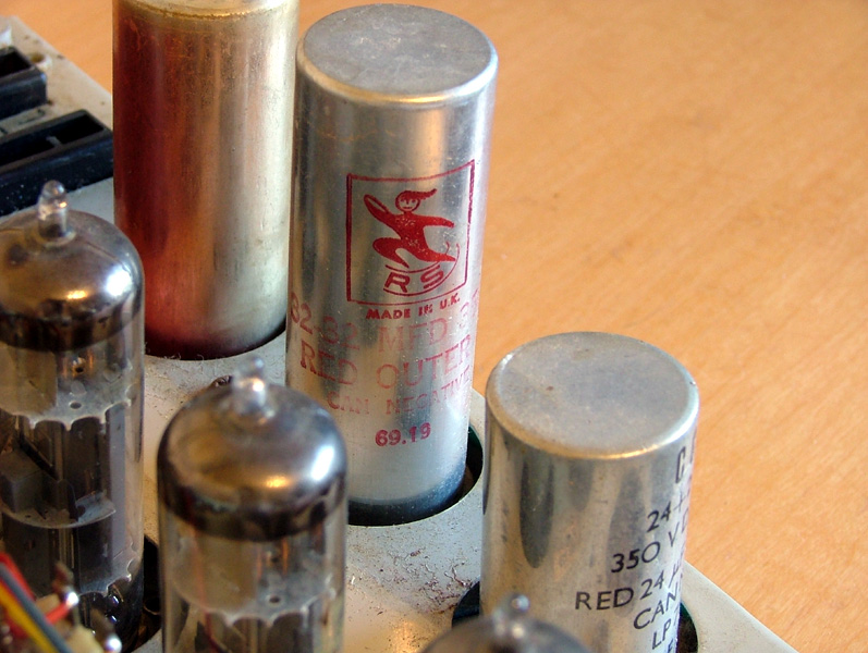

The 100uF is probably a dual 100uF. As with all older caps with non-insulated cans, the case is the negative, and the posts are the positives of each section. You can see negative lead (bare wire) joining each can's case under the chassis.
This applies to the 32+32uF and 24+24uF as well. So unless you can find similar dual cans to replace them, you will have to find a way to accommodate two capacitors for each dual can you replace.
JJ still market dual cans, but you would have to check the physical measurements to see if they will fit neatly (modern electros are much smaller than old ones).

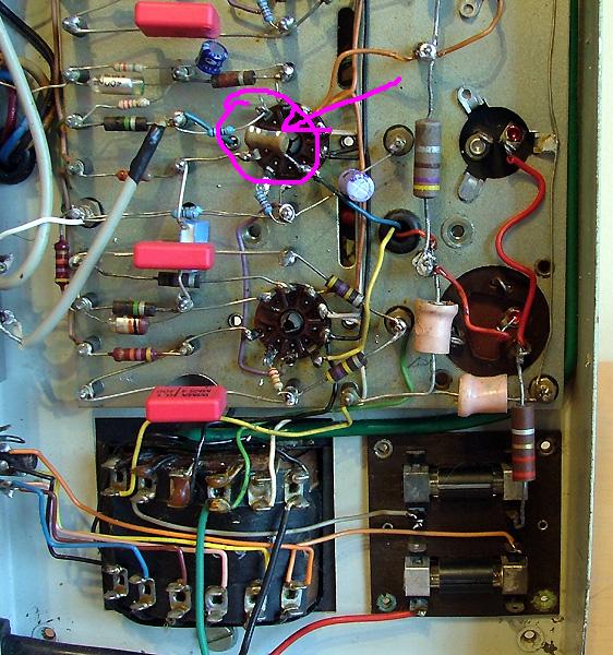

The 100uF can is a single cap, whereas the 32+32 and 24+24 are duals. As I mentioned in an earlier post, you can treat them as two separate capacitors with a common negative node. As rotaspec noted, the negatives for the three cans are the outer cans themselves (and the outer "legs" that are attached to their bottom).
I have edited one of your pictures and have added pink circles to indicate the negative nodes for each of the three cans (note that each can has three, but this is irrelevant - they are all connected to the can so you can treat them as one node).
It is worth also mentioning that, although the 32+32 can is a dual capacitor, only one of the two "segments" is being used. Notice how only one of the two positive "legs" (the one marked red) is actually connected to anything.
Now, looking at the pictures against the schematic, I think that:
C10 is the 100uF can (the one with the plastic base)
C11 is the part of the 32+32uF that is being used. Notice that its positive (the "leg" marked red) is connected to the negative of the 100uF. Its negative is soldered to the ground, where the back end of the MR2 diode is also soldered, in line with the schematic (the diodes seem to be the two deformed looking pink things, that are connected to the end of the yellow wire that goes into the transformer)
C8 and C9 are the two parts of the 24+24uF cap.
Does this make sense now?

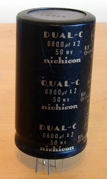

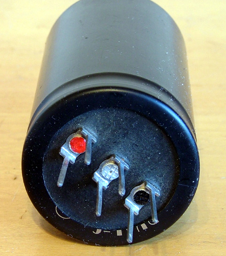

Just a couple of notes. If dual electrolytic can type caps need replacing it is often better to leave them in place, cut the connection to them, and use single units under the chassis as replacements.
If using replacement dual can caps, one of the 2 caps will be on the "outside" and one will be toward the Centre of the can. The outside one has better cooling and should always be used in the higher ripple current position which will be the one closer to the rectifier output.
That is for example:
Rectifier => Outside Cap => Dropping Resistor(or choke) => Inside Cap.
Ian
Ian, while we have you here, could you please have a look at the picture below and let me know if you have any idea what the circled part is? It's not in the schematic and it was originally also there in my Cadet. (When I overhauled it it I got rid of it and it works fine without it.)
