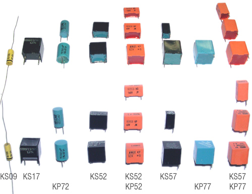

@peranders
I didn't mean those transparent axial Styroflex capacitors... They are available from different sources, mostly 2,5%.
What I meant were the little orange boxes with pins in two opposite corners... They were available as KS and KP, had 1% tolerance and the pin connected to the outer side of the foil was marked - so in your filter, you could connect this pin to GND and you'd have a shielded capacitor 😉
Those were really quality parts!
Here's a picture of the EMZ types

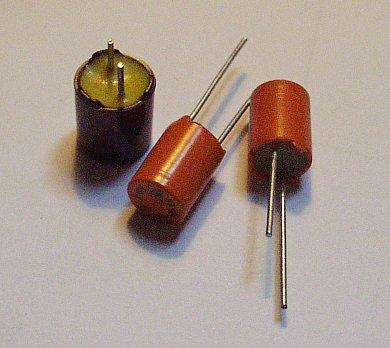

It's dark red with white label and it looks "old". The bottom is yellow and round.
Be careful with those - they often don't last long. They are in plastic cans, and are usually orange or dark red (photo attached). Some years ago the first job when you got a B&O L or LX TV in for service, was to replace all of them 😉
Frolyt in East Germany made a similar type in white plastic cans - they are terrible also.
Other ROE or Frolyt caps are generally fine - just watch out for the plastic versions.
