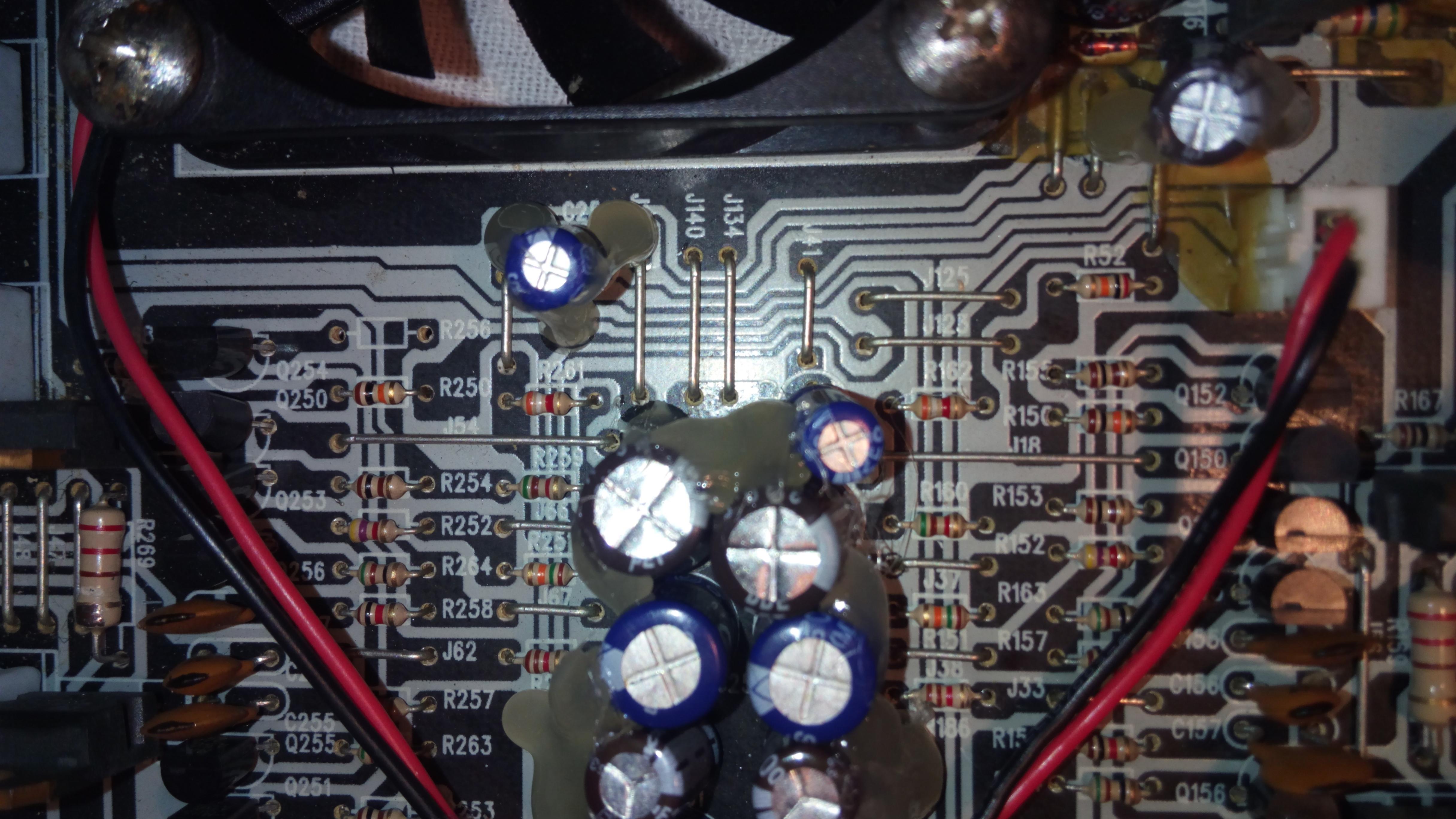

This amp go to protect sometimes, then turn HU off and on i amp power up without problem. And this is only when car motor is runing. On key off, amp dont go in protect. But, few days earlier amp go to protect independently of motor runing or not, and can't power up amp with key off/on. I disconect the power wire, ground and speaker, and nothing changes. Move ground wire to another places and still same thing. Sometimes it power on and runing nice but in most cases it go to protect. I notice a strange boop sound from woofer when amp go to power on, and same thing on power off, when it's working. 😀
So i decide to open amp and check whats hepening. It have tl494cl IC, jrd4558d opamp, irf3205 mosfets, and tip35c and 36c transistors and u1620 and u1620r Rectifiers. I have a bad ground connection on rca's and not good connection on one leg of 3205 fet. Amp didn;t go to protect. One day its plaing nice and over night still the same thning.
Opened amp again. Check everything and i dont find a problem. Disconnect rectifiers and 35/36c tranzistor, power on amp and got protect mode. Put it back on board and amp turn on like charm. It's working about a 20-30min and amp everything was cold like an ice cream.

Today i replaced all caps in the board. Powered amp from pc power supply (11.9v), let it run about 20-30min. everything is cold. I have 11.9v on fets, 37.5v / - 37.5v on rectifiers, and 37.5v/-37.5 on transistors. Is that ok voltage for this amp?
The caps were almost certainly not the problem but if you removed the brown fixative that was in contact with other components, that could have fixed the problem.

Sometimes its shut down on 12v, but on 14v on first start always go to protect. Then with HU swithing off/on, amp go to power on. 2 or 3 days before, it stays in protect on engine off 12v, and engine on 14v.
What can i do next?

Reinstall it in the car and see if it does it again. If it does, get the 494 voltages while in protect.
Before reinstalling it, you may want to try pushing on various parts of the board with a non-conductive probe to see if it will go into protect.

And what i forget to say, phase control was apparently bad soldered, becouse all 8 legs of phase control, if i remeber right, have shorts between solder on board. Someone change phase control switch and do it bad. 😉
Ok. amp works well in car on 12v and 14v. Then sudenly go to protect on 12v and same one 14v. Pull amp from car and put in power suply and have this messurement:

The attached diagram is similar in layout but the designations and values are different.
The first thing you need to be able to do is to make it go into protect reliably. Otherwise, disabling the protection circuit may not help much.
To disable the protection circuit, find and remove the equivalent of R25 from the circuit.
Do whatever you did to force the amp into protection. Does it work perfectly doing whatever you did to cause it to go into protect or does it malfunction in some way when it would normally be in protect?
Reinstall that resistor.
Look at the diagram. Find the equivalent of R375 and R475 in the two output channels. Remove one at a time to see if you can tell which channel is driving the amp into protect mode.
if i do it right its a r256 and r155 on my board. With r155 removed, no protection, only strange sound from the speaker. With r256 removed i got protection mode. Same with r154 and r255. So, with removed r256 i got protection. Same with r154. Thats resistors are for negative channel.
Are you sure that the corresponding parts in each channel aren't the same except for the first number after the R?
yes. i got protected mode from resistor r 154. if i folow trace from resistor r254 it will go to mps 160 transistor and then to smal box with screw for adjustment. I dont know what is it. 🙂
si its 154 and 255 on my board. both negative on each side of board.
