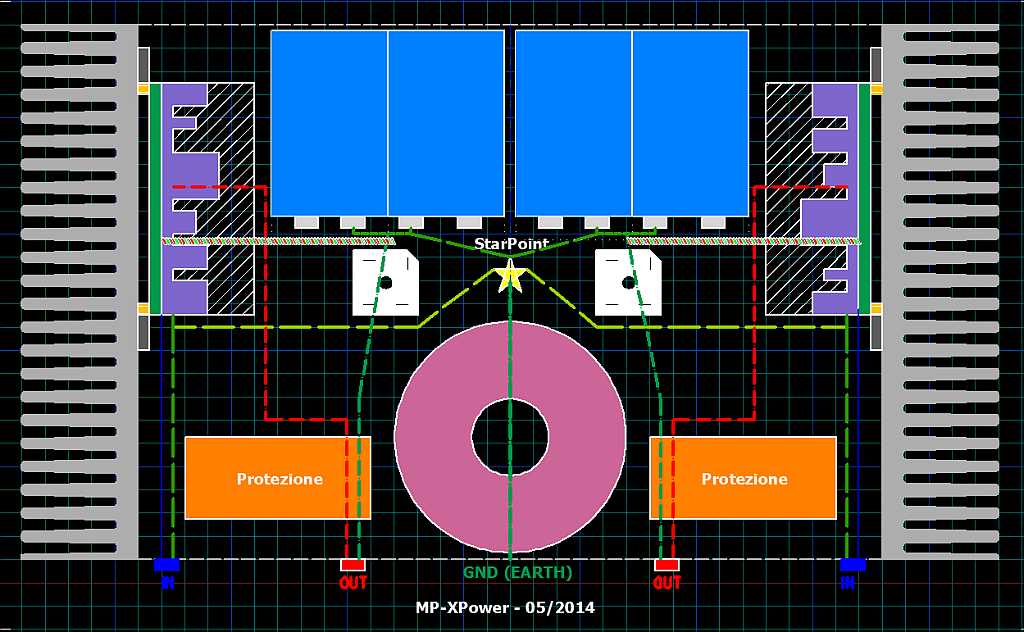

hi people, I just built my p3a and it works great but I have an huum issue...
if I short the input rca it disappear completely. the same if I connect only one channel.
This is the schematic of my layout, except for the star point
I used two bridge diodes; one DC protection for each channel, each protection is supplied in AC by the same secondary winding of the transformer (the same 0-24VAC supllies both the protections).
Speaker GND is taken directly from GND of PS, and also each protection GND and AMP GND. Input GND goes from RCA socket to AMP PCB.
any help will be appreciated

Hello cucicu
In principle it is not a good idea to connect the earth and the ground star sets.
Here are the rules I respect and never any noise problems.
- The earth connected to the case (and only that)
- The ground star (isolated chassis) for the gnd power and gnd loudspeaker
- Entries on the amplifier cards (hot and ground)
- Insulate the input and out plugs of the case.
regard's

Anyhow, based on what you posted... the input is where the hum is getting in since when you ground it there is no hum.
Can't remember what your circuit details were - you made your own pcb if I remember. Most likely the issue is
a) grounding problems - do you have a ground-loop breaker circuit i.e. back-to-back diodes between amplifer/signal ground and the safety earth (mains earth + chassis) ?
or
b) pick-up from stray electric or magnetic field in the chassis to the input wiring

Hello cucicu
regard's
HI Project16
I must say the earth is not connected.
The ground is not perfectly a "star" cause the GND connections go from bridges to PS pcb's and from there I hace 3 ground cables to:
-Speaker
-Protection GND
-Amp GND
-input and output are isolated from the chassis.
BIgun:
I used ALex mm layout for pcb. No gnd loop breaker on pcb

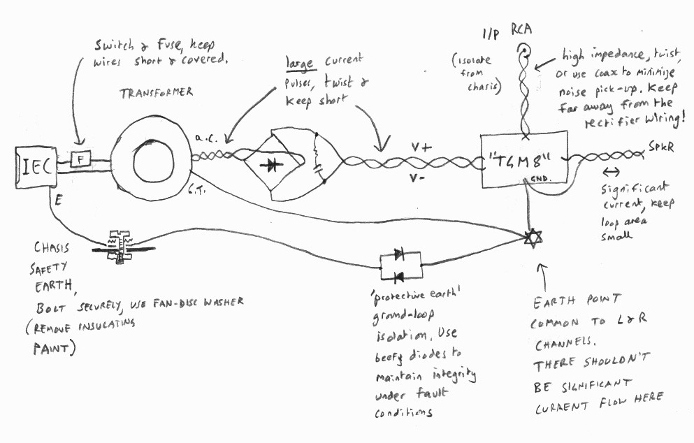

That works fine - thanks. A few comments....
Chassis layout looks fine to me.
If you have hum when the RCA is not shorted but there are no cables from a source plugged in ? - then likely you don't have a classic earth loop problem - i.e. one involving a source unit plugged into mains earth at a different wall receptical and connected to your chassis through the RCA interconnect. The earth loop breaker is designed to fix this particular problem. Can you clarify if you have hum when no source is connected ? - if you do then the issue is all inside your chassis.
Edit: no this isn't the problem, I forgot you said the earth isn't connected (that's naughty by the way)
Looks like input ground goes to the amplifier and then to star ground - running close to the trafo all by it's lonely self - better to have all wires in pairs and either twisted or be coax where the loop area is small.
Attached is a proposed wiring diagram I posted in my TGM8 thread to show the pairs of wires for twisting.
I made your proof and WITHOUT source connected (RCA not connected to anything and NOT shorted) I have NOT hum. dead silence.
my connections are exactly as in this picture you posted.
The input is connected by a shielded cable and ground goes from input socket (insulated) to IN+/- on the PCB. from the pcb I have only a gnd connection to the PS. from this same point on the PS I go to spkr gnd and protection GND.
the input cables from RCA to pcb are very short (about 5cm) and are not running close to the trafo
I'm tired after a long day so I'm not seeing the quick fix. In your picture the ground from the pcb's both go to star ground, but the speaker returns go to their respective capacitor banks - try moving the pcb grounds from the star point and join them to their respective capacitor banks so for each channel the speaker return and associated pcb grounds join at the respective capacitor bank. In this way, the star ground is really just the place where the L and R channels come together and each channel have their own star ground at their respective capacitor banks.
Could also try taking trafo out of the chasis - make some distance from the wiring, twist it around - see if it makes any difference - if there is magnetic induction from the trafo to any wiring you will find out this way.
Lets start with some order
From the picture you can see how its made
From trafo to the pcb with bridges. From there gnd goes to right psu and left psu. The psu are in parallel obviously.
From each one of these ps the gnd goes to amp, prot and spkr of the respective channel.
Maybe there is a stupid mistake or a double link I can't see.
It is certainly a loop because the hum disappears with only a channel plugged in the input and also with no input plugged in
