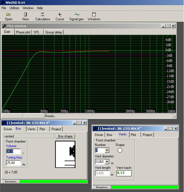

Looking around I found this one of 8" at a relative good price
JBL GTO 804
diameter: 8"
Fs: 25.6hz 🙂D)
Qts: 0.56 🙂dodgy: )
Qms: 6.15
Qes: 0.61
SPL: 93dB 😀
xmax: 9.5mm
Vas: 166 (is this ok?? for a 8" speaker??)
BL: 10.88T
300W RMS, 2x 4 ohms

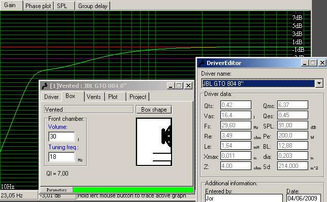

Sorry, I have to re-post because the small signal parameters were wrong in the page that I looked. From the PDF,
Fs: 29.6
SPL: 91dB
Qts: 0,42
xmax: 11,5mm
Vas: 16,42l
BL: 12.88
Fs: 29.6
SPL: 91dB
Qts: 0,42
xmax: 11,5mm
Vas: 16,42l
BL: 12.88

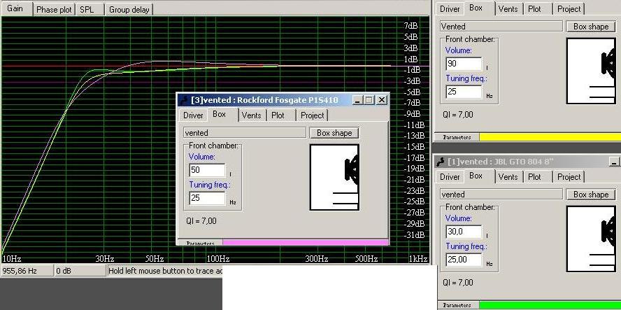

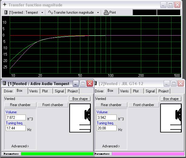

My advice to Zafira is to download winISD enter the various subs he has available into it and model each one against the other.
Also model one of the well recommended drivers such as a shiva or tempest and compare the curves to the drivers he has available.
For example the JBL GT4 'car' sub matches the response of the Adire Tempest 'home' sub right down to 18Hz, in a box half the size ! (I wonder how 2 of the 12's would compete against 1 of the 15's in similar sized boxes....)
Try tuning the JBL lower down, maybe around 18Hz. Will give a smoother curve. In the signal box type in the max wattage you think the driver will get and model the vent to have a low enough mach at that power.
I haven't got the jbl's specs in my winISD database so cannot put a screenshot up right now.

I cant find the "signal box" that you're talking about. Maybe because I have WinISD Beta 0.44 and you have a newer version?
With 18hz, i have a smoother response but -5db@20hz 🙁
In the attach, I put the t/s parameters of the speaker.
I really apreciate your help 😀
thanks,
Jorge.

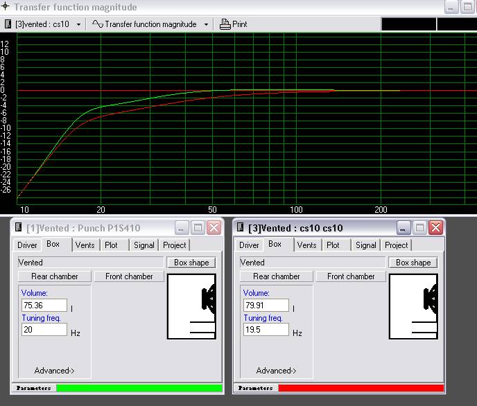

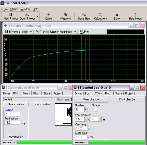

Hi again.
I'd still go for the biggest driver you can get that models well.
Here's a pic of the CS10 how I'd do it.
You can see the version of winISD I'm using at the top, and also the signal tab on the right hand box. You can enter the power applied to the driver and watch the mach change in the 'rear port velocity' window.
Have a search on 'room gain' to see why it's not bad to have a falling response, especially in a small room.
Rob.
Rob.

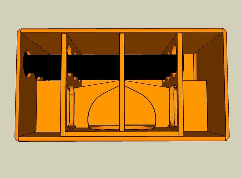

more questions...
Looking for subwoofer designs I found this one that has a division with lot of holes. Can someone tell me what is it for?
I've found really stranger designs.. like the second photo.

OK, I will look for "room gain". I cant see any pic, did you attached it?
If I have to go to the biggest model I can get, I have a 18" RCF L18P540 sub, it's really cool but it's giant for my new appartment, I used it in a 4m x 4m x 4m room with wooden floor some years ago, but now for this room I think it's useless, because of the bigger box that will result of making a bass-reflex for that speaker.
