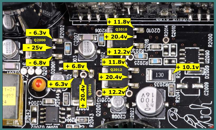

Hi all,
Amp powers up but no output.no oscillations on U2000 and U2002. Found Q2012 open. But I changed Q2001 and Q2010 as well. Also I changed U2000 and U2002. Now I am getting oscillations on only u2002. On driver board I changed 74hc ic also. Any help will be appreciated. Thank you.
Pin 6 is low. Check the voltage on the regulators.
Are any of the ICs on the class D driver board or the 5110s heating up?
The regulator transistors getting very hot. 5110 getting hot but not so much. Driver board is normal. I removed outputs out of the board just to make sure they are not leaky and pulling current.
Amp idles at 1.8amp. I just got all the voltages correct and with in a second they all drop. This happened only one time. Do you feel if main caps are bad?
