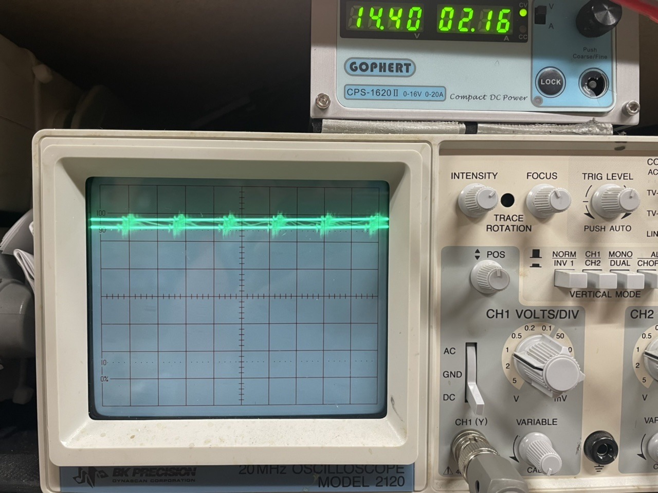

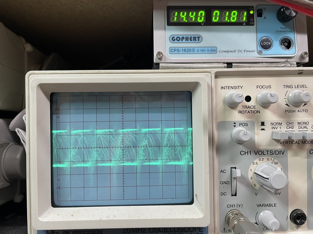

Yes there is a lot of ripple on rails. About 2.5v in fact. Makes me think, rail caps? Rectifiers? What do you think of this photo?

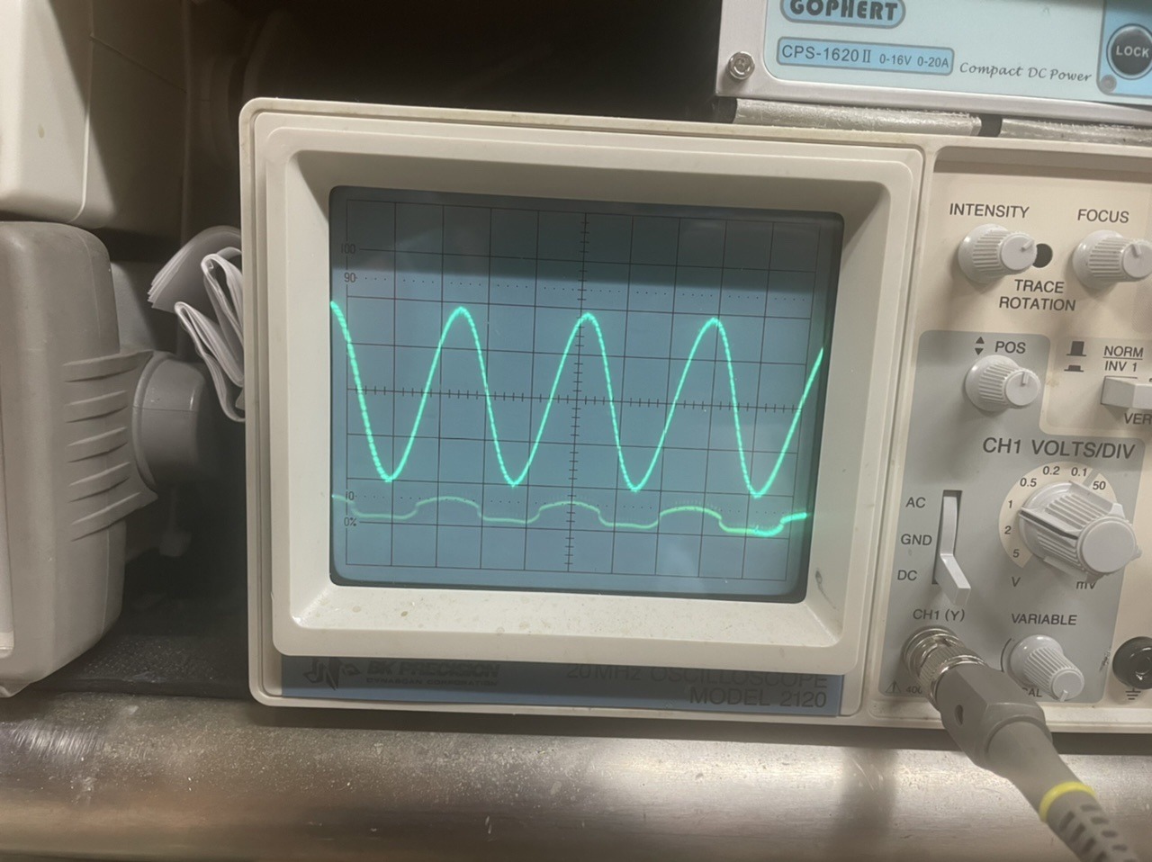

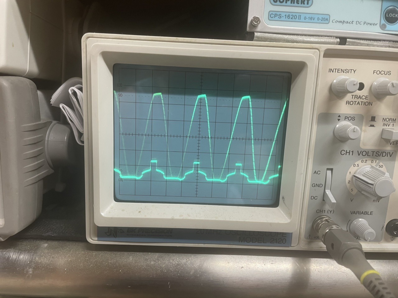

4-ohm bridged. 1khz sign wave. The bottom line is negative rail. Both probes calibrated. 10v/Div on DC coupling. First image is sign wave hitting clipping. Second is just before clipping. This is at 14.5v in put DC. Amp draws 45A at clipping across 2 channels. Left 2 other channels open no load.
