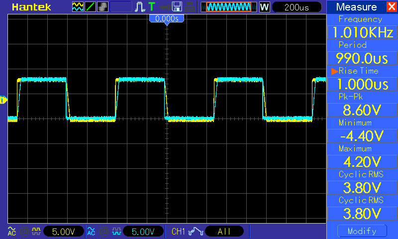

PIC121_3 is taken from pin 24 (yellow) and pin 16 (blue) of another driver module perfectly working.

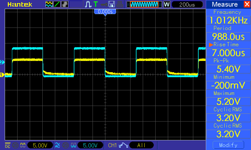

PIC121_2 is taken from pin24 (yellow) and pin 16 (blue) of this board.

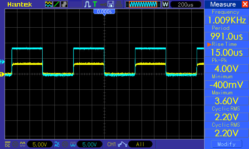

PIC 121_4 is taken from Q14 collector (yellow) and Q13 collector (blue).

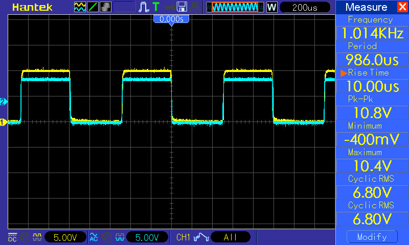

PIC 121_5 is taken from Q14 emitter (yellow) and Q13 emitter (blue).
