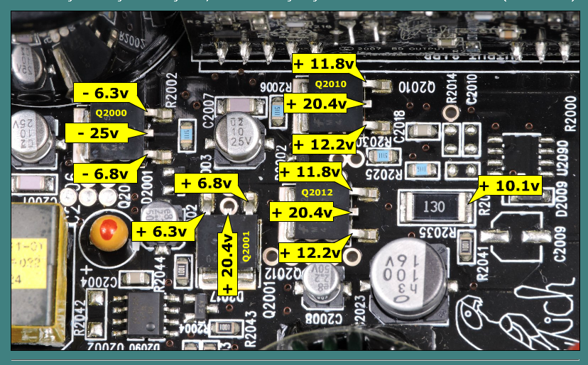

rockford fosgate t500.1bd
Are the regulator voltages approximately the same as in the attached image?
