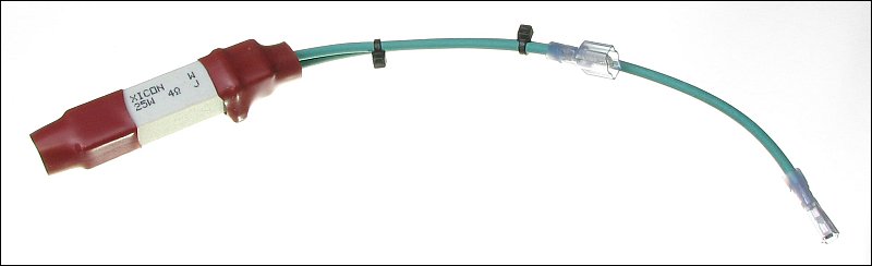

I removed Q401 for troubleshooting the driver circuit for that bank of outputs and powered the circuit. unfortunately i didn't have my current limiting resistor installed and blew that bank of outputs. Can i remove the blown bank and power the amp to troubleshoot the bank that is not powering up
The current limiting resistor in the B+ line would not have saved the FETs. There is too much secondary capacitance. When working on these amps, the only protection that I've found is either adding fuses or resistors in the red and blue wires.
You shouldn't power up any FET circuit with any of the driver components out of the circuit unless you know the circuit well enough to know that the FETs will be held 'off' when power is applied.
