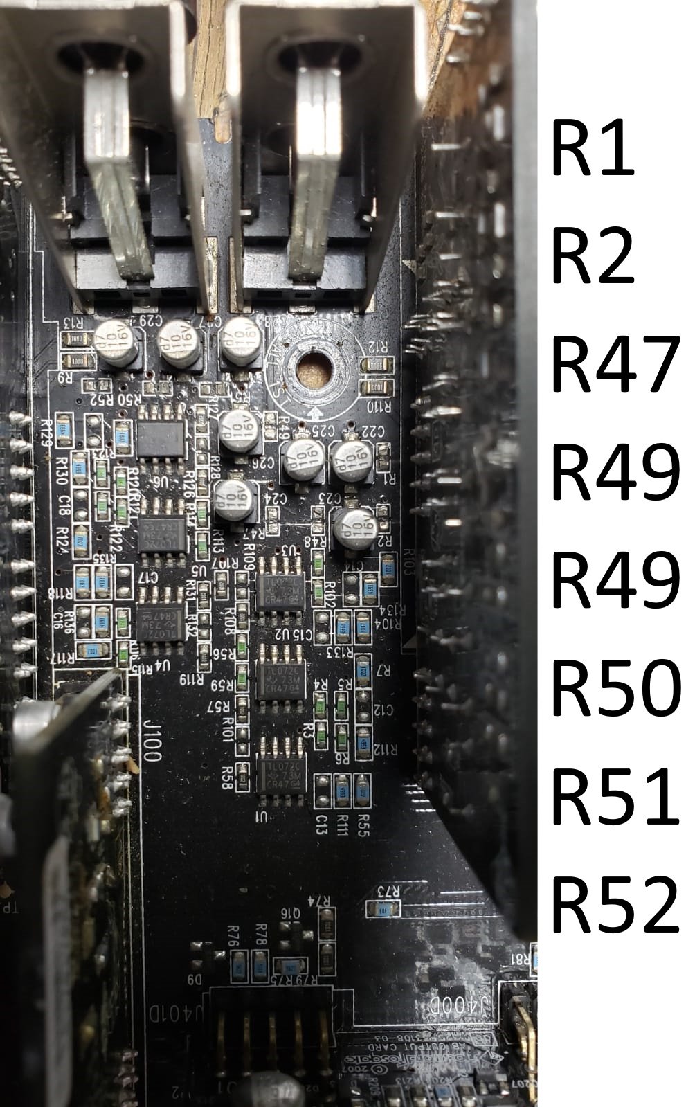

Checking a T400-4 and it seems that some resistors were removed.
Does anyone have the schematic or photos of the area near the RCA connectors?
R1
R2
R47
R48
R49
R50
R51
R52

There were revisions on many of the amps that told tech to remove various resistors on the input. They were typically from the shield and from the center-conductor of the input RCAs to ground. If those are what's missing, the problem is likely elsewhere. Have you operated all pots and switches through their entire range while listening for audio on the dead channels?

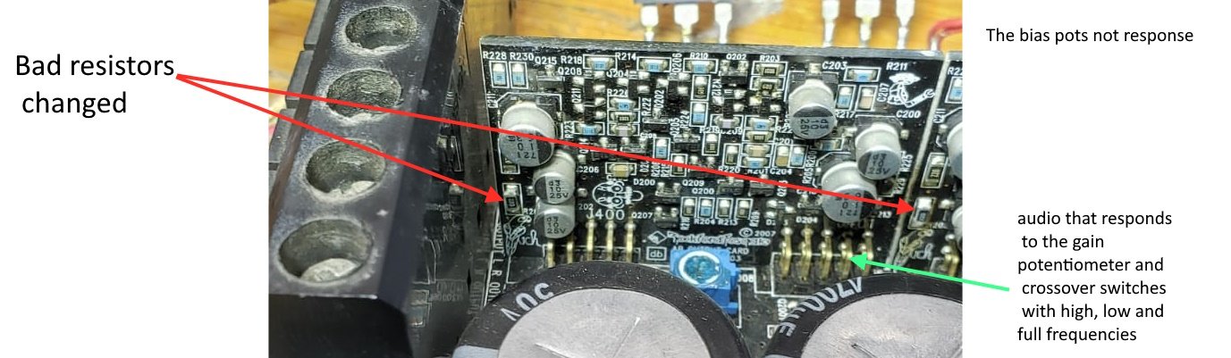

I find audio signal on a terminal of the driver card ab output board. And I detect that it responds to the gain and crossover switch settings and frequencies in all ranges. both in high and low frequencies.
I changed R202 22 ohms in two cards corresponding to the front channels
I add the comment: When moving the bias potentiometers of the 4 channels there is no response
Someone previously moved them

U100
Pin 1: .023
Pin 2: 12.07
Pin 3: 13.26
Pin 4: 4.97
Pin 5: 7.26
Pin 6: 4.97
Pin 7: 8.40
Pin 8: 1.363
Pin 9: 4.32
Pin 10: 3.85
Pin 11: 4.97
Pin 12: .022
Pin 13: 12.07
Pin 14: 10.64
U102
Pin 1: 10.40
Pin 2: 4.75
Pin 3: 13.27
Pin 4: 1.371
Pin 5: 3.80
Pin 6: .040
Pin 7: 8.60
Pin 8: .021
Pin 9: .020
Pin 10: .040
Pin 11: 8.69
Pin 12: .022
Pin 13: 10.39
Pin 14: .021
