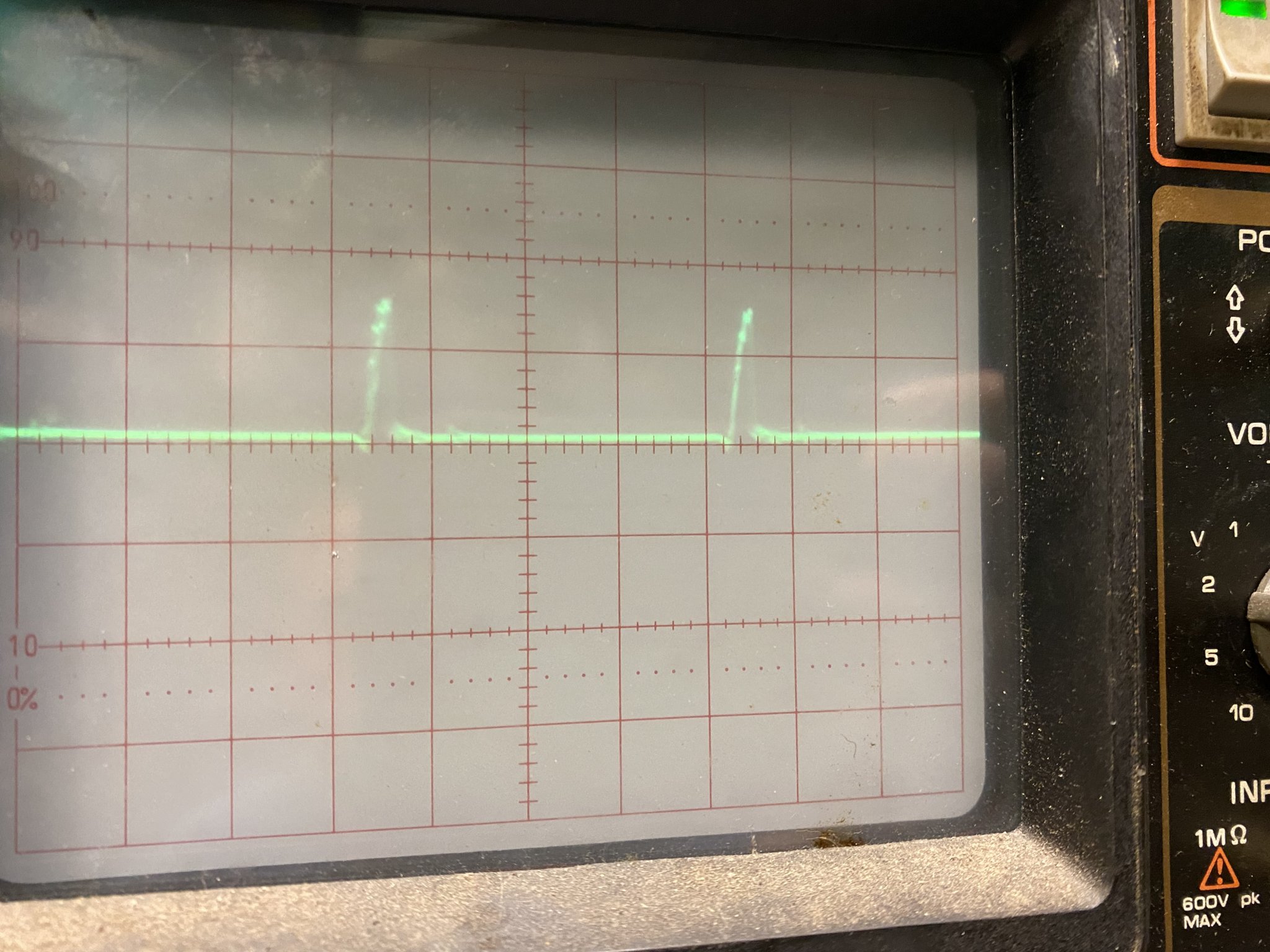

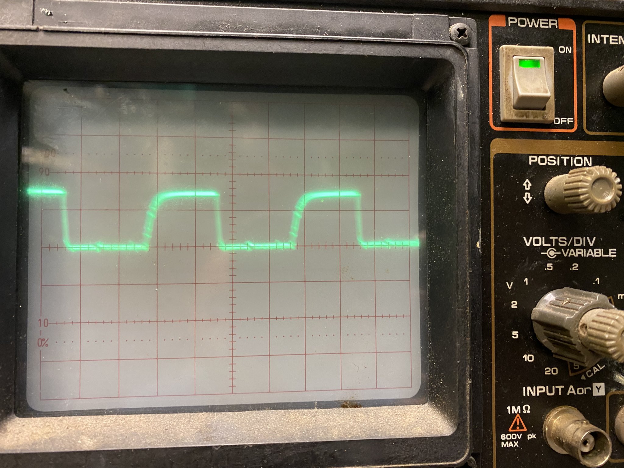

Pic 1 is of Q2014

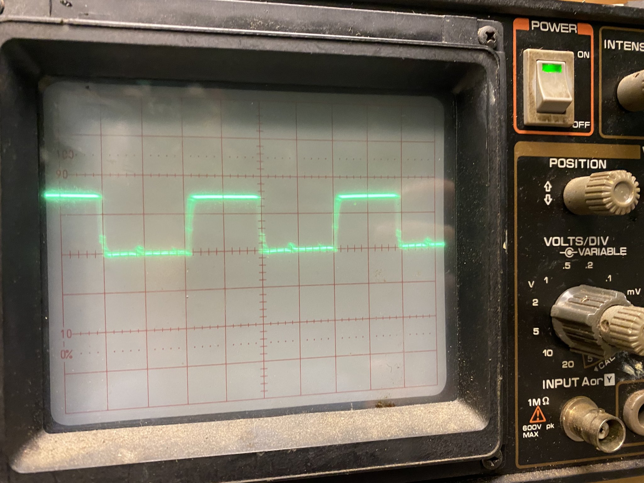

Pic 2 is of Q2013

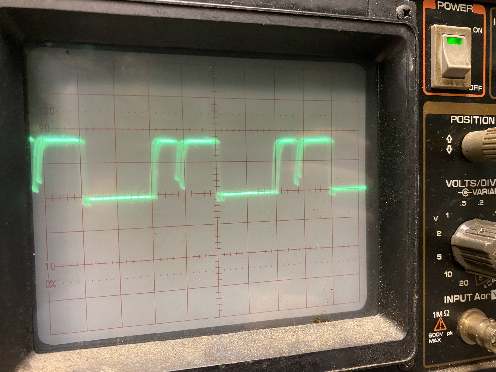

Pic 3: is of Q2008

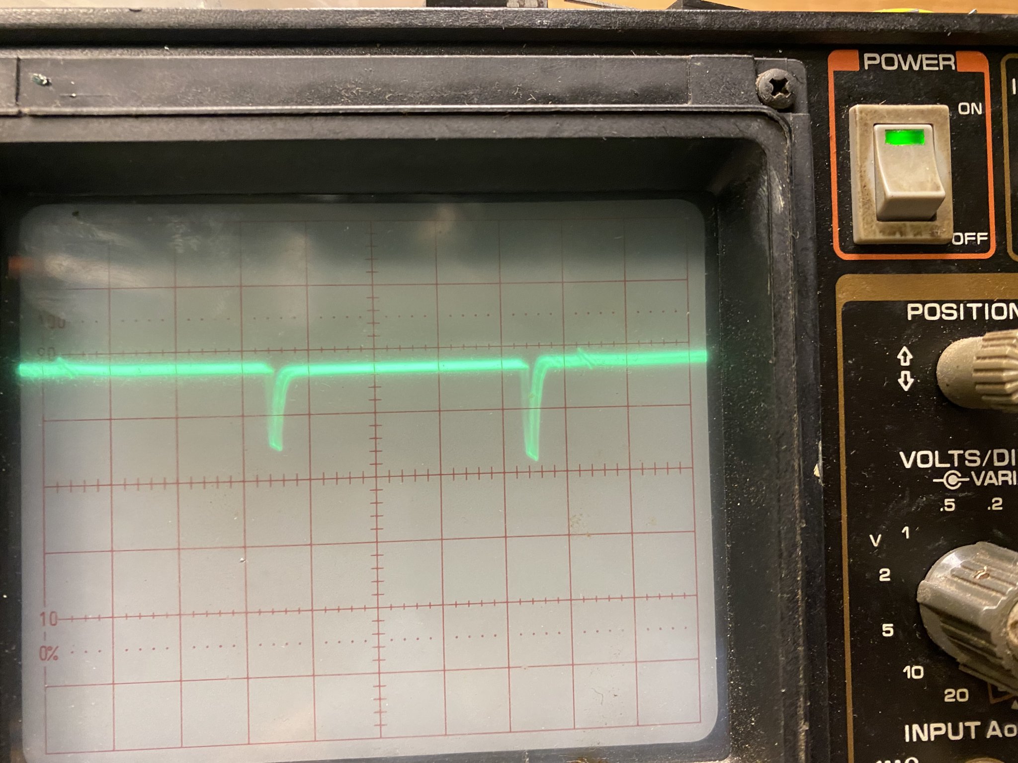

Pic 4 is of Q2007,2009
Q2006 has no drive signal
Scope set up to 2us 5volts/div

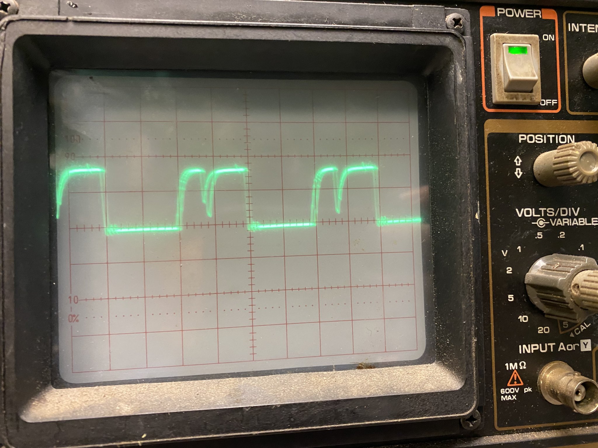

Rockford can have some strange drive signals but they generally look OK.

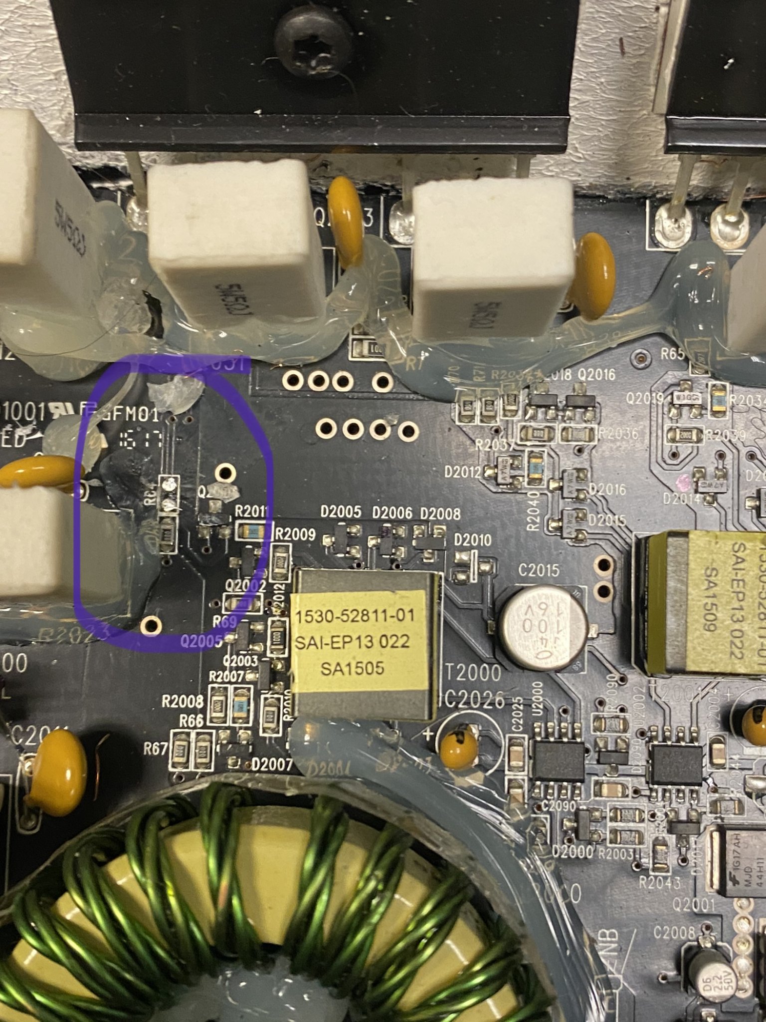

The problem is the loss of drive to Q2006.
Where is R64?
Where is R64?
Is R220 a 10k I removed the jumper amp the resistor fell off the board and can’t find it anywhere
