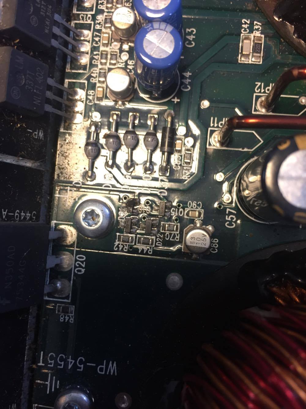

Thanks Perry, I get this image from the owner just for a quick inspection, I get the amp within a few days overhere. Serious power supply problem..
If you haven't repaired one of these amps, be aware that the screws in the board are used to complete the ground circuit through the bottom cover and have to be in place for the supply to function correctly.
