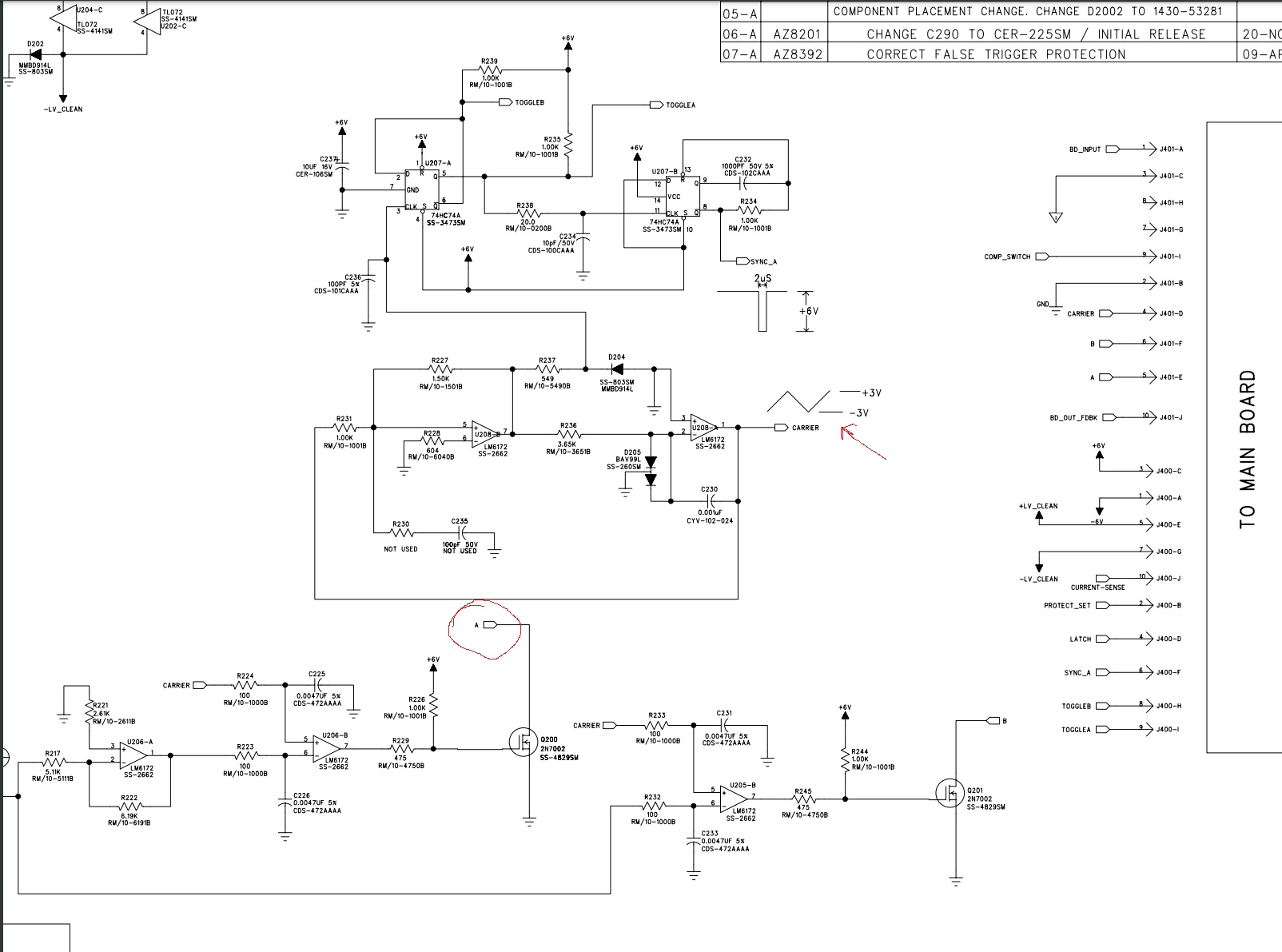

Then I mounted the board again back again, but then still dont se any sign of this trianglewave on pin 4(carrier).
Btw, What is the carrier signal ??
But the signal for A and B was ok, and Toggel A and Toggel B was also ok, with nice square wave.
Tried mount the fets back, but amp started to act up,

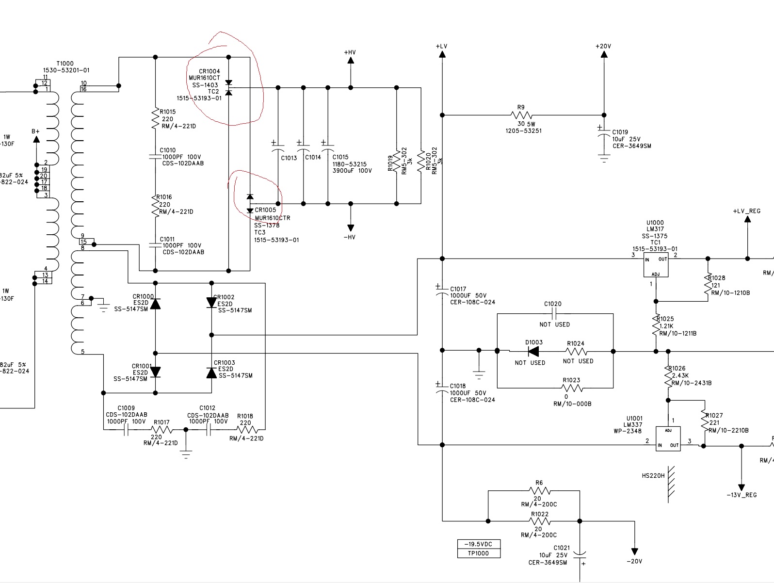

So i have these scematic but its simular , but on my version there are a bounch of transistors and diodes insteed of opamps.

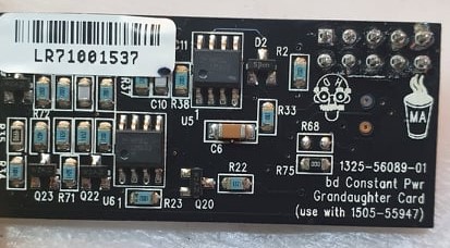

pin 4 the Carrier, seems to go to the daugher board.

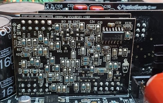

On the backside of the board I marked red dot and 3 yellow, is lm833, and
I replaced all 4.
but weired thing is that the yellows has + & -12volts as they should, but the red dot, have 12 volt on pin 8 and -6 volt on pin 4.
And I double check its fysical connected to -6 pin.
is it manuafactured misstake.. ?
Any one sitting with a scematic of 1325-55947-02,
Sent request to USA, but the said they did not have it.

Attach pictures this time 🙂
