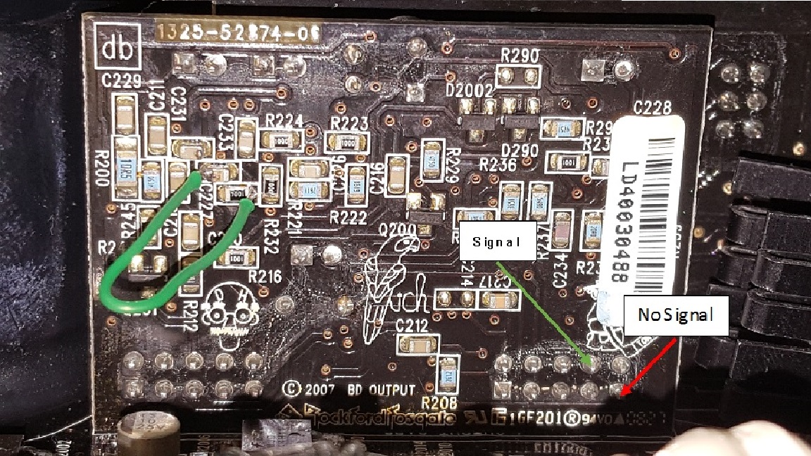

Looking at the back of the BD driver board, the two pins at the far left are signal and ground. Do you have signal being driven into the BD driver board?
Sorry for taking so long, had to run out. Yes, I have signal being driven into the BD Driver board - a clean, amplified sine wave of my input.

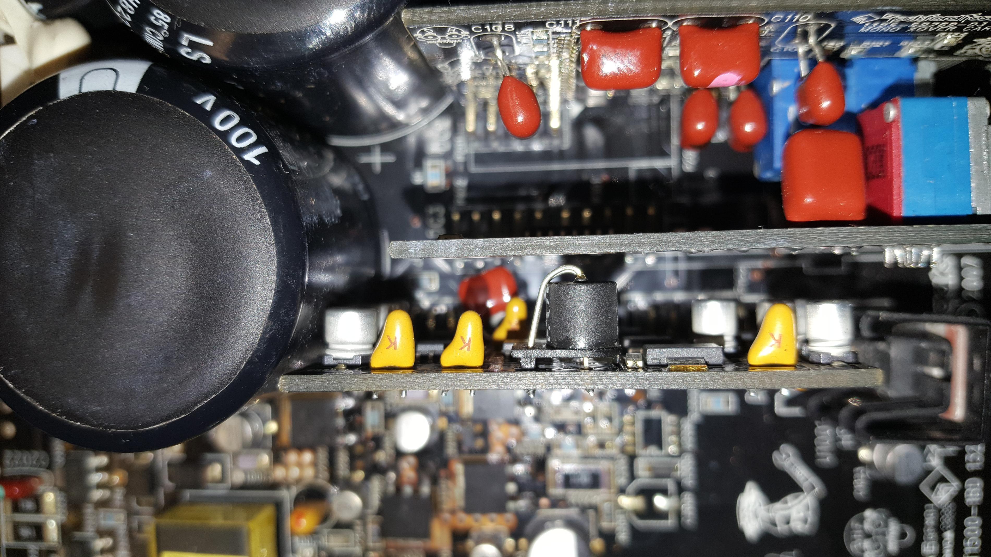

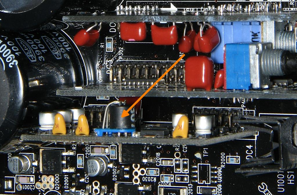

I think that there are 3 BD boards used in these amps. One has the device highlighted in the image below. One is a double-stacked board and one is a single board without the device highlighted in the image below. Which do you have?
