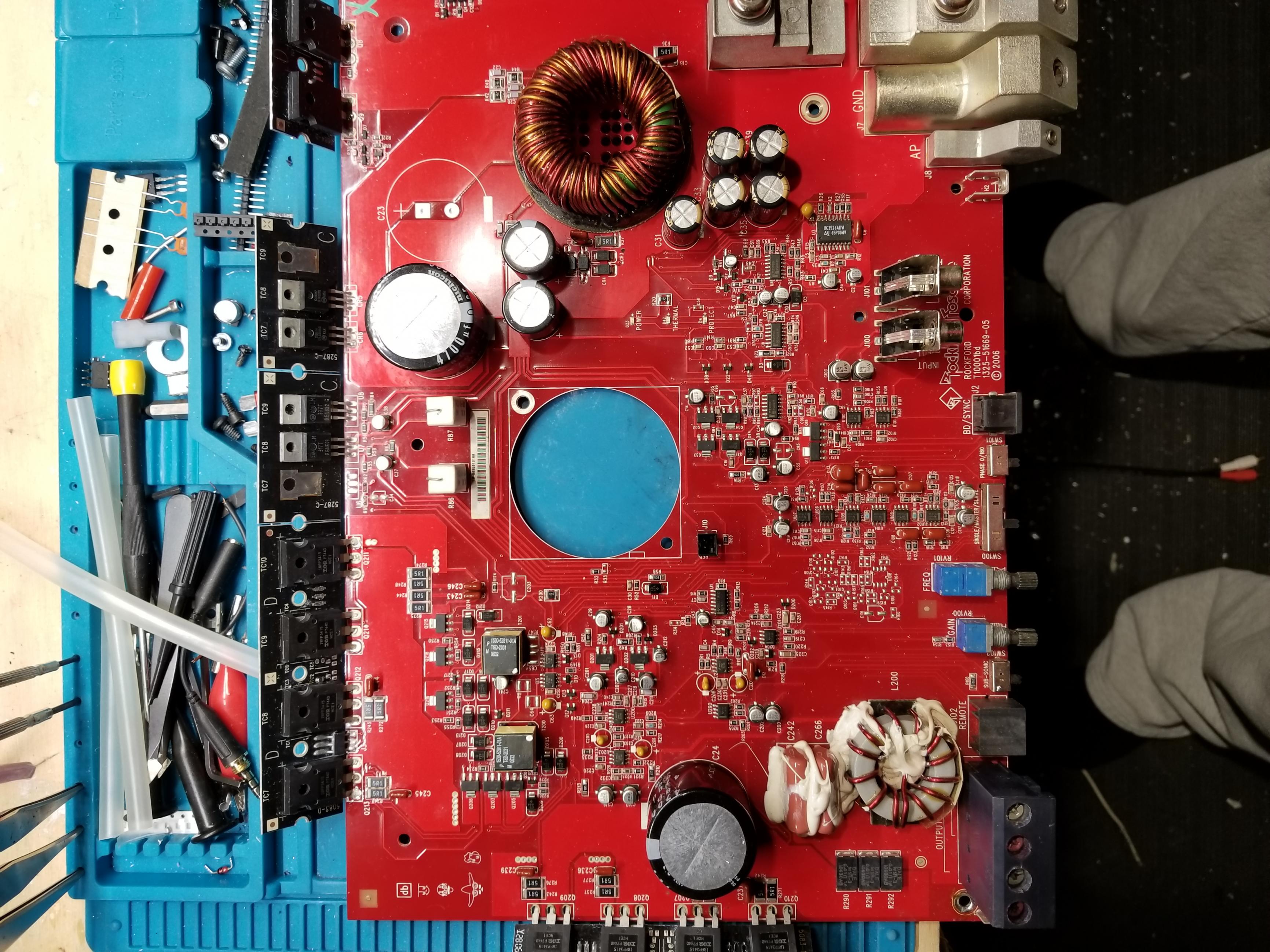

So I repaired a t10001bd and it had a fee shorted outputs. I replaced them all with matching irfp3415's power supply is intact. The amp remains in protection. I remember having this issue before on similar amplifiers. Some help would be most welcome.
There's a section dedicated to it on the repair_tutorial/miscellaneousstuff/rockford/punchbd1500/repairnotesrockfordbdamplifiers.htm page if you want to understand more about troubleshooting the problem.

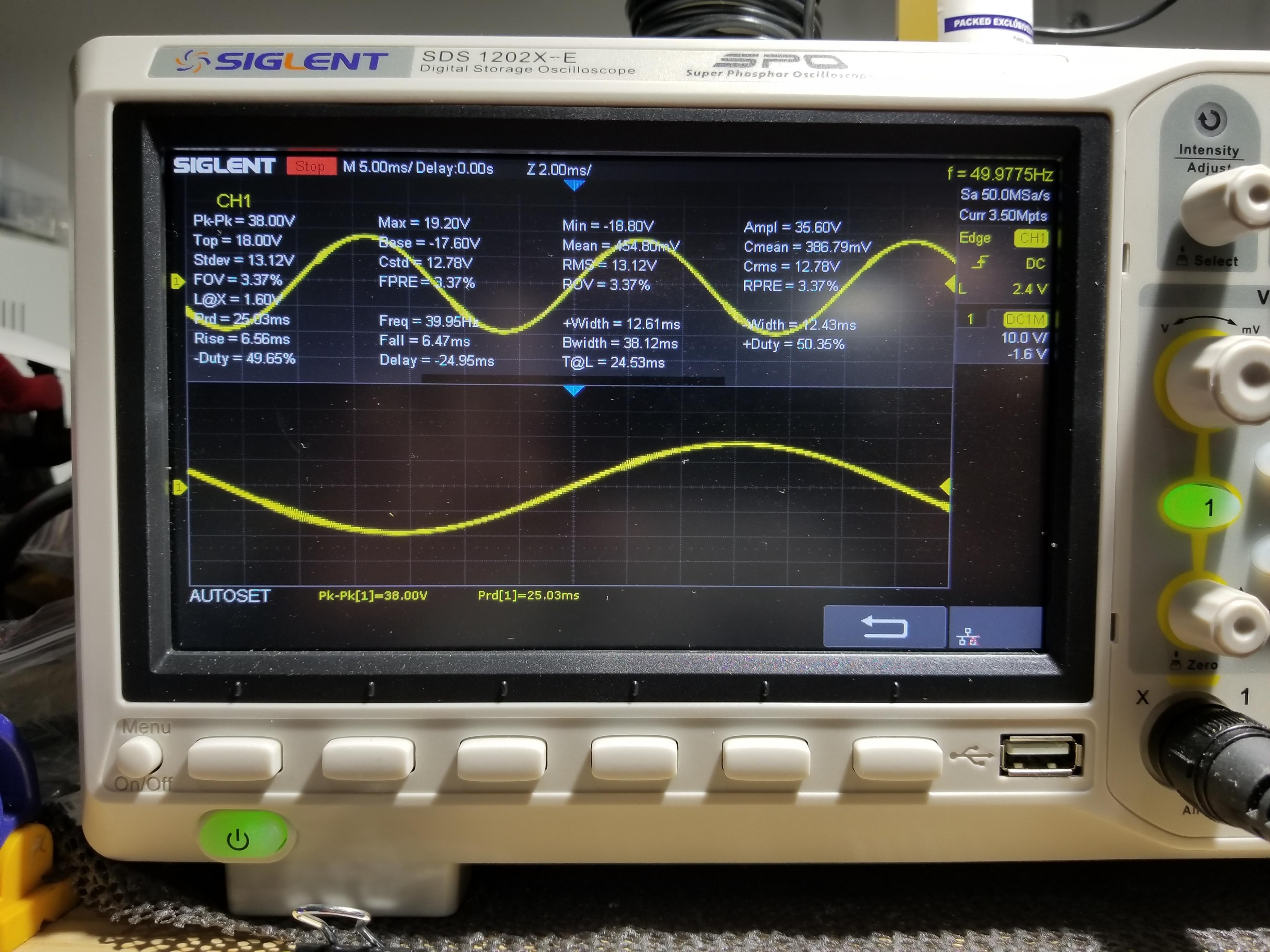

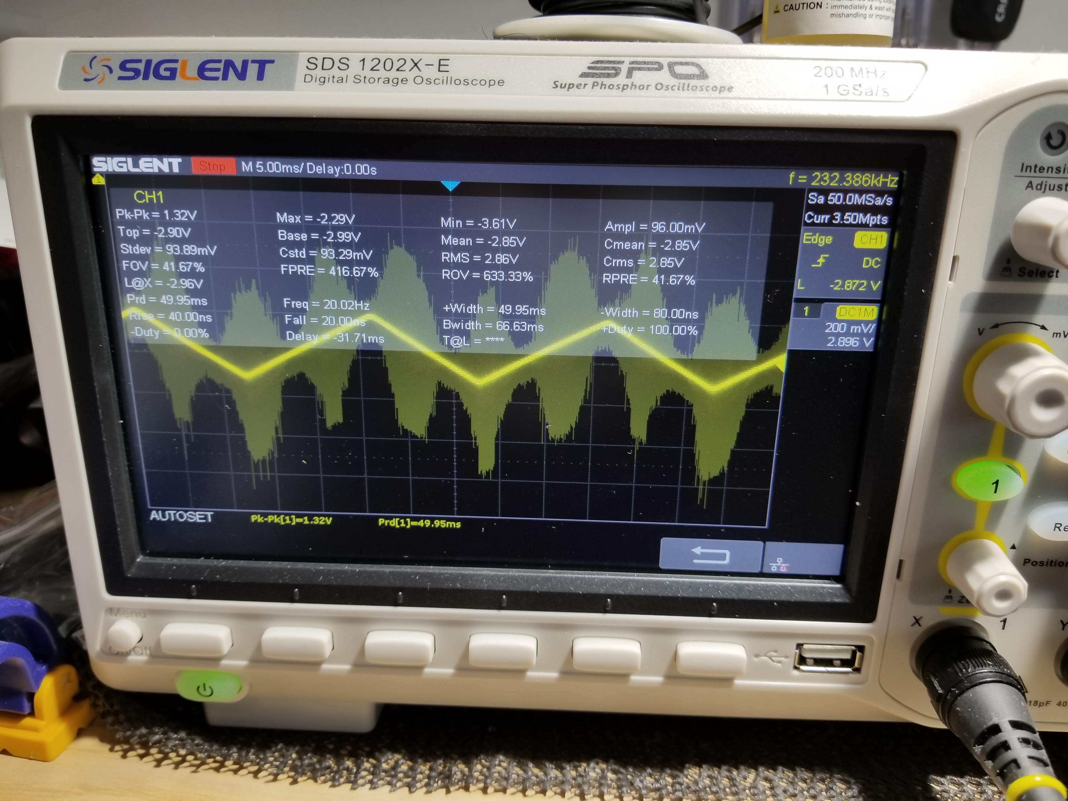

Do you have rail-rail oscillation on the output transistors?
It's normal for one of the protection LEDs to be lit dimly. I don't think it's in protect mode.
It out now drawing 2.1amps of current and oscillating. Before it wasn't oscillation or priducting audio it clear now.
While it's working, re-measure the voltage on all points you did previously. That way, if it stops working, you have a reference.
