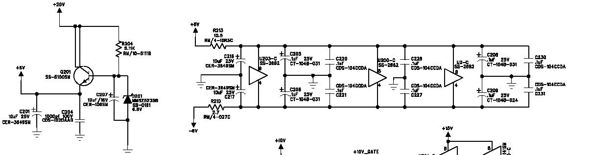

I have an issue with a 2006 RF T10001BD. It has the red PCB. I've looked through a couple of the other threads on here and some have similar issues, but I've checked for those things. The amp originally had a blown PS section. That has been fixed and appears to have no issue. I can get clean output from the amp, but only for about 1-2 minutes. After that, R50 burns up. Even with no signal in the amp, R50 burns up. This means that something on the +6V line is drawing excess current, even though the amp functions during this time.
Right now, when operational, R50 drops about 3V across it, which leads to a ~280mA current through that resistor. This makes it burn ~750mW in a 1206 250mW resistor. I can see why it only lasts a couple minutes 🙂 I know it will be asked about the voltages on Q201, so:
Base: 6.75V
Collector: 17.5V (Voltage on other side of R50 is 20.4V)
Emitter: 6.05V
All of that looks good. I tried pulling both R213 and R210. The drop across R50 dropped to about .6V (~60mA... 40mW), with obviously no output from the amp. Obvious suspect is one of the three opamps after R213. I reinstalled R213 and R210 and measured the drop across R213. That drop was 0.7V (67mA). What I don't get is why the current through R50 grows so much. Is there somewhere in the schematic that I am missing that the +6V goes to? Any thoughts or ideas?

Monitor the temperature of all of the op-amps and any other ICs being supplied from that regulator. Are any getting hotter than expected?
Capacitors can cause increasing current but that generally only happens when a capacitor is installed backwards. Check the capacitors on the output of that regulator as well to see if any are getting hot.
You can install a larger through-hole resistor in place of the SMD resistor to give you more time to find the fault. If you have a small 12v lamp (like an 1156), you can probably use that in place of the resistor as a current limiter like you would in the B+ supply.

In the 30 seconds to a minute I dared leave the amp on, the only thing that got scorching hot was R50. I will try the idea of putting a higher power through hole resistor in to mitigate the heat temporarily.
I removed C201 and tried it again with no change. When it was removed, I also measured C201, and it came in good at 10.6uF. When I had R213 removed, I also pulled C216 and it measured at 10.5uF. I did not try to run the amp with C216 removed and R213 installed, but I figured if it measured OK out of circuit, it should be OK in circuit. Do you know anything else that runs off the +6V? From what I see, it is U1, (Solid +6.1 at its VCC pin), U2, U200, U203, and a couple places where it is going through larger (1k+) resistors.
Does the voltage drop across/current through R213 seem reasonable or high? To me, 60mA going to 3 different opamps doesn't sound unreasonable depending on the opamp.

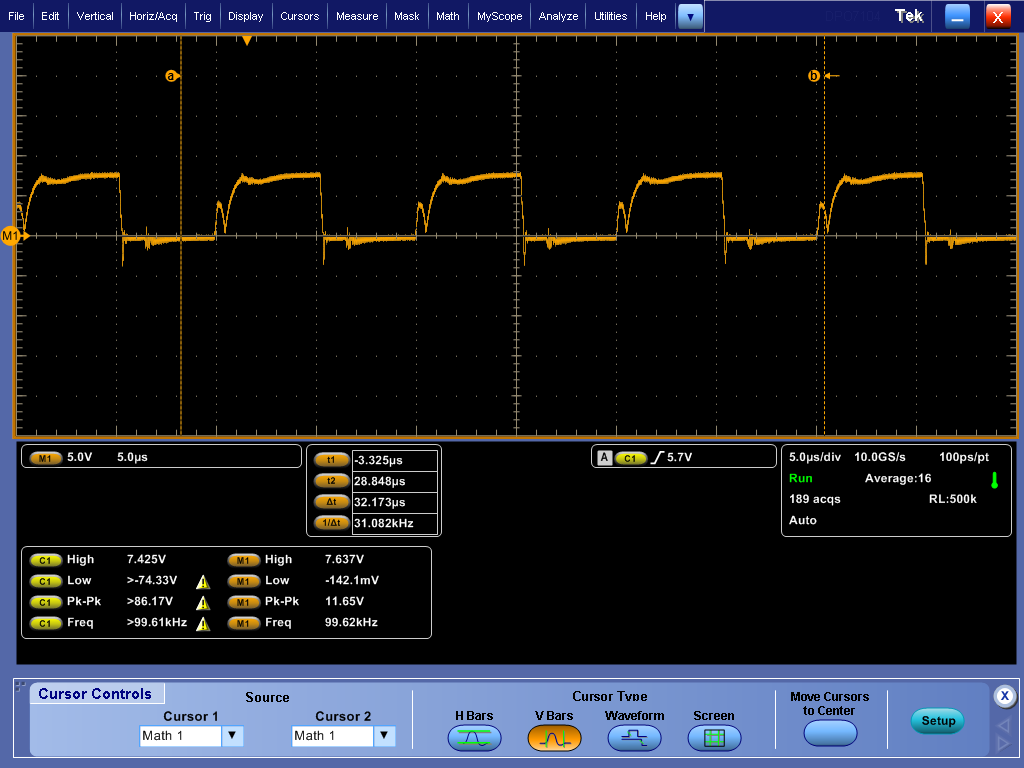

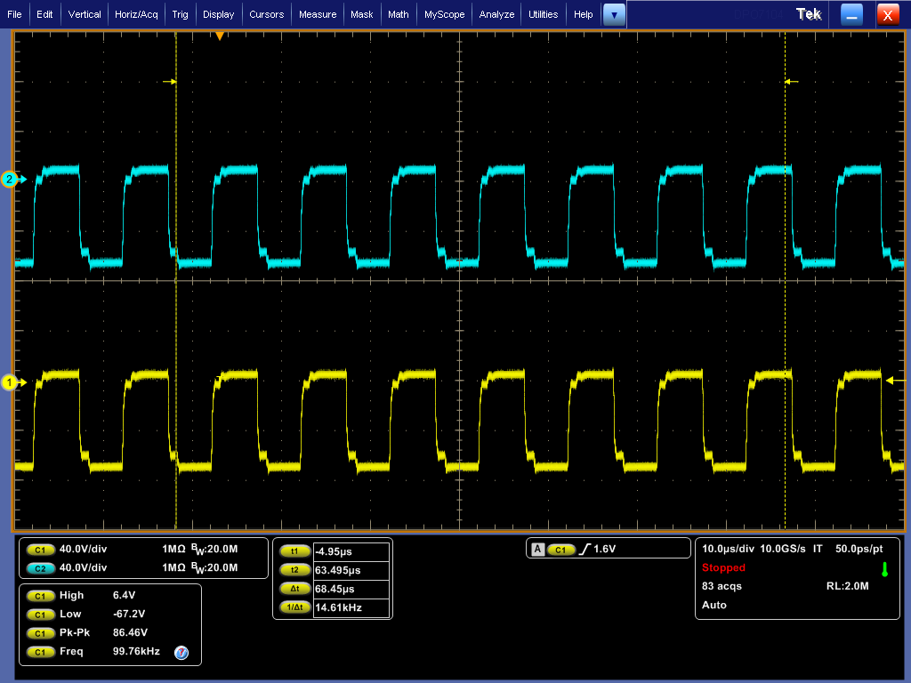

I assume you are talking about the output FET's? The third and fourth pictures I have up are connected directly to the base of the driver transistors Q203, Q206 and Q215, Q218 respectively. The first two pictures go to what looks like the driver's driver (Q204 and Q217) 🙂. If you do not have the schematic, I can send it to you.

The only definitive way to determine that there is a good drive signal is to measure directly across the transistor terminals. This has to be done using the scope in differential mode.

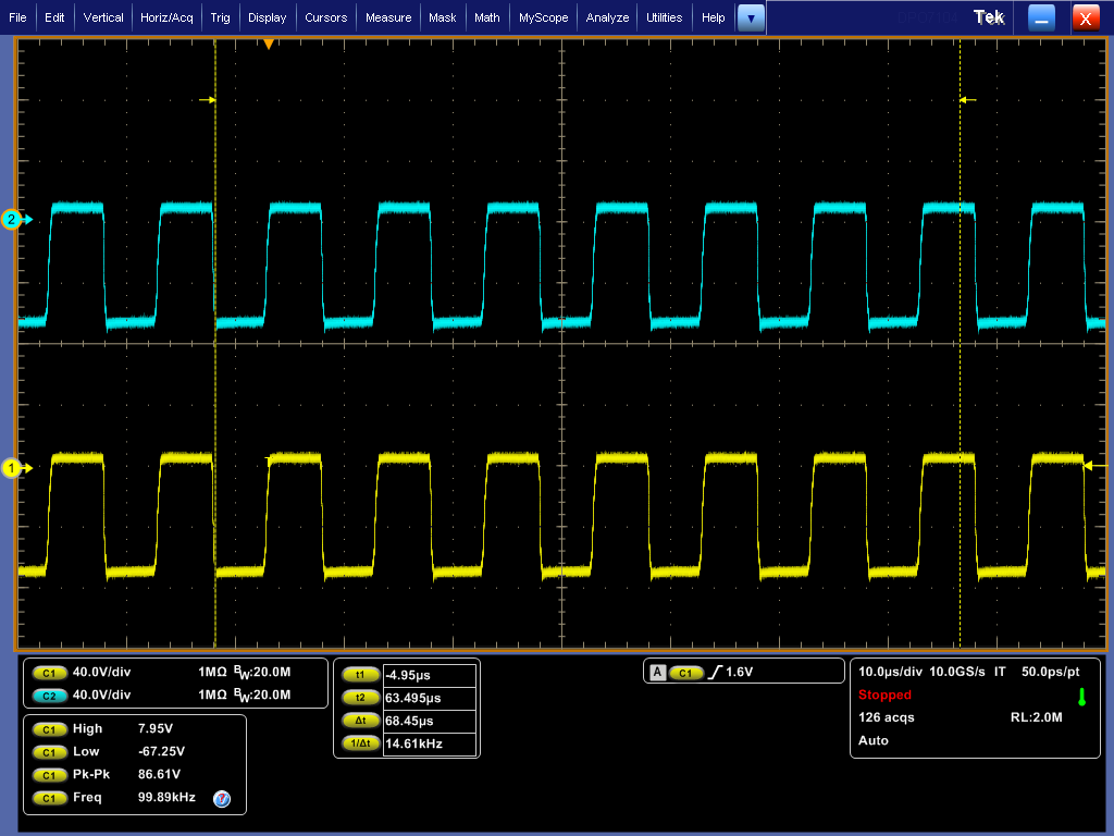

I took the plots for each transistor, then I forgot the flash drive in the scope 🙁 I will post them up later. They looked... so so. I know that isn't descriptive without pictures. For the heck of it, I ran an audio signal through the amp with no load and I got a clean sine wave out of the speaker outputs of up to 130V pk-pk before clipping. I had to keep a 5 ohm 1W resistor in place of R50, but it was stable for 20 minutes before i shut it off. With that resistor in place of R50, I had the same current draw through the resistor, but it was a stable current draw. I checked all of the component IC's to see if any were getting hot, but none seemed too bad. U2 was warm, but it wasn't running away. Most of the IC's on the output side of the board have been replaced anyway. So I am still at a loss for what is causing R50 to pull so much current through it.
I will post up the gate pictures later when I get back to the lab.

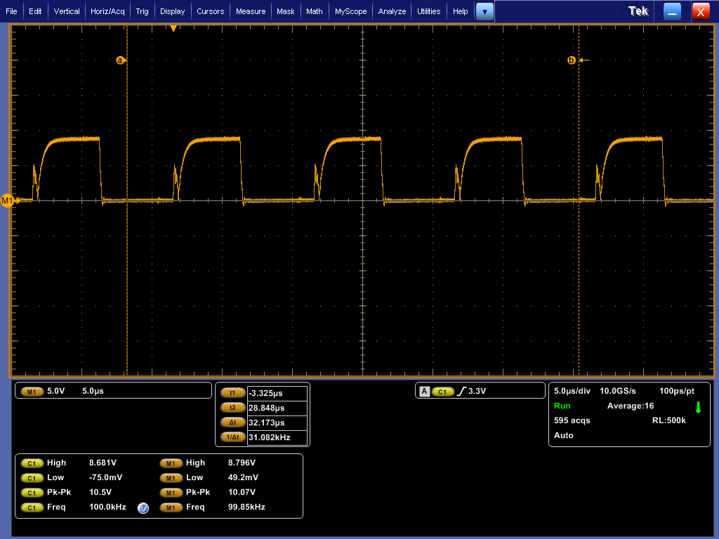

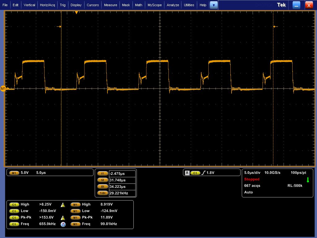

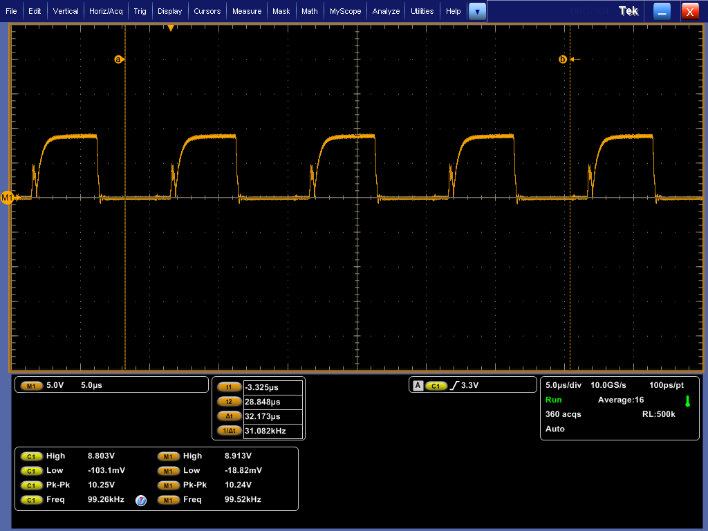

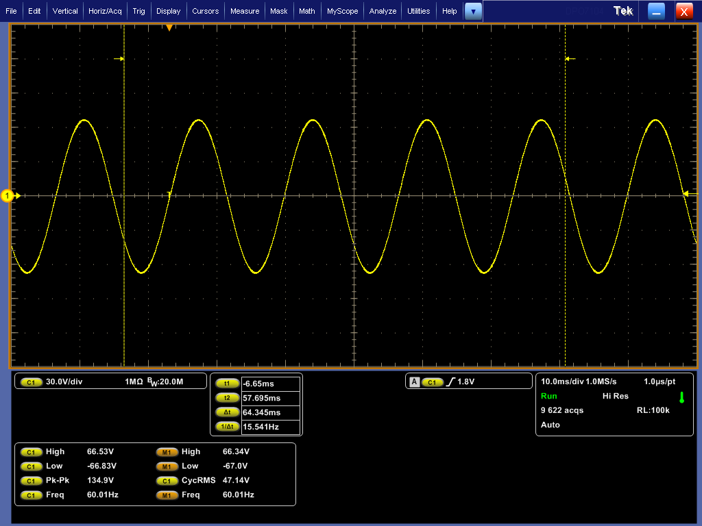

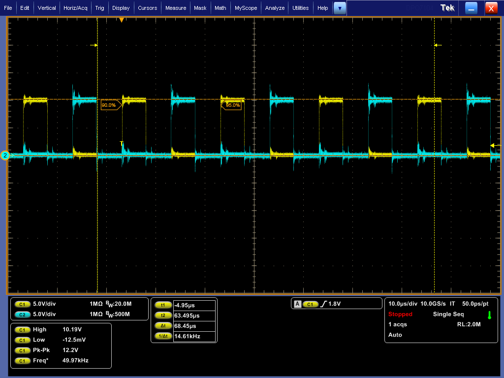

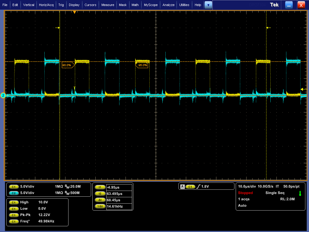

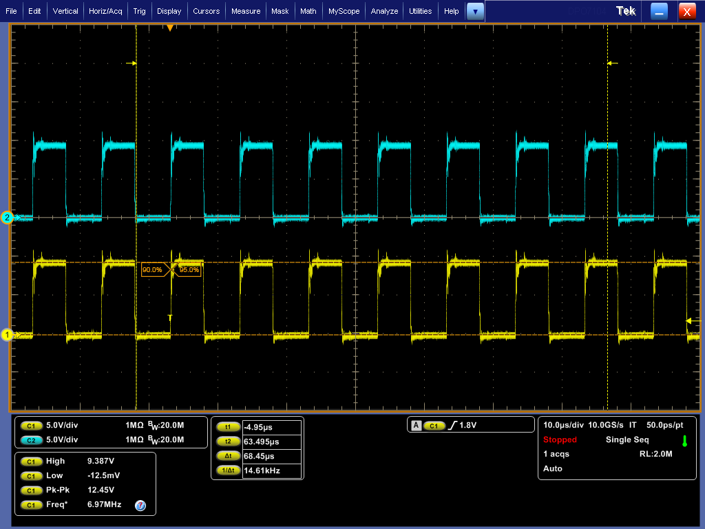

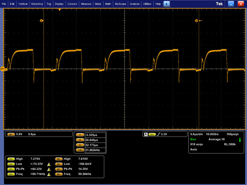

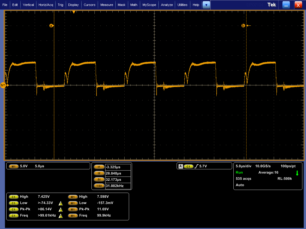

Here are the FET gate signals. The math function was used for channel 1 (gate) - channel 2 (source) to produce differential mode. The ground clips for each probe were connected to the negative terminal. The pictures start at Q207 and go up to Q214 in order. The last plot is the output of the amp at the speaker output at 60Hz with no load. This is with a larger power handling R50. No components powered after R50 seemed abnormally warm. Thoughts?
What model Tek are you using? It appears to be one of the $10k+ scopes.

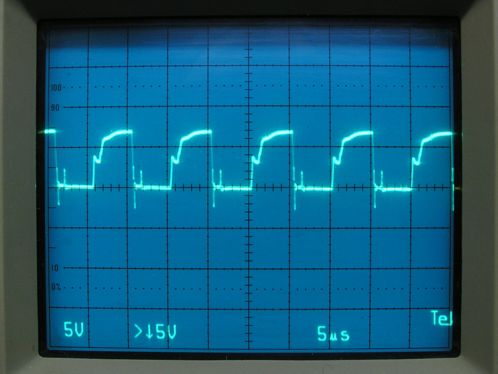

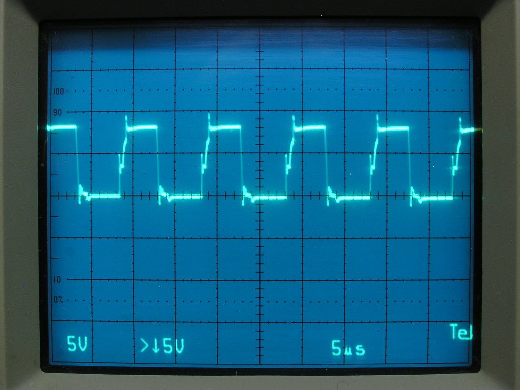

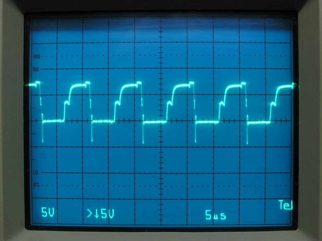

I took the following from another T1000-1bd. Although they are not identical, the corresponding signals are similar enough to make it appear that your amp is OK.
If you want to determine why R50 is overheating, you'll have to follow all circuits connected to it. If Q201 and Q202 are approximately the same temperature, the current must be flowing through another branch. The +14v_gate circuit or something that it feeds may be the next place to search. I think you already checked C29, if not, check it.

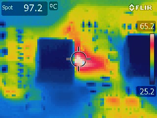

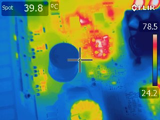

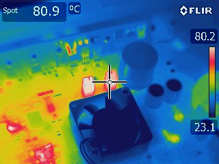

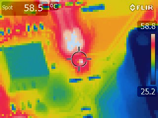

I did happen to find today that we have one other piece of equipment that more or less instantly solved at least a chunk of the puzzle. I used a FLIR thermal camera to finally try and pinpoint this once and for all. Lo and behold... C211 was a big bright red spot about 50 degrees higher than anything else. I pulled it, and the draw through R213 dropped to right about 0.3V (as referenced by you above). The draw through R50 is still too high (2.5V drop vs 3V before), but getting closer.
I also noticed that D211 was scorching hot (125 deg C!) under the FLIR. I don't have that part on hand, so it is on order now. Any thoughts if that would be causing the gate drivers to draw more current? The actual zener voltage seems not-completely-failed at 9V but I will replace it either way. There is some excess power dissipation in there somewhere. Hopefully it is just the D211 part itself and not something else.

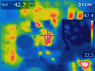

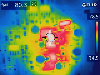

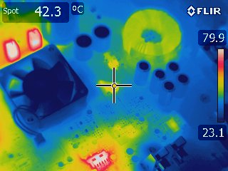

I got D211 replaced. It still runs hot, and I replaced C241 right next to it also. So I'm guessing that isn't an issue. Couple FLIR pictures for reference are attached below. Next step is to actually power a real load and see what happens. I need to go find a PS that will do over 10A though... I'm sure there is one around here somewhere 🙂
Only things that run hot are a couple resistors, the discrete regulators, and D211. These were all with no load or input. Current draw was about 3A @ 13.5VDC. That seems decent based on some other rockfords I've worked on.
It looks like Q17/18 are very hot. Does replacing the 0 ohm resistor R169 with a 4.7 ohm 2w resistor (or something close) help to keep R50, and Q17/18 cooler without affecting the output voltage of Q17/18?
