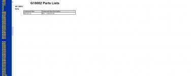

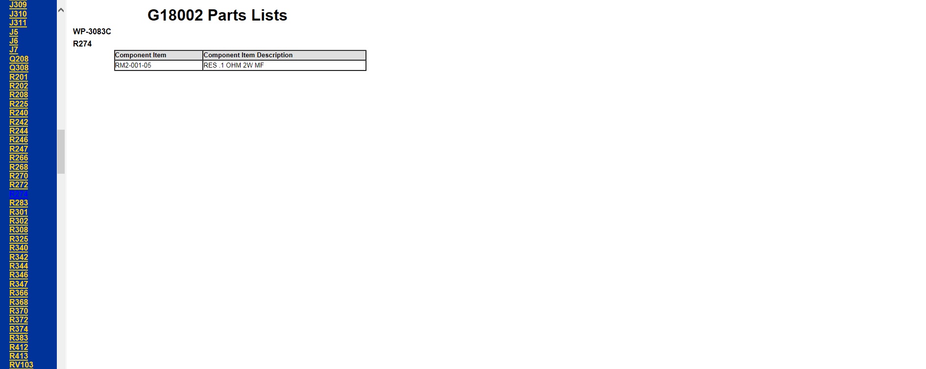

Hi I have a Rockford fosgate p8002 amp it's from 2004 / 5ish. Amplifier works through one channel the other puts out staticy sound I removed all 6 bad output transistors. Three of the source resistors had some discoloring on them. I'd like to know where to source these type of resistors? I have new output transistors ready to install just need those resistors.
I use the LVR03R1000FB12 from mouser. Mouser and DK should have something that looks similar if that's important to you.
The original MosFet S resistore is 0.1R NON Wirewound! this Wirewound resistors are like inductor to the MosFet output. anyway if you need some more help i'll do my best
