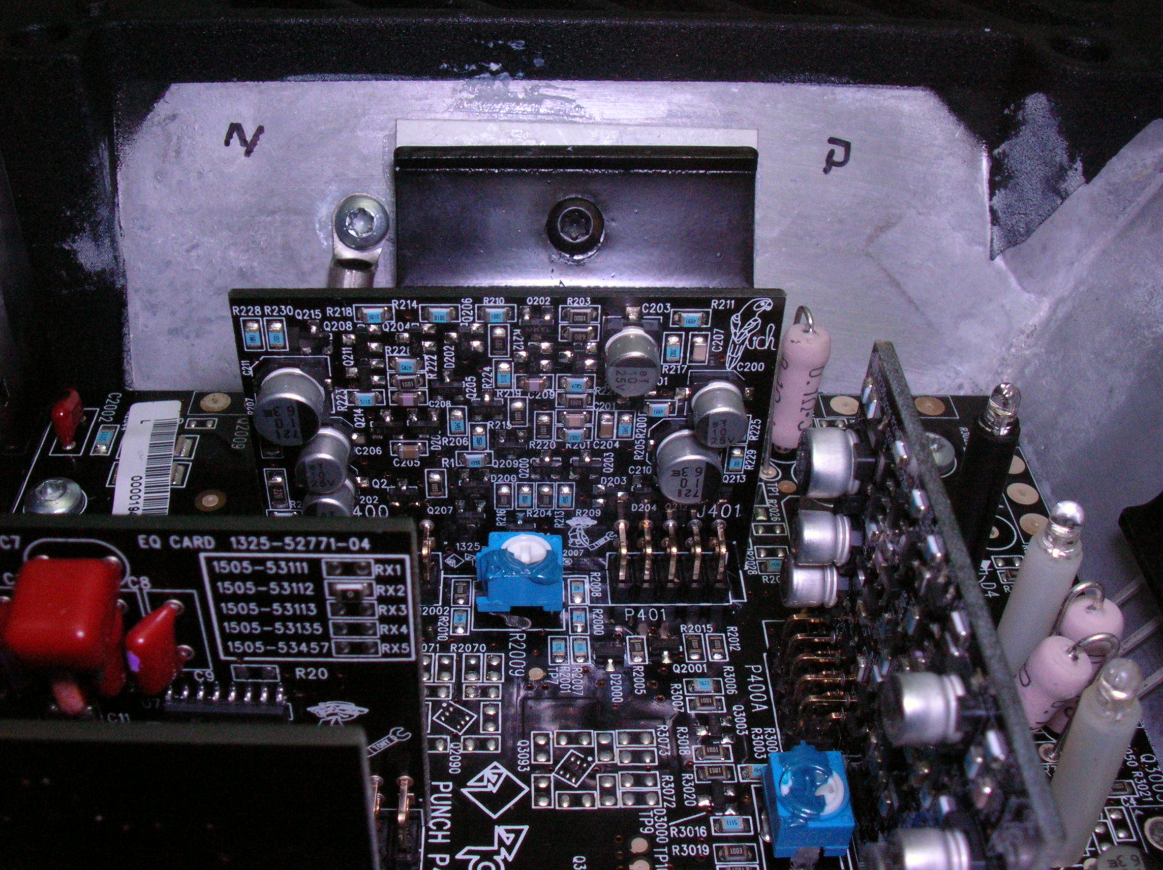

Okay, I got this amp , after waiting some time , , ,
Well, nothing else open , I noticed that someone has tried to repair it .... Mosfet output of the left channel , shows that have been removed , (marked on the chassis with permanent marker channel p and n channel ) and then re- install, also cards gain controls and switches have been extracted and then installed again ( you see photo 3)
I've done some measurements , and I have not found , any mosfet short or drivers , look good apparently (rail voltage is present in them, 31.40 volts)
When I logged in , I noticed the following:
Connected to input an audio signal and the output speaker produce a crackling noise and flashing in the left channel, more than the right channel (left channel 0,161 volts and 0,031 volts right channel ) .
The LM337 regulator becomes hot , and after 5 minutes , a blown 15 amp fuse that I had put on B + .
Any idea ?

Well, I connected the amplifier , this time with a 25 amp fuse , and has not been cast in the whole process of verification.
In a first place, then connected , without the driver board of the channel that was producing more noise .
I connected an extra tester in series with B + to measure consumption.
I connected a speaker to the audio output of the channel that produced less noise (right channel) , consumption remained , more or less stable , 0.65 to 0.66 amps ( this channel voltage is 0,014 volts )
When testing , this did not seem significant , and , secondly, I installed the card driver produced more noise ( left channel) .
I connected again, a speaker at this last channel , and consumption has started to increase gradually from 1.20 to 2.10 amps. (the voltage at the terminals of this channel is 0.160 volts)
When I connected the speaker in bridge mode between the two channels , consumption has risen to 3.20 amps.
Elapsed time, in all this has been about ten to fifteen minutes.
I have also implemented an audio signal at the input, without noticing any sound in the speaker , even with the maximum gain level .
All this is not very significant , right Perry?

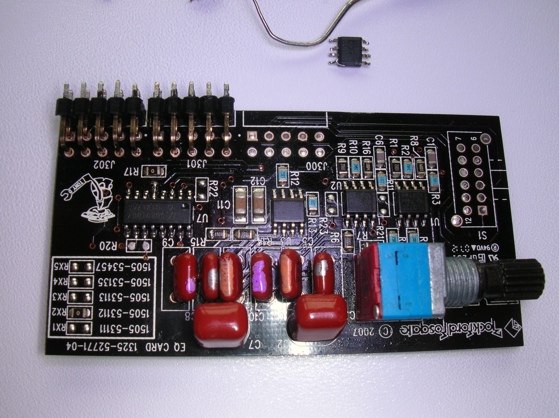

I have continued doing tests and have concluded that the failure could be on the cards: AB gain/2ch card crossover, and EQ card.
Therefore, I have extracted both from the motherboard, and I proceeded to the check of all its components.
Resistors and capacitors, look good, but U201, AB card, I have extracted, and compare your measurements with a new one, has given me high in some of its pins with respect to new, so I have proceeded to replace, U201, and U203, to suspect them ....
I have also seen on the card, EQ card, which seemed to have been tampered with before ... for example: pin 5 of U7, seems to have a bridge between him and a track circuit,,,
Is this correct, Perry? Do you have another card like this, to know if it's that made?

Yes, i checked all the components except...., some tantalum capacitors,...

Well, today, I'm happier ....🙂
I followed all parts checking the last few days, until today, I found R1015 (originally marked 49R9) that had a small black dot in the "R", and has made me suspicious .... as soon as I measured, I was, 0,985 K, when it should be 50 ohms!
I've substituted the nearest value that I had in my closet, (60 ohms, see photo)
The amp seems to work perfectly for some time.
My question is: do you think I can leave this resistor installed, or, should I install the original value?
The higher value resistor may decrease the supply voltage for the preamp ICs (op-amps) and may cause the resistor to operate at a slightly higher temperature.
If this is your amp, you can leave it as is. If it's for a paying customer or you intend to sell it, I'd recommend using the correct value.
Ok, Perry, I'll do so, look for the resistor to the original value, and I will set it up.
Yes, I have intention of selling.
Thank you very much for everything, everyone, and especially to Perry, is a genius, and never tire of commend.
