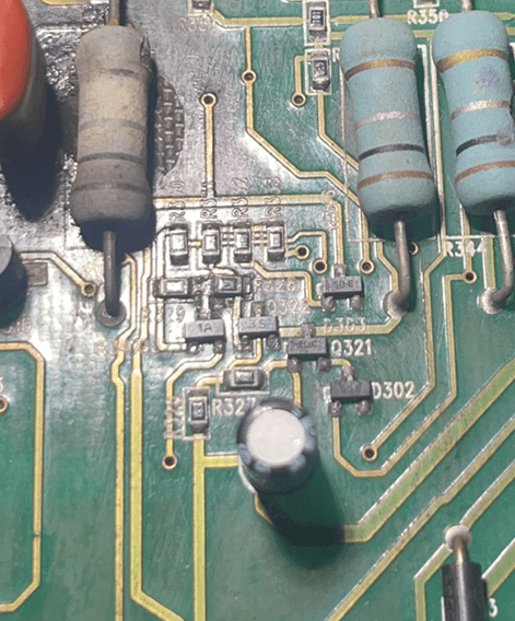

Looks like entire channel has blown, all output FETs bad, some even got so hot they lifted off the MESHA plate (another 1st for me🙂 all resistors on that side all wonky, both SMD and Throughhole types, 2 banks of BJTs look toasted, even a nice crater burned into board (but not all the way through, other side of board looks perfect actually) might need to rebuild some traces(another 1st), even the ceramic capacitor near output terminal has a hole blown through it ...needless to say a lot of firsts for me and excited to dig in on this amp.

After cleaning the soot, the damage will be apparent and likely not significant. You may have to use a leaded resistor to go in place of the badly burned resistors after digging out the carbonized material.

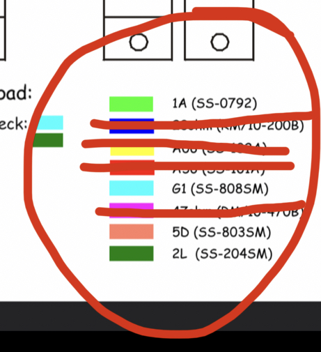

I need help identifying these parts listed so I can order replacements. I’ve tried searching for each listed in and out of parenthesis but to no avail. Any help would be much appreciated. “3S” is labeled G1 in the list
ty 🙏🏻
ty 🙏🏻

https://www.s-manuals.com/pdf/datasheet/k/s/kst5551_fairchild.pdf
