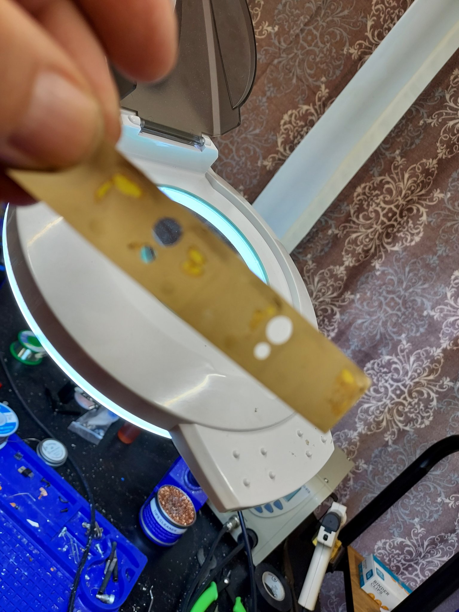

This is the old Sil-Pad material from this amp. I'm pretty sure that I don't want to reuse it. Some of the outer layer was stuck to the transistors. This heat sink is a cast material. Will ceramic or mica insulators work on this surface or Kapton tape or do I need to order some of this material?

Just now putting this one back in the heat sink. After doing more testing, I found that the problems with the static and uneven heating of the outputs were because of the .1ohm source resistors. They were way out of tolerance. Only 1 out of the 4 were even close. The first ones I ordered turned out to not be the flame-proof type so I had to reorder.
After installing the new resistors, re-adjusting bias and repairing the input terminals, everything is working great. I am going to use new mica insulators when I put it into the heat sink.
