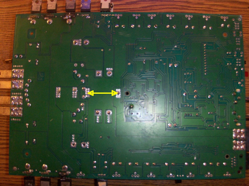

It appears that one leg of the transformer is connected to the + speaker terminal. It is a little different than the 250m2 which has 2 legs connected to the + speaker terminals.

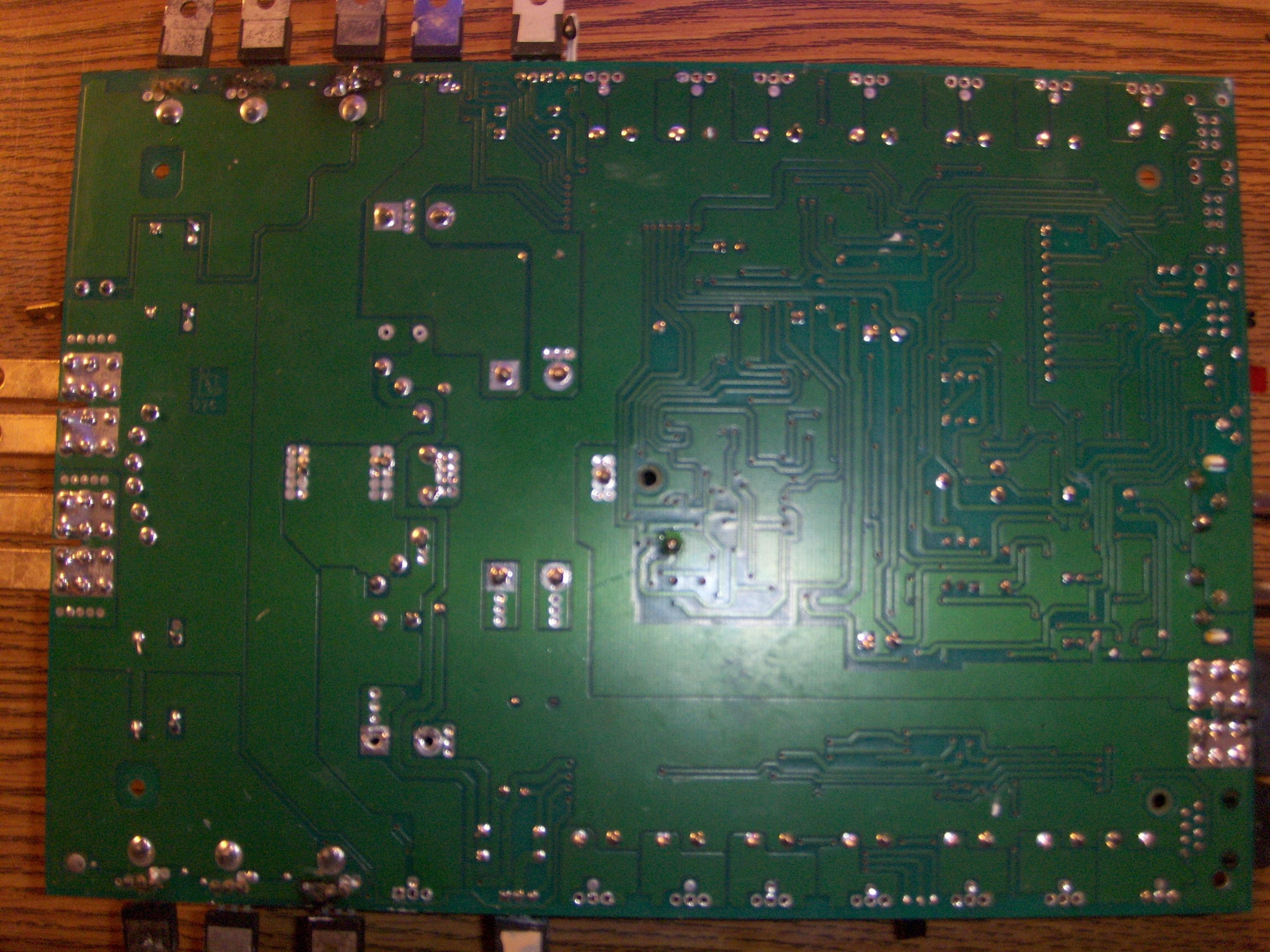

I attatched a photo so you could look at the bottom of the board, keep in mind this pic is of a parts board but its the same board.
If you measure the resistance from the positive speaker terminal to the secondary CT, do you read 0 ohms?

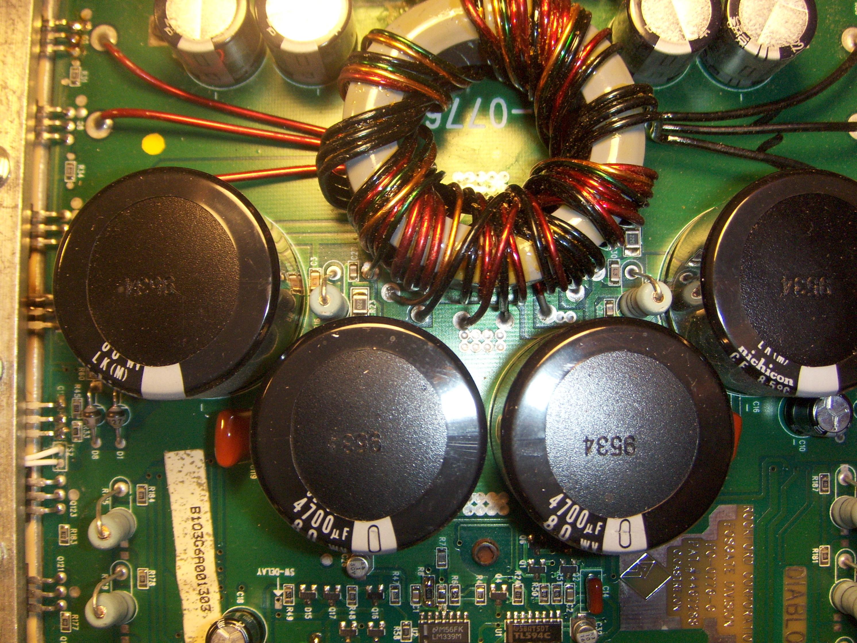

Please post a photo of the top of the board showing the secondary center tap and the area around it.
Do you read 0 ohms between the two points indicated by the arrow?
Are you using the inner terminal as the positive speaker terminal?
Yes I read 0 ohms now I was using the wrong pad on the board.
I read 0 ohms between the arrows in the pic and I read 0 ohms from the pads to the + speaker terminal.

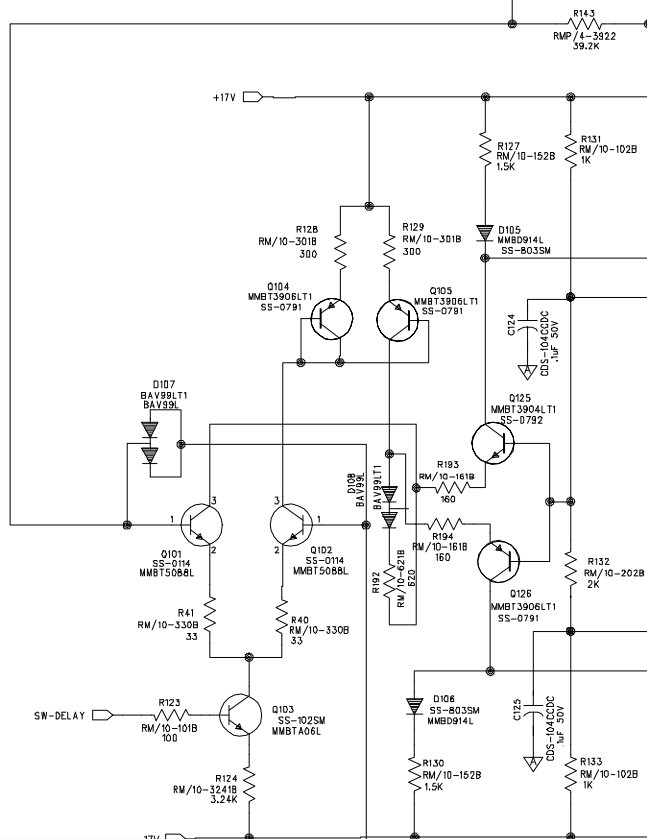

Q125 and Q126 were not leaky. Every resistor I tested was removed from the circuit and all tested within tolerance. Some reason my voltage has jumped up to over 3vdc now.
Q101
B: -1.624
C: +14.54
E: -1.620
Q102
B: -1.820
C: +23.99
E: -2.320
Q103
B: -3.878
C: -2.520
E: -4.47
B: -1.624
C: +14.54
E: -1.620
Q102
B: -1.820
C: +23.99
E: -2.320
Q103
B: -3.878
C: -2.520
E: -4.47
With the black probe on the negative speaker terminal. what is the DC voltage on the positive terminals of C108 and C110?
