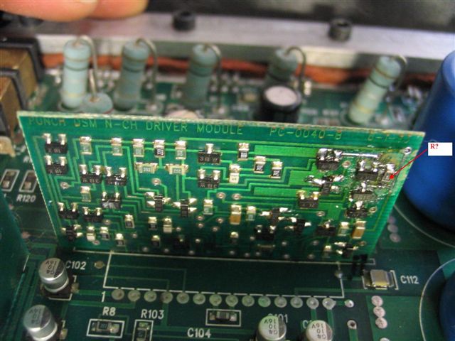

I am the owner of a RF Punch 200 DSM.
Unfortunately, RF Punch 200 DSM has a defect; on the driver module - Punch DSM N-Ch Driver Module PC-0040B 6-T-93(please see picture attached) - there is one burnt resistor (on both channels) and I can't identify it's value.
Can anyone tell me, please, which is that value and if it is a known reason which can lead to this?

is it one driver board per channel? I thought it was. In that case, you an read the resistor value off of the good channel. Be sure to test the surface mount transistors to make sure they survived the incident. I would also check the outputs to make sure they aren't hsorted gate-source or some other failure that would take out the driver module again after you fix it.

There is indeed a driver module for each channel, but the problem exists on both of them.
The transistors from the final module were checked and were ok.
The transistors from the driver module, measured with a multimeter, seemed to be ok.
There is a transistor; the SMD code is 8A (maybe a so-called digital
transistor, with resistors within, type MUN 2211 or a zenner diode 3V3, type MMBZ5226B). In the base of this transistor ( the pin no. 2 of the SOT23 capsule) you can find the resistor which is burnt. The other end of this resistor goes in the collector of a transistor with the code G1.

It's likely a 68K ohm.

The burned resistor on one of the pictures above is a 33ohm.

Thank You for your help, Perry Babin; the first picture seem to be identically with what I have.
Anyway, during this week I'll check and change the resistors, I'll be back with the result...
The 68k burnt resistors were replaced. Now the amplifier functions, but the following thing happens:
