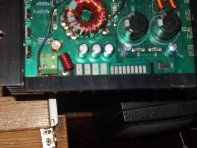

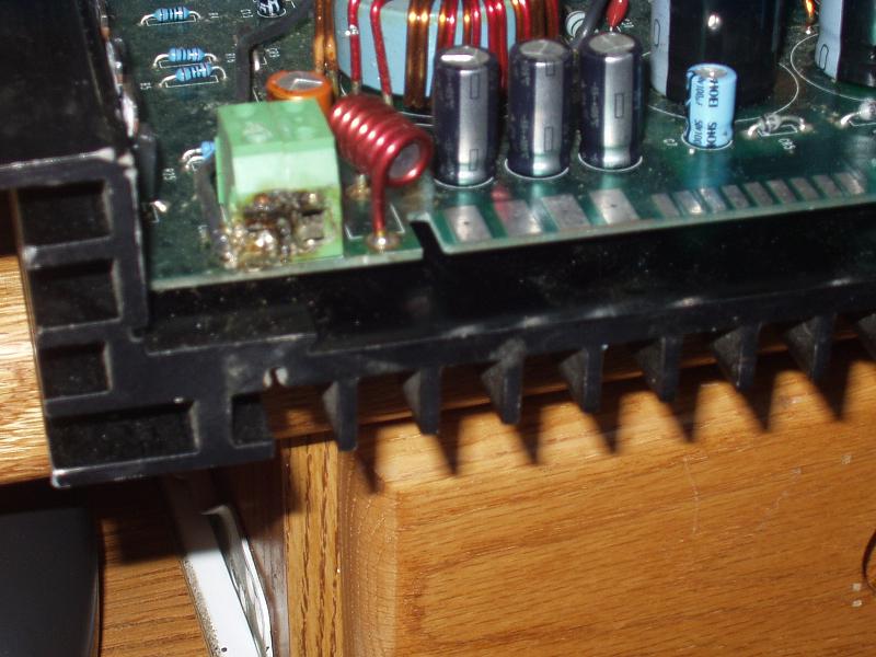

Buy or modify to fix A old Punch etc...
Hello:Mike.
You may check on Ebay or seaches looking for buy one. Or you can remove power block & solder power wires black 4 or 8 ga direct to main CBA .It alway work for old school Amp units in my shop. Then you do a same O/P PLUG for smal Ga wires.🙂

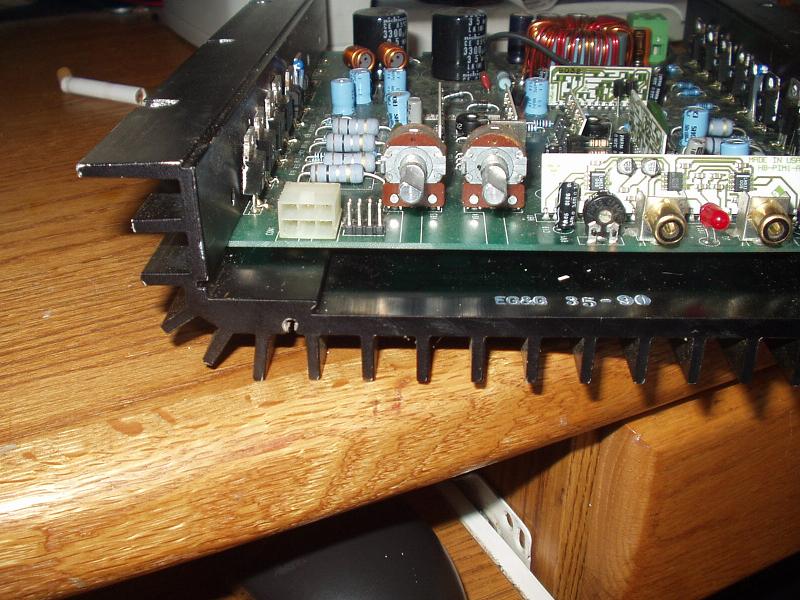

found this on the rockford site
Punch 150 (ser. 3) Speaker Harness (amp side) Molex 050-84-1060 Digikey WM1248-ND
Punch 150 (ser. 3) Pins for Speaker Harness (amp side) Molex 02-08-1004 Digikey WM1271-ND
Punch 150 (ser. 3) Speaker Harness (speaker side) Molex 050-84-2060 Digikey WM1249-ND
Punch 150 (ser. 3) Pins for Spekaer Harness (speaker side) Molex 02-08-2004 Digikey WM1270-ND

Punch 75 HD Speaker Harness Molex 39-01-2060 Digikey WM3702-ND
Punch 75 HD Pins for Speaker Harness Molex 39-00-0078 Digikey 39-00-0078-ND

It may be easier to just replace them with another style unless you are partial to those. There are several plugs that size available more commonly today.
